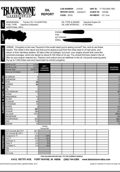

    I know what you mean. At work we send in oil samples to the Shell testing facilities those reports are written so cold and robotic.
    Depends on the dealer. Some will do it at 5k others make you wait till 10k.
    I wasn't risking getting turned down and
    did it myself at 4700.
    They charged me $28 back in late February. Who knows...
    To stay on topic here are my results.. similar to OP with the copper, iron and silicone levels through the roof. I also had mentioned that I found shavings in the filter housing but was assured that was normal.IMG_8722.PNG.jpg
