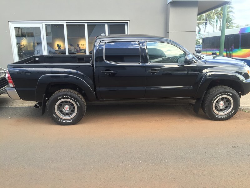

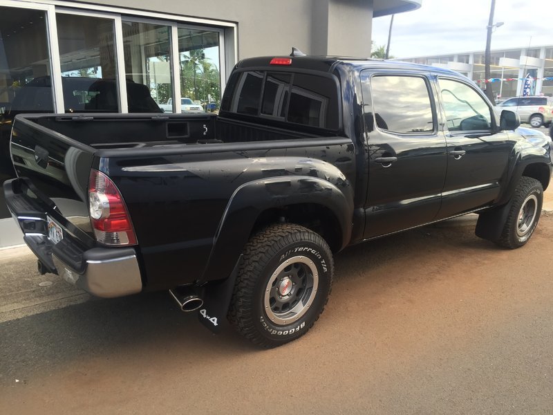

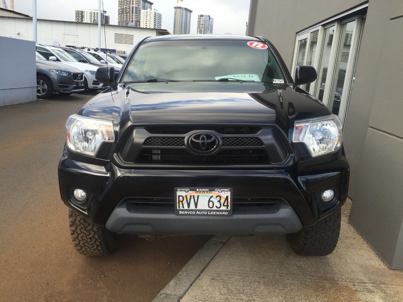

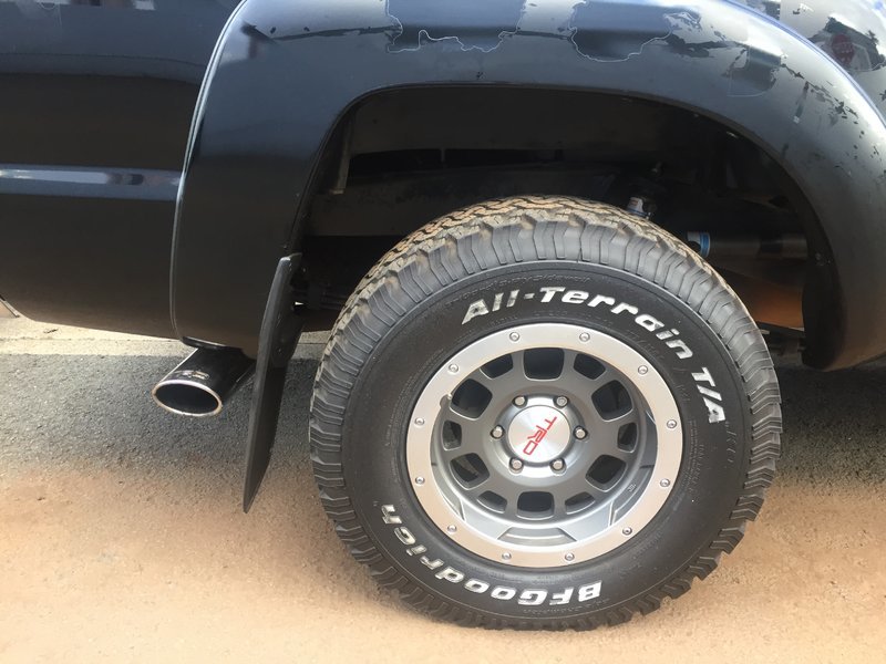

    The day I picked it up from the stealership. 2012 DCSB Tacoma TX Baja Series
    IMG_0984.jpg IMG_0988.jpg IMG_0990.jpg IMG_0991.jpg IMG_0996.jpg IMG_0994.jpg

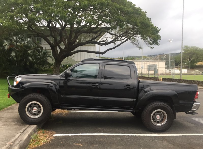

    What the Baja looked like back in March 28, 2017:
    :rofl:

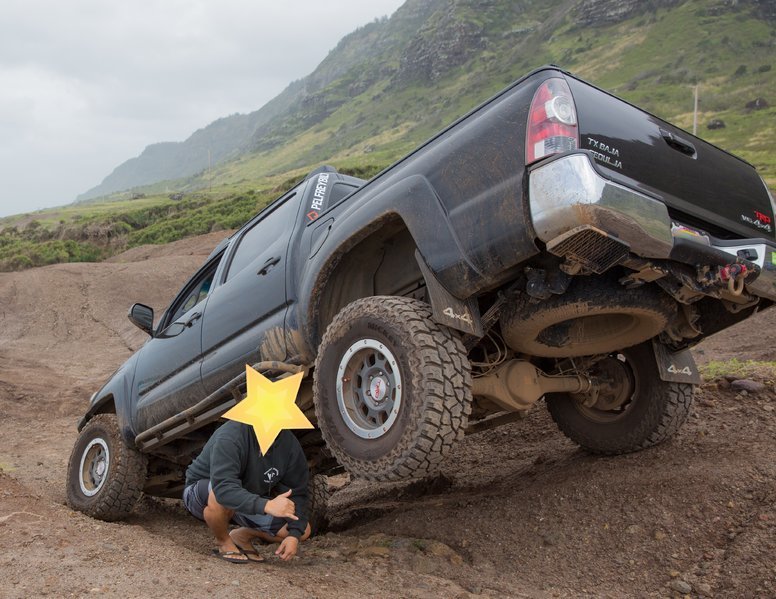

    Some action:
