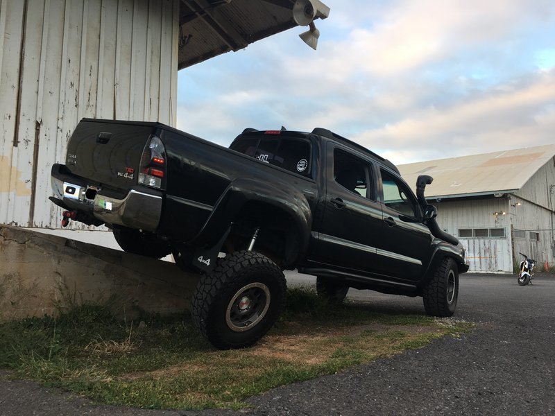

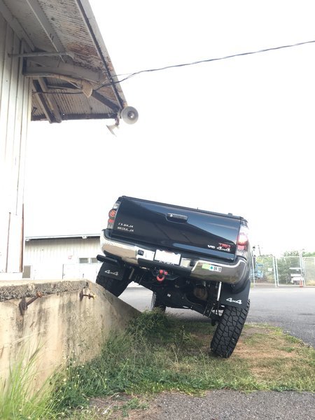

    Impressive...:thumbsup:. I haven't done that yet. Reason being is my shocks fully extended are only 26". My droop is more than that with the shackle flip at around 30" and I don't want to overextend my shocks. Just make sure you're good on length;)

    Good looking out, Rick! Yeah, my rears are the Icon 56503R-EXT VS Series Remote Reservoir Rear Shock set for 2.5"-3.5" Lift.
    According to the specs, they measure 15.9" collapsed and 26.8" extended; so if the shackle flip gives 30" of droop, my limiting factor has got to be the shocks. :eek:
    Will definitely need to be careful to avoid fast drops/dips. :oops:
    No jumps for this Baja! :rofl:

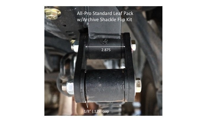

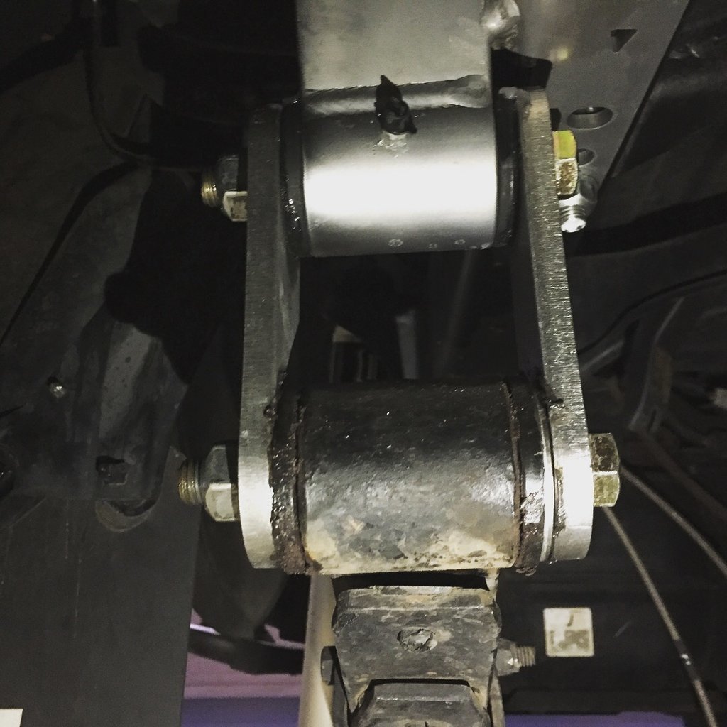

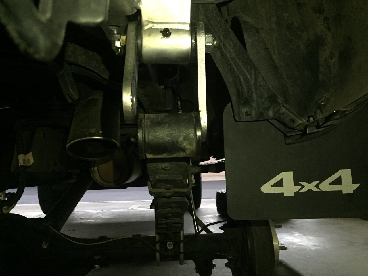

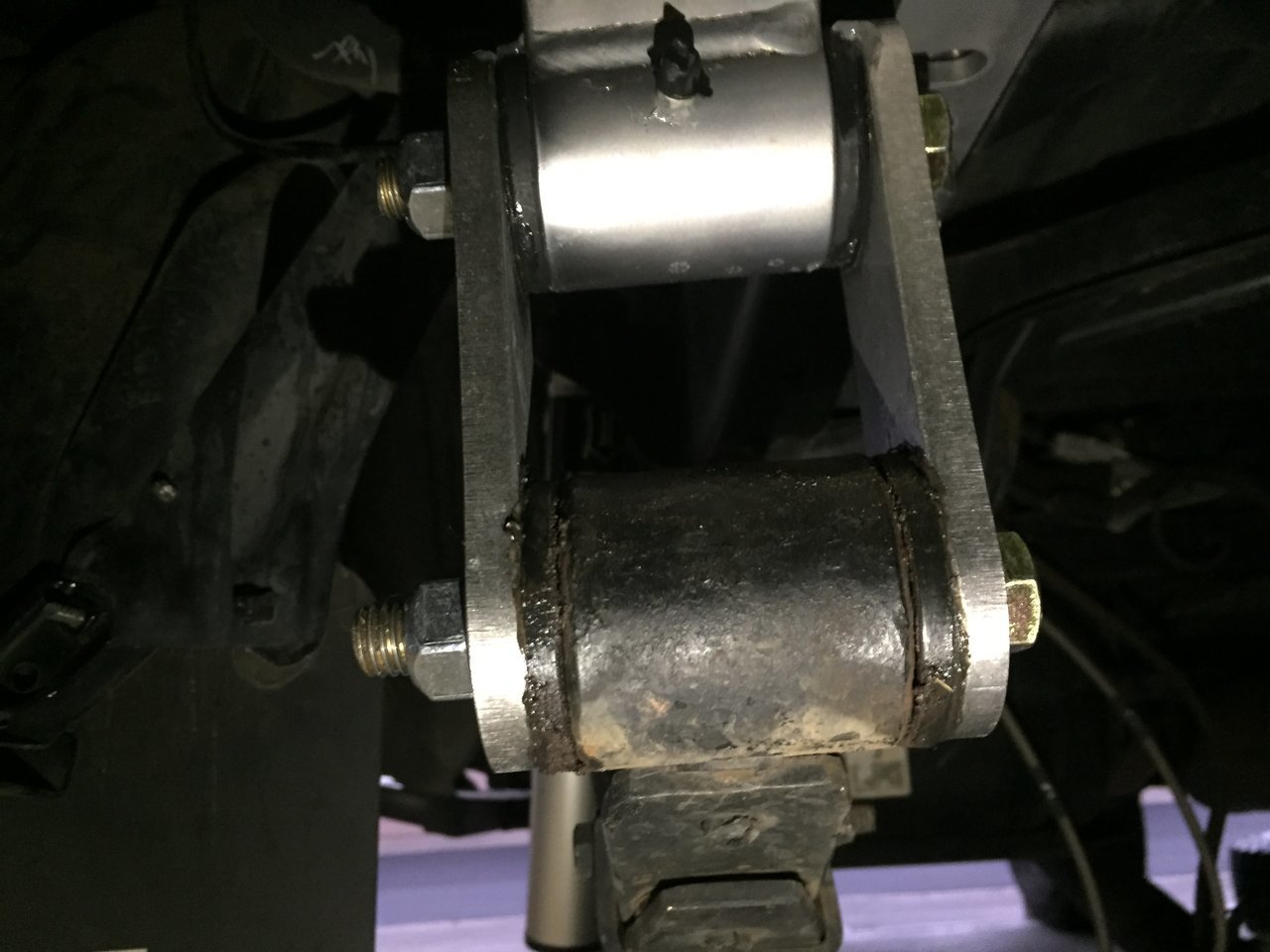

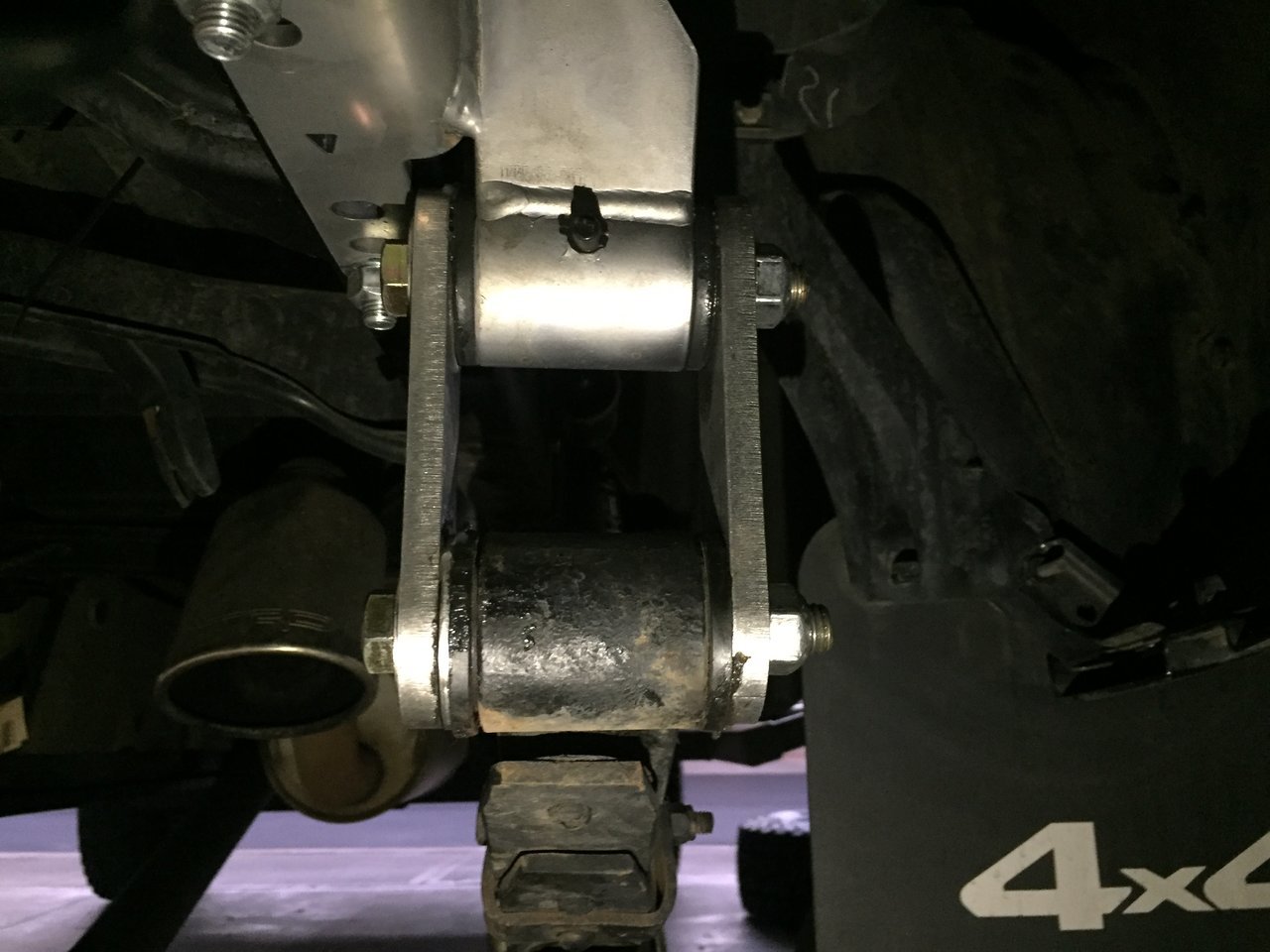

    AllPro Standard leaf packs needed a spacer on each side.
    Before
    Notice the longer thread of the bottom bolt...
    After

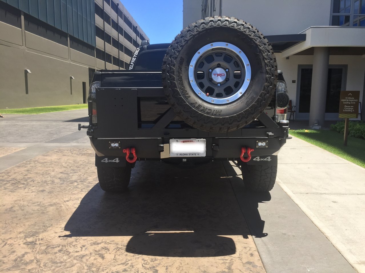

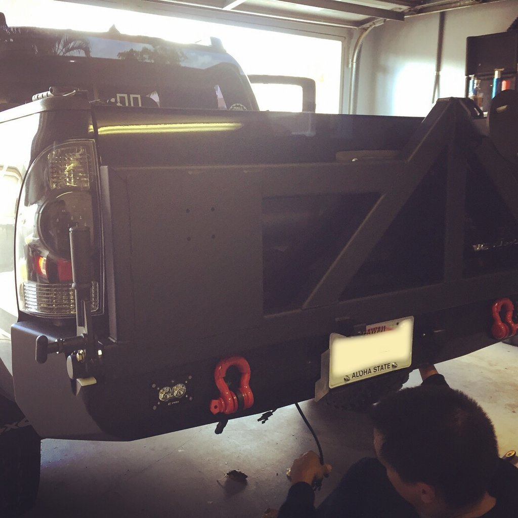

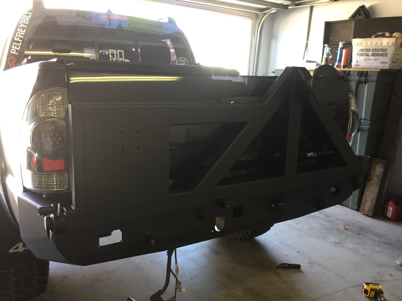

    Oh, and here's the before, during, and after for the Pelfreybilt Standard Rear Bumper with swingout gate. I added the camera relocation mounts and the hi-lift mounts.
    And here's the before
    During
    After
    I centered the camera more, but my wiring was a bit short...so, I may look into extending it some day later. For now, it does it's job. Good thing my Kenwood head unit provides lines to help me gauge the distance when I back-up. And I kind of wish Pelfreybilt provided their optimal location for the camera mount, but...oh well. I ended up busting one of my self-tapping screws, but the first one is solid and it's not going anywhere.

    Did u have to apply a spacer for the front of the leaf spring mounts too? I did the same thing but i still hear a popping sound still. Havent really inspected it yet.

    all things mall rated
    Spacers were only added to the front. Archive Garage squared me away with quick and quality service.
    No popping noise(s) for me. Maybe torque down the nuts a bit more? I dunno.
