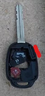

    Good stuff.
    Just to level set, this is the transponder chip (RFID type) in the slot of the H keys. It isn't electrically connected or bonded. Just near field stuff.
    In the @MESO FlipFob, it is a bit further away.
