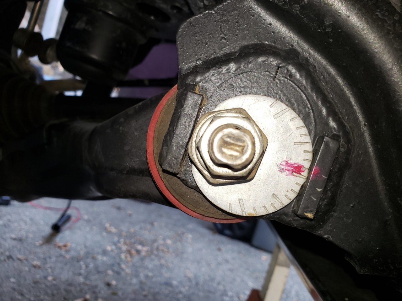

    When the alignment cams get loose, they make a huge terrible popping noise when reversing in a turn. Sounds like something breaking but it's not. Commonly happens weeks or months after an alignment because most shops don't adequately torque the alignment bolts. I believe it's 100 ft lbs or more, I will check and edit in the correct value here. (Edit: yes, 100 ft lbs)
    Check everything else of course, but if nothing is obviously broken, I would suspect loose LCA bolts. Has happened to me a few times.
    However, the amount of steering error from this would be small. Like, 12:30 to hold straight vs. 12. And you wouldn't feel the wheel "shift" as you turn it... maybe it would drive a bit sloppier but the wheel wouldn't feel loose.
    So you should make sure there isn't a bigger problem as others have suggested: broken tie rods, rack bolts, or intermediate shaft. Have someone turn the wheel side to side while you watch from below or either side to look for motion. Maybe you skipped a tooth on the rack, although I've never heard of that happening, in that case the steering wheel will jump without turning the wheels. These are all dangerous problems and could also break your clockspring if not quickly and properly repaired.
    But if loose alignment bolts are the only problem, then get a new alignment and torque the alignment bolts yourself with a torque wrench immediately afterwards. This is the only way to do it right I'm afraid, otherwise there's a chance they'll come lose within weeks.

    I also suspect loose alignment cams. Do yourself a favor and once you get it aligned again, get a silver sharpie and mark each of the alignment cams and onto the frame where they should line up. That way if they come loose in the future you can adjust them and tighten the cams back up

    Yep, in case it helps here's what those look like. I used red paint instead of silver though...
    Oh and it is indeed 100 ft lbs torque spec on these. My notes say you need a 19 and 25mm socket for this. You will have to pay attention to the eccentric assembly design to make sure you're tightening the bolt, not turning the cams.

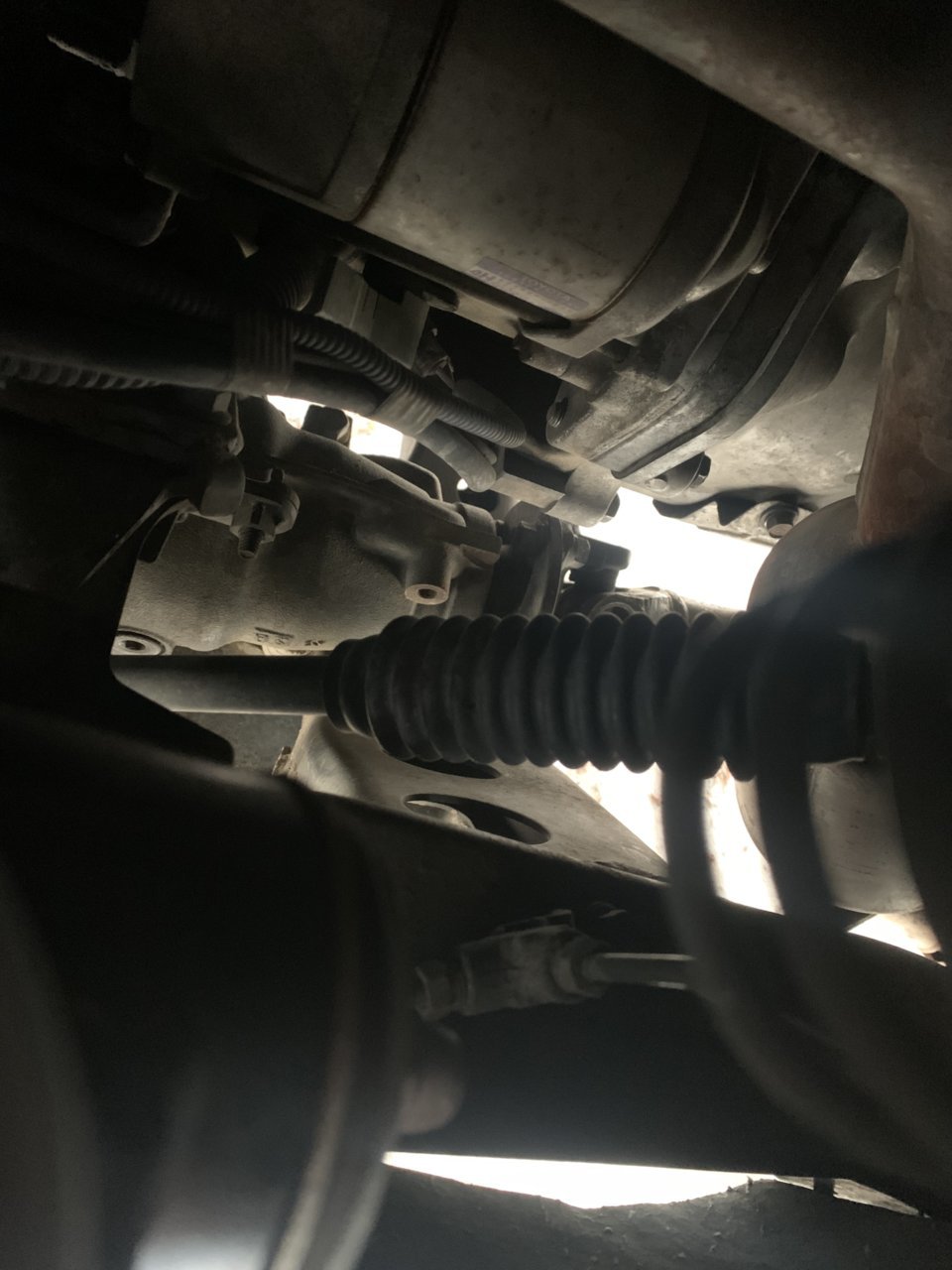

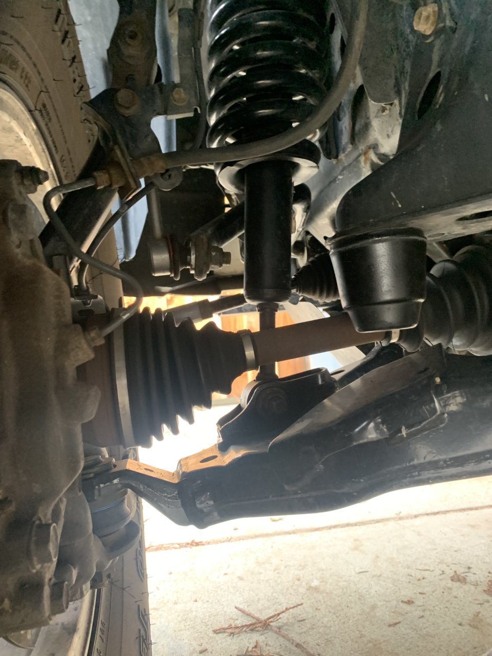

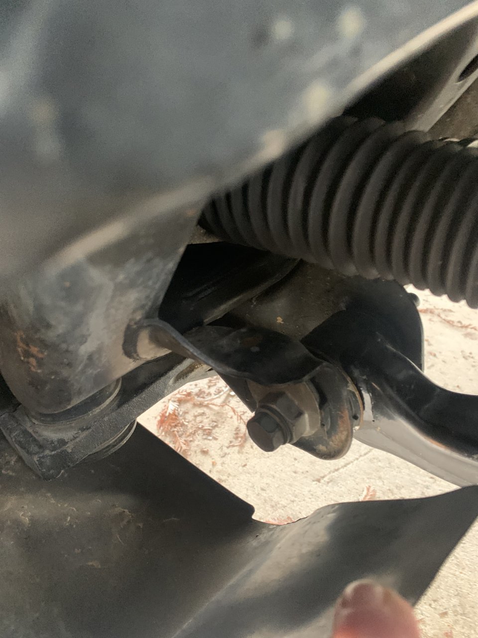

    1. Post photos of your rack, tie rods, spindles, CVs, and anything else potentially noteworthy related to this issue. You can post dozens of photos if you want, but you should definitely post more than zero photos. Use the "Upload a File" button below to post photos. Perhaps there are already photos on the phone you are holding in your hand. If no such photos exist, use your feet to walk out to your truck first, then use your phone to take the photos. Then use the Upload File button.

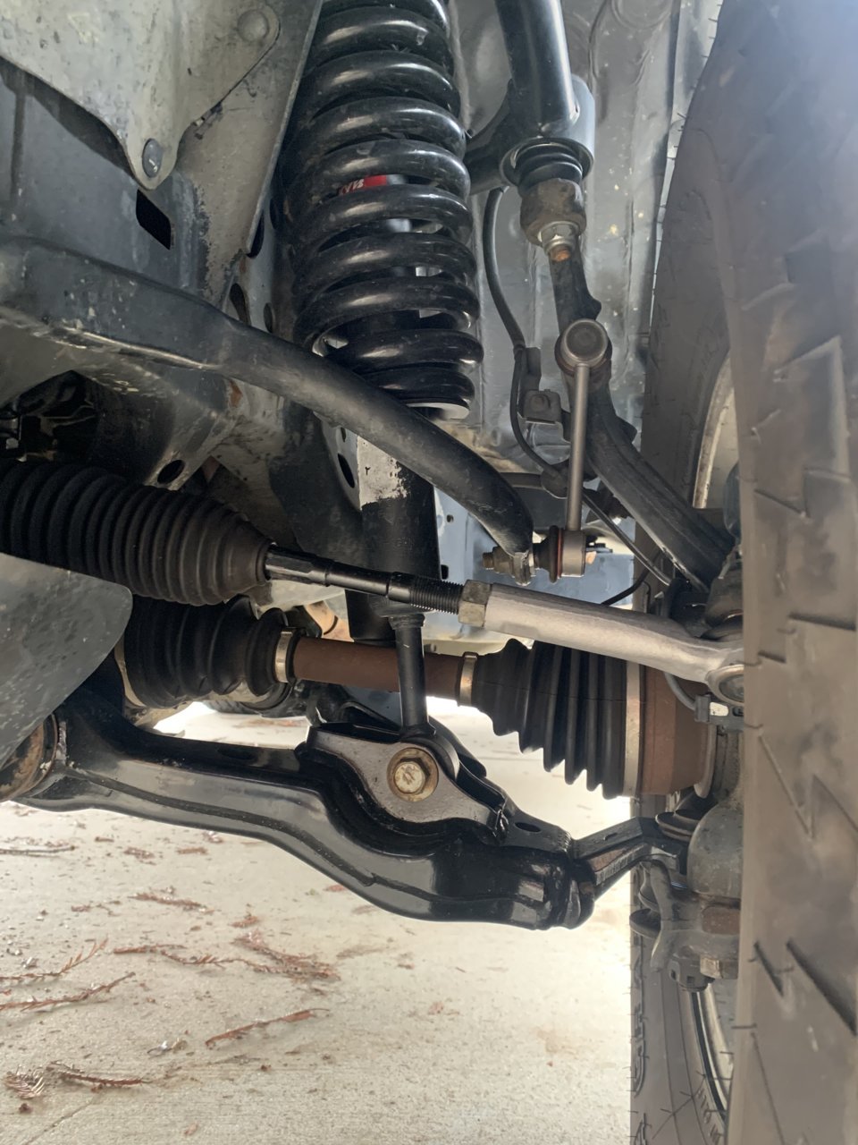

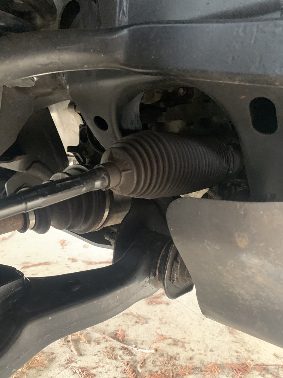

  16. Nov 16, 2021 at 11:16 AM
    #16
    Taco4Jaco
    Taco4Jaco [OP] Well-Known Member
    Oct 19, 2020
    #344309
    384
    Jacob
    Sacramento
    White 2005 TRD OR

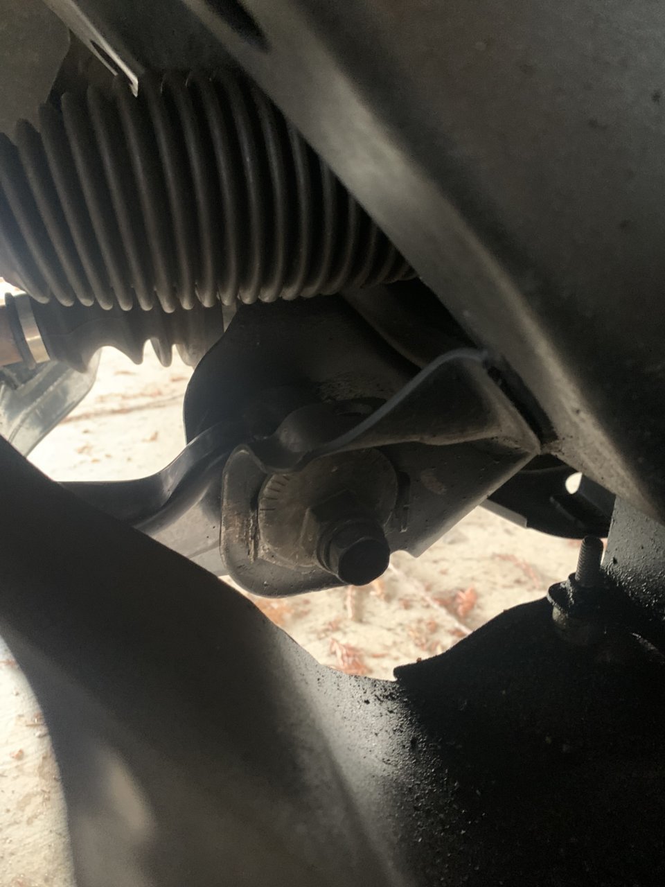

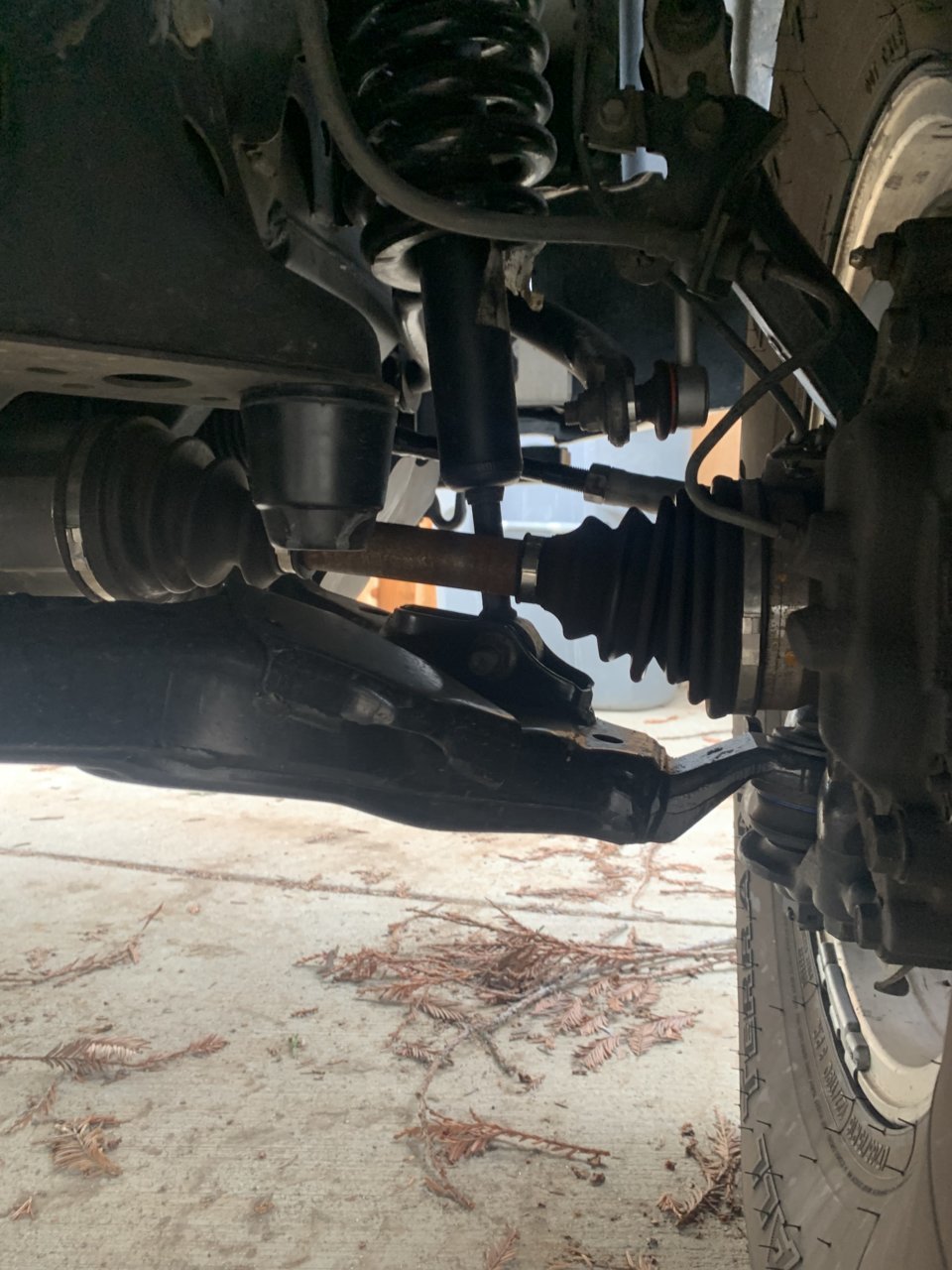

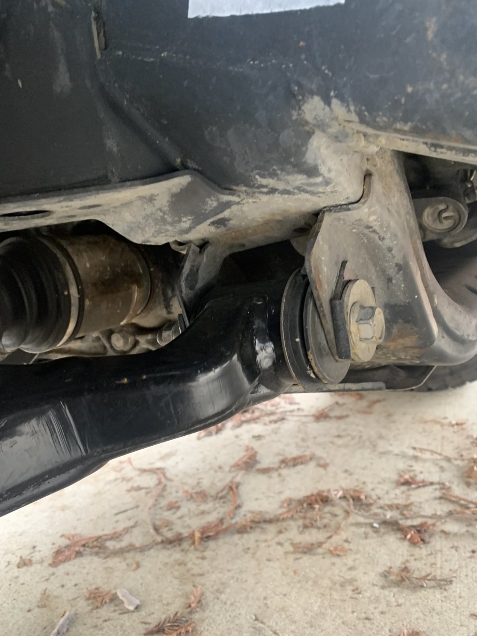

    03DD8FC8-4593-4F20-B0D8-C8E65B83EEDF.jpg 117AE604-4440-4B09-B498-23B8B12C1501.jpg C339E068-FD74-4F91-9763-132415F001C3.jpg 0B0337F4-1B0E-4A27-9A6E-86ABB0CF8145.jpg 0F7E77E9-0EE7-42B2-8799-399C61C9956C.jpg 06159802-D12E-4179-8B78-3984C270BD0C.jpg BF5DEA6E-046B-4DE2-9792-E9AB2F062018.jpg 8AF43CB1-200E-4C23-B265-84ADBA30B1B7.jpg
    drivers side
    mk5 and Biscuits like this.

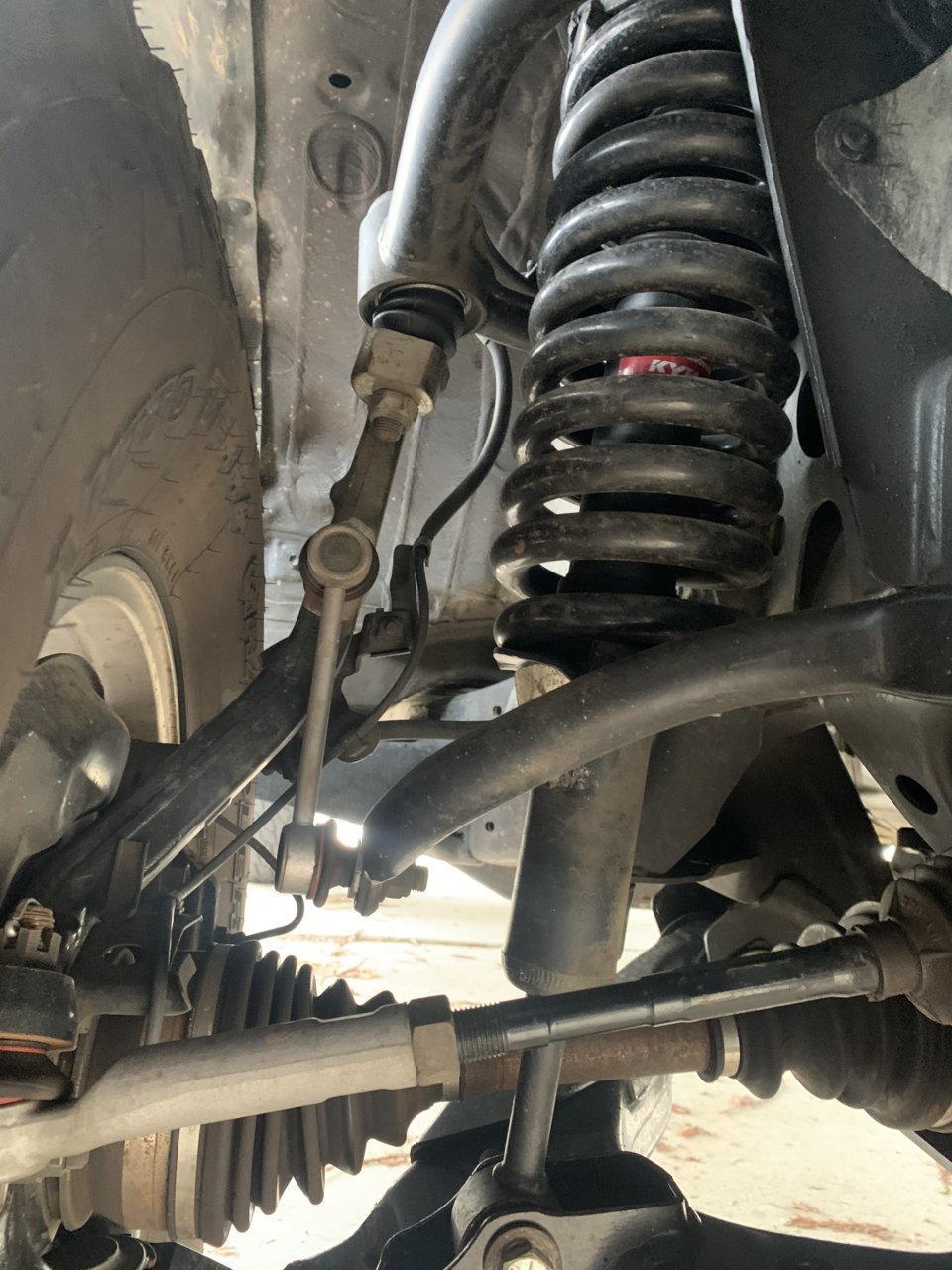

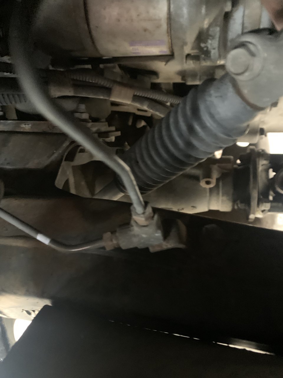

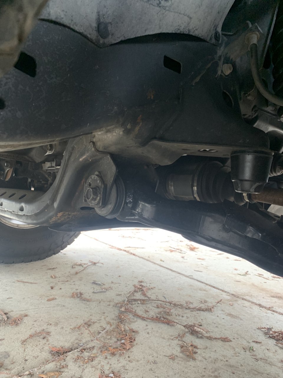

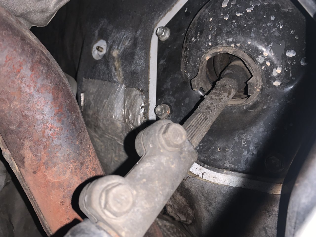

  17. Nov 16, 2021 at 11:23 AM
    #17
    Taco4Jaco
    Oct 19, 2020
    #344309
    384
    Jacob
    Sacramento
    White 2005 TRD OR

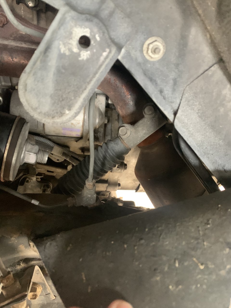

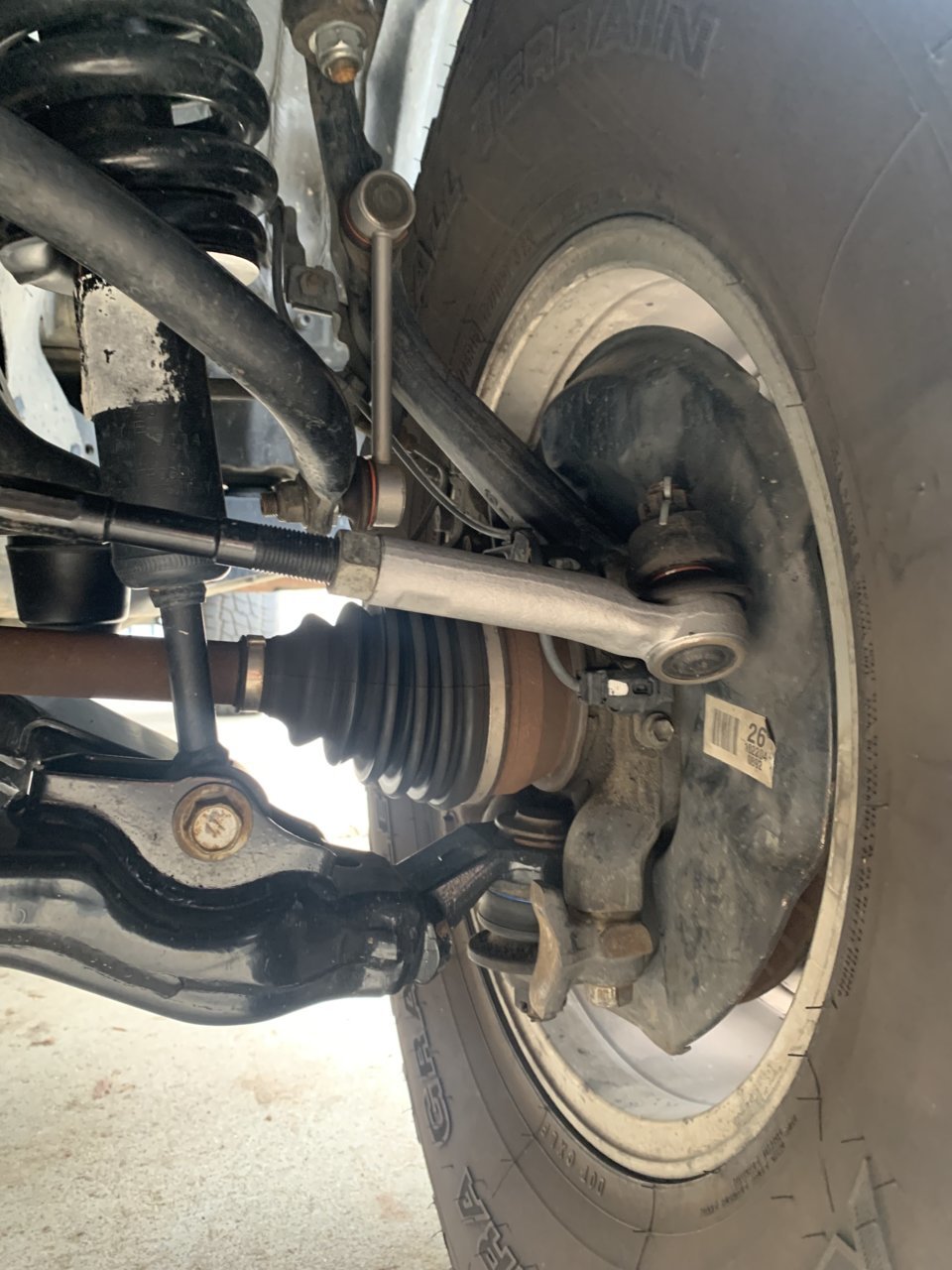

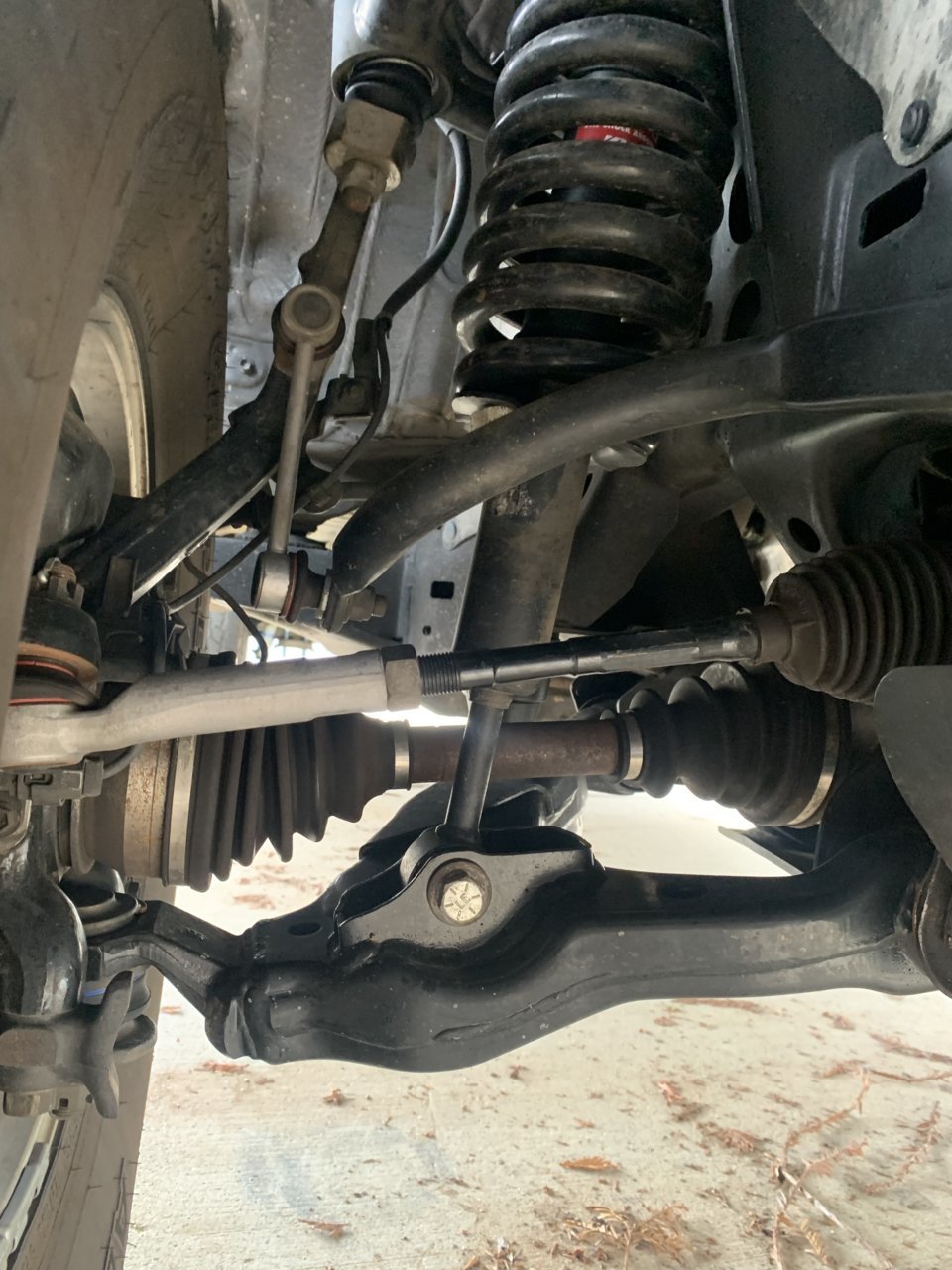

    Passenger side and steering column 0076C9FF-018B-40C0-9BD0-516411A94423.jpg53AAD80C-9A8A-4157-8830-2E2855AA355F.jpgCE150C6E-CE18-4AB6-84FC-3626AA7EC3BD.jpgDEC089A5-6477-4315-9B1E-3FE59B65B449.jpg1754925A-BF6D-4894-B3B8-2C55E2ED1CB1.jpg125CD3E8-F50D-49D1-8FED-37FC41F14DE3.jpg 056A3412-2BFA-45A6-A44D-F69431976CC9.jpg2505D685-5CC8-43ED-B513-70B5794F9A39.jpg7E803569-8A0B-4180-9BCB-30FDB1AFEF79.jpg
  18. Nov 16, 2021 at 11:27 AM
    #18
    Taco4Jaco
    Oct 19, 2020
    #344309
    384
    Jacob
    Sacramento
    White 2005 TRD OR
    Took it down the street a bit and wheel stayed pretty straight except when coming out of a turn. It would be off while going forward then level a bit. Not as off as when I first posted.
