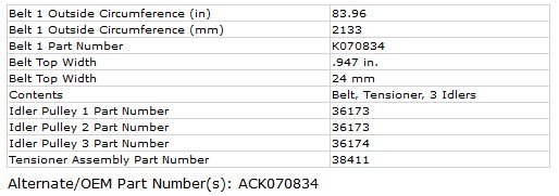

    Anyone have pn’s for the tensioner and pulleys and belt ?

    This is for the Gates Kit from RockAuto.
    I'm leaning towards the Gates kit.
