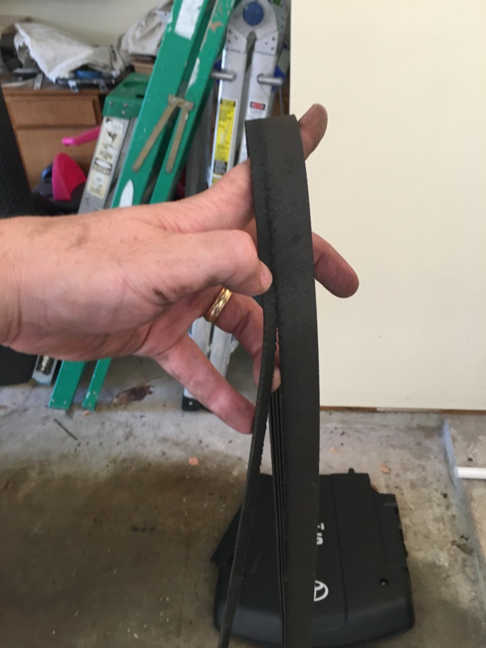

    upload_2019-9-30_9-11-26.jpg I just replaced my OEM belt at 122k. Noticed 75% of the belt was split. It made no noise nor did it snap. Could be a manufacturing non-conformance or one hell of an unwanted force all of a sudden.

    In my case i will keep an eye on the new belt as everything seems tip top. The belt was way past it’s serviceable life. As for the ops belt, in my 27 years of car ownership i personally have never seen one just snap like that. That was brute force. I would guess a manufacturing defect or something straight up stopped spinning, assuming it was correctly routed.
