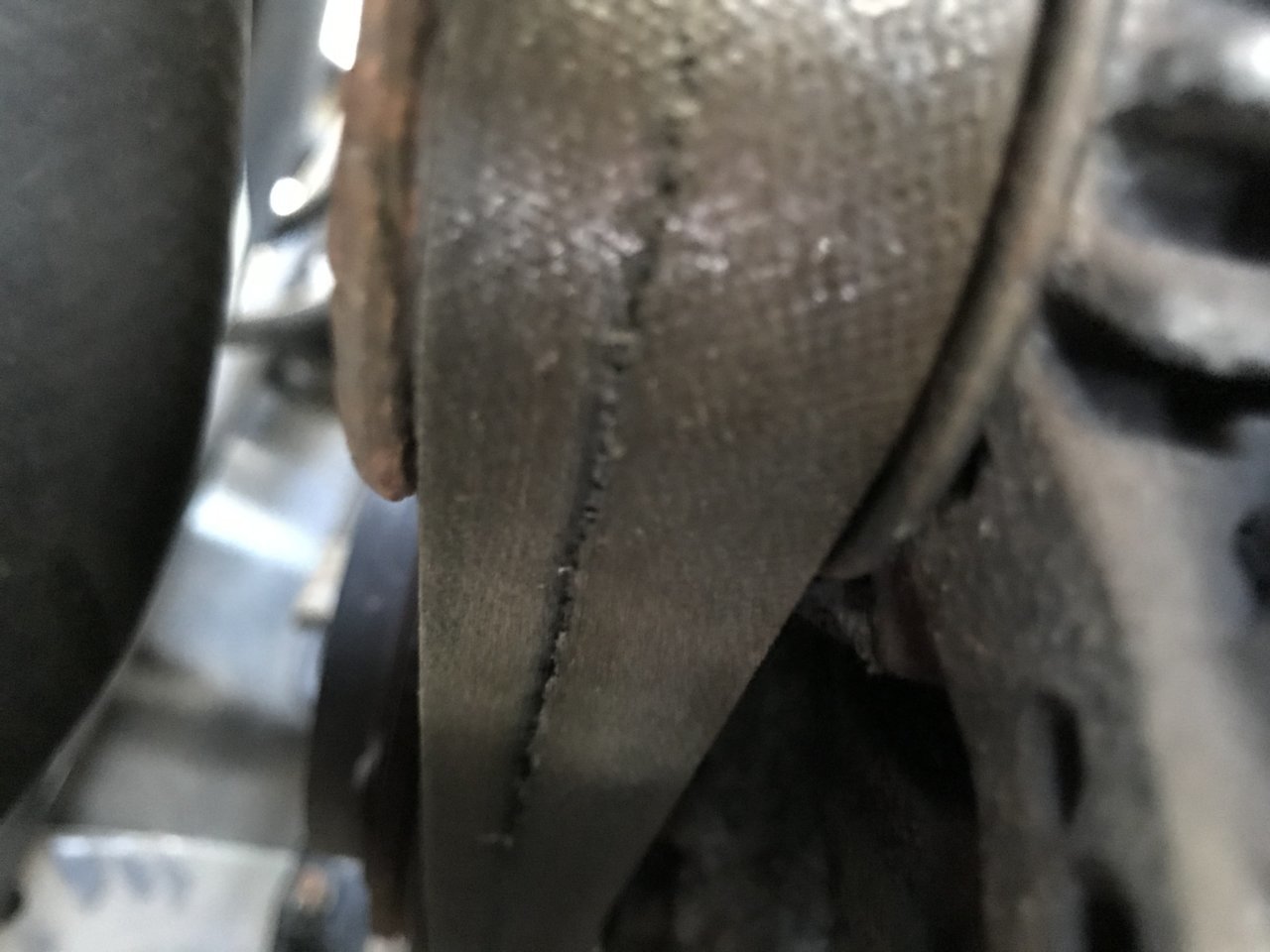

    Check your belt mine was going around 100k837ADD02-AB16-40A6-814B-700E704026F5.jpg
