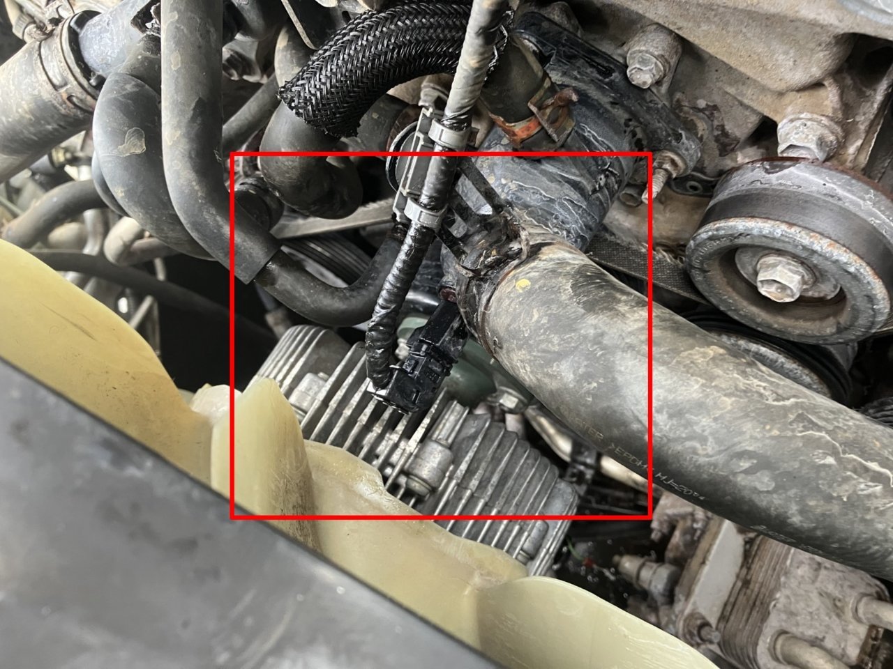

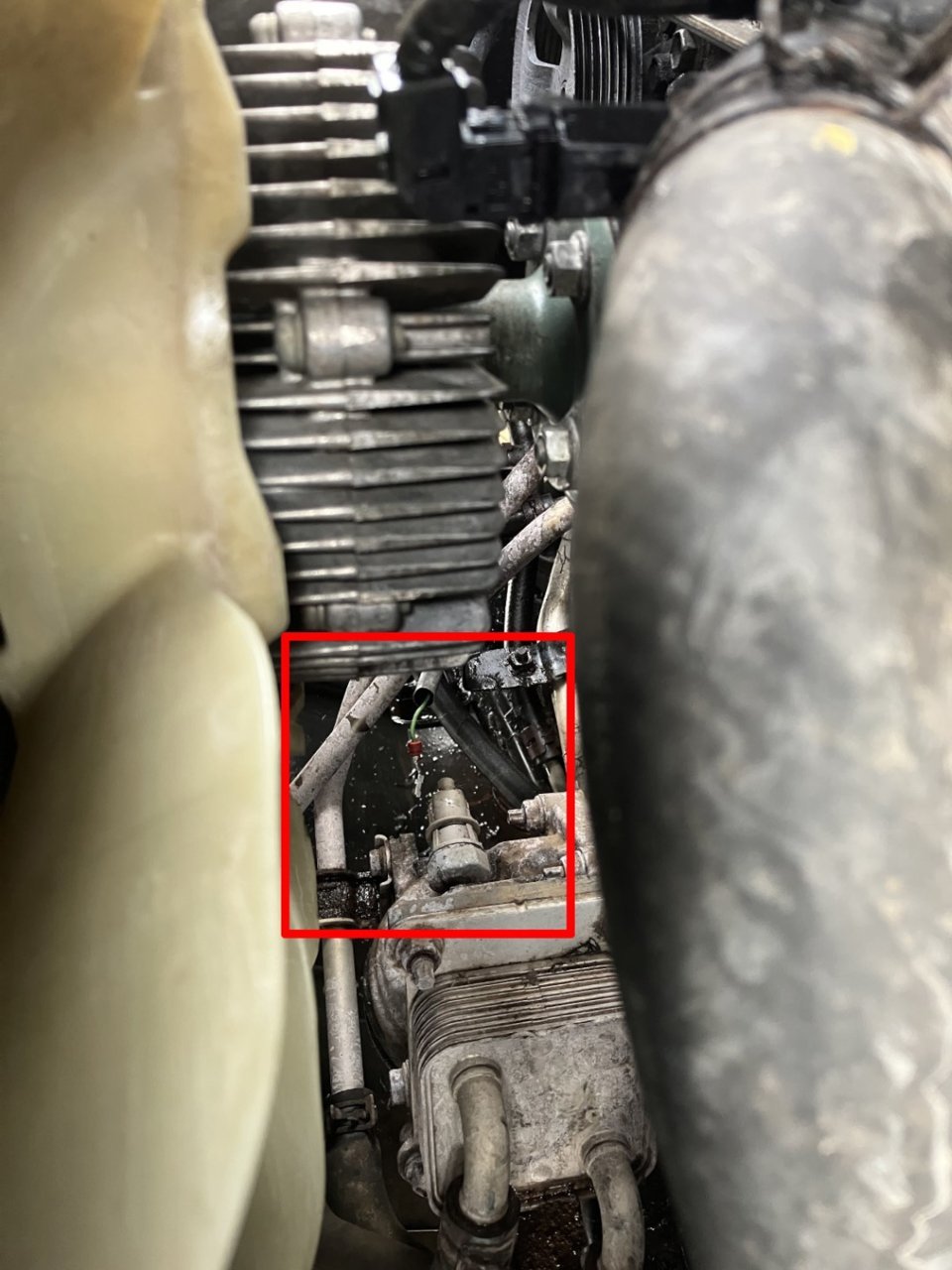

    Half of my serpentine belt shredded today. It then wrapped around the fan and whipped around beating some coolant hoses loose and ripping some wires out. I got all of the coolant system put back together and refilled, and was able to plug all the wires back in enough to get home, but I would like to replace a few electrical connectors that are damaged. Can anyone tell me what these are and the best way to replace them?

    Top one is thermostat, they are in big demand, and expensive sadly. Is the plastic damaged or just the wiring?
    Bottom one is the oil pressure sender, all you need is the connector there thankfully.

    Oddly, the reported engine temp on the dash stayed normal and I did not get any check engine lights nor does anything show up pulling diagnostic codes. Now that I have it back in my garage, it looks like both were damaged on the wire harness side and not the sensor side. A little careful reassembly and a dab of super glue and both seem to be back to good.
