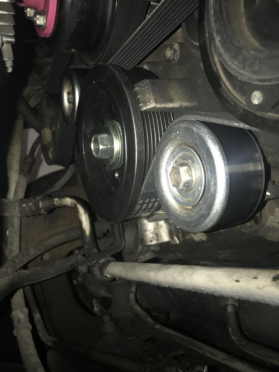

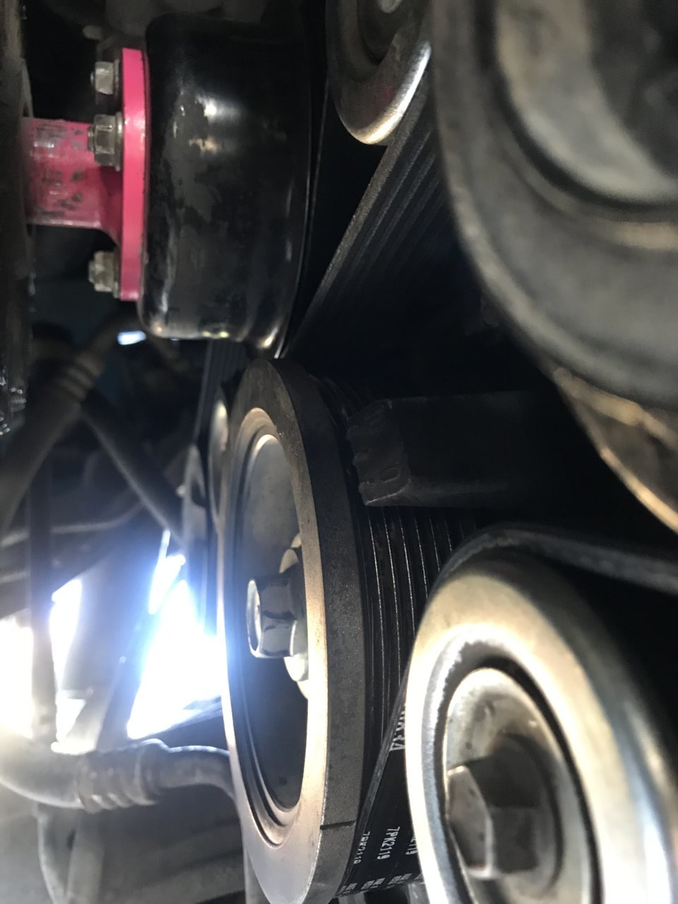

    the power steering pulley has play in it. more than the one i checked out at autozone

    Well it looks like the crank pulley is sitting out too far. Replaced this about one year ago (dayco)

    #35
    Lester Lugnut
    Lester Lugnut Well-Known Member
    Mar 3, 2010
    #32477
    2,822
    N of Mex-S of Canada-E of LA-W of NC
    '15 Tacoma PreRunner V6 SR5 Auto
    I have not had to pull the crankshaft pulley/harmonic balancer on a 1GR-FE. From what I can gather you need a puller to get it off - doesn't slide off like some dampers do. If that's the case you likely had to use a bolt - same thread pitch as the crank pulley bolt but longer and a spacer with some shims to get it back on.
    How did that go? Assuming Dayco part is correct.
    I'm a little baffled as to how you went a yr. with the crank pulley out of alignment or was this recent? - crank pulley bolt loosening? - or is something else out of alignment?
    Puzzled.
  16. Jul 28, 2019 at 6:04 PM
    #36
    Muddinfun
    Muddinfun Well-Known Member
    Apr 17, 2017
    #216500
    7,489
    It's a harmonic balancer. Steel/rubber/steel. It has shifted between the steel and rubber.
    b_r_o likes this.
  17. Jul 28, 2019 at 6:05 PM
    #37
    anthony250f
    anthony250f [OP] Well-Known Member
    Feb 18, 2012
    #73066
    16,785
    Anthony
    San Diego, CA
    2008 dcsb trd offroad 4wd
    When I installed the crank pulley it was fine. For some reason it is now sticking out 1/8” or so.
    Do not need a pulled to remove it. However I did have to use a holder tool and a torque wrench to install
  18. Jul 28, 2019 at 6:07 PM
    #38
    anthony250f
    Feb 18, 2012
    #73066
    16,785
    Anthony
    San Diego, CA
    11C7DC00-BBFE-4F6E-B798-14A8C1CE8BF8.jpg 3954A7FD-C75B-4617-8C8B-167019D1E7D9.jpg
    I actually changed it twice. First time i went with a rock auto brand and it had a slight wobble. Got the more expensive dayco one.
    Top pic is a year ago and bottom pic is now
    Sae68 and b_r_o like this.
  19. Jul 28, 2019 at 6:08 PM
    #39
    anthony250f
    Feb 18, 2012
    #73066
    16,785
    Anthony
    San Diego, CA
    I think you are correct
    Looking at my photos is looks like it has separated and pulled out some
    Muddinfun[QUOTED] likes this.
  20. Jul 28, 2019 at 6:25 PM
    #40
    Lester Lugnut
    Mar 3, 2010
    #32477
    2,822
    I guess not? You replaced one with a Dayco a yr. ago. I was trying to dig thru the FSM doc made available here for '05-'06. Not much popped up for crankshaft pulley removal. I dug deeper and saw a diagram in one section that showed the crankshaft pulley, but found no removal doc. I know it's there - just not popping up. I googled the issue and saw several comments about a puller being used on a 1GR-FE engine.
    But the issue now would be why you are off approx. 1/8". That would be related more to installation vs. removal. If it were my truck, I would lock the crankshaft pulley and re-torque the bolt. If that doesn't not help I would wonder about the fit of the Dayco product. In saying all of this I am assuming there is an issue with the crankshaft pulley and not somewhere else.
