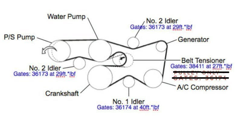

    First time I've had the serpentine belt off on my 2008 tacoma and want opinions on which pulleys need replacement. Fairly certain pulley in Video D needs replacing but what about the others? Also, is this an OEM part I should get or is aftermarket just as good?

    Diagram with pulley locations noted.

    A is on it’s way out.
    B is just about done for
    And D is dead.
    If you are on a budget, you might get by with just doing B and D.

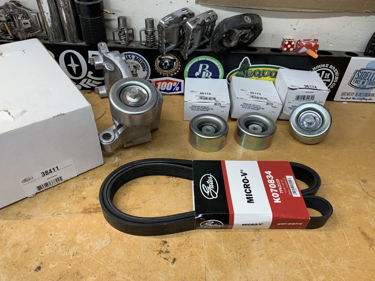

    No budget issues, my main concern is ordering the right parts and getting them ASAP (this is my daily).
    Was able to find the three pulleys - I've seen videos where they arrive but without replacement hardware. I'm assuming the best action is to go to the hardware store and match them up as it's likely best to replace that as well (washer, etc.,)

    Just did this a few weeks ago to my ‘06 PreRunner 4.0. This is what I used for the parts and torque specs. Got my parts off Amazon. I also replaced the alternator a few days later, it was making a ticking noise. That was an Autozone free replacement part.
    I put the front up on jack stands, pulled the skid plate, and did it all from underneath. Now super quiet.
    After I got it all off, the pully on the tensioner looks a lot like the 36174. If I was to do this again, I would just order a second 36174 pully for the tensioner and use the stock bolt and washer to install.

    If your pulleys are in good shape, I have a thread on how to replace the bearings in the pulleys, including the tensioner. Do not use pulley # 36174 to replace the tensioner pulley. There is a reason it’s crossed out in the diagram above - the pulley will fit, but, because the bearing is too wide, the pulley bolt loses about half thread engagement. Down the road, you may strip the threads out of the timing cover. It is not worth the risk.
    To test the bearings, rotate the pulley by hand. It should spin smoothly and freely. And there should be no side-to-side nor fore/aft movement, except for about 1mm fore/aft movement on the PS pulley. That appears to be normal or it could just be mine as it has always had that play, as have most of my other vehicles. The water pump bearing may be difficult to test as you would have to remove the fan clutch to isolate any play.

    Quick question: Did you install the pulleys exactly how they came, or did you use additional washers anywhere? I see some YouTube channels using additional washers on the 36173 (in-between the bolt and the race/insert that fits in the bearing). Not sure if it makes a big difference but curious if there is a best practice.. Or if it yeetz it skeetz.

    Any advice on whether or not I should add a washer on the 36173 like the one used with OEM, or just install with the small insert that it comes with?
