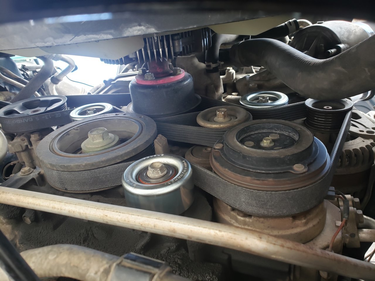

    I am in the processed of changing my belt and while checking the idler pulleys I noticed they have a little movement when I rock them up and down, is this normal? They don't make any harsh noise when I spin them, just a little play. The truck has 120k miles.

    The idler pulleys. I just noticed i left that out of the title. They all have a little rock in them when i checked them with the belt off.

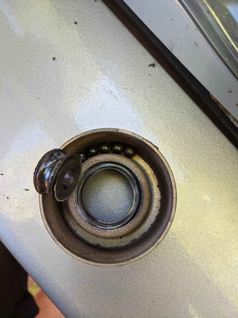

    And honestly, just grab new OEM pulleys. The effort involved w/ getting the old bearings out to save a few bucks isnt worth it imo. With the belt already off, you're looking at maybe 5-10 minutes to get the idler pulleys swapped out if you have new ones in hand.
