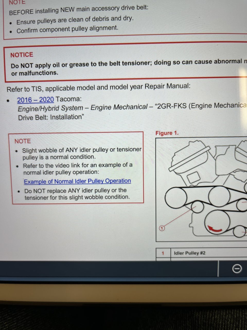

    TSB009820 from Toyota states that “slight wobble of any tensioner or idler roller is normal”

    I replaced my belt at 40k miles because I developed a chirping noise that is addressed in Toyota Service Bulletin 009820 that references the roller wobble

    2DE20968-BE32-4590-954C-C253DB07CE6F.jpg 2DE20968-BE32-4590-954C-C253DB07CE6F.jpg 2DE20968-BE32-4590-954C-C253DB07CE6F.jpg From Toyota bulletin:

    https://static.nhtsa.gov/odi/tsbs/2020/MC-10182963-9999.pdf
    "1. Confirm the condition exists. Does the vehicle exhibit a chirp noise from the main accessory drive belt?
     YES — Continue to step 2.
    NO — This bulletin does NOT apply. Continue diagnosis using the applicable Repair Manual."
    Mine has never made any of these noises.
