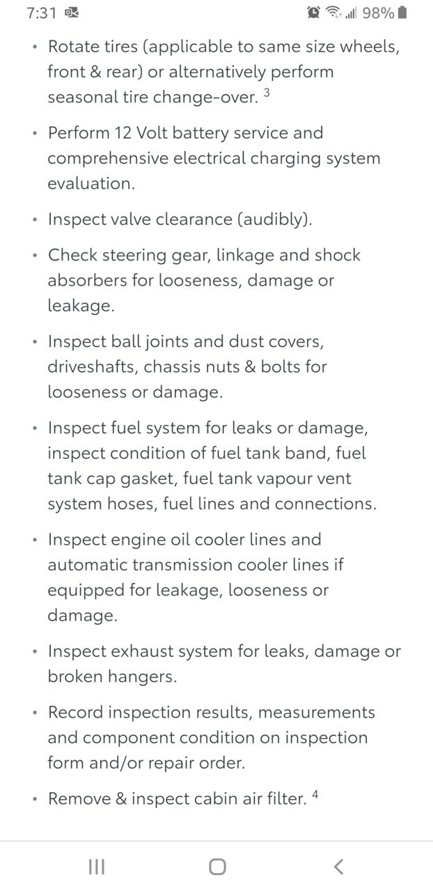

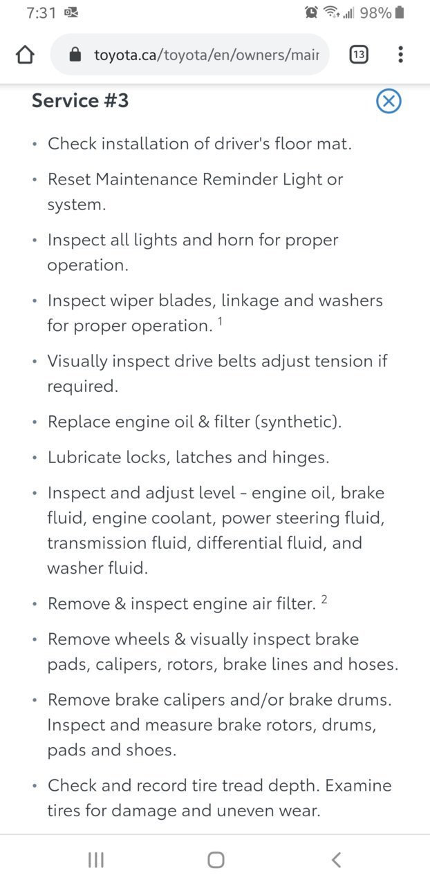

    No where on a service 3 does it say to clean the carbon or flush the injectors. They are looking to take your money.Screenshot_20200226-073139_Chrome.jpg Screenshot_20200226-073149_Chrome.jpg
