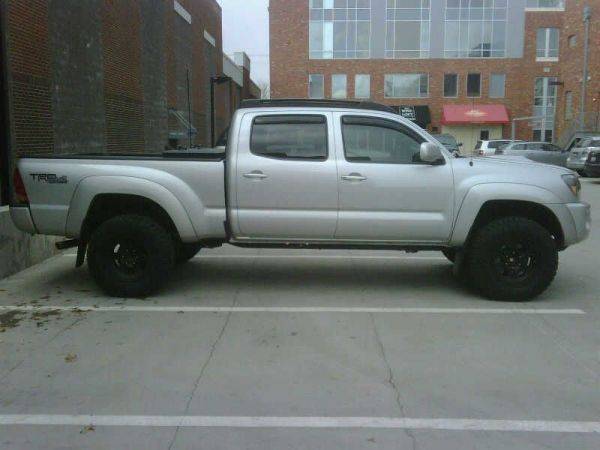

    Here is mine, 1.75" front 1.5" aal, 265/75/16 tires
    As you can see it is raked like the factory stance. I'm installing Eibach's on the .85" setting with Light Racing uca's soon.

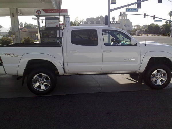

    5100's all the way around. Front set at .85. Camburg Spindles. Camburg Uniball 1.25 UCA's. Total Chaos LCA skid plates. Custom Deaver 10 pack rear leaf spring. BFG AT KO's 285/70/17, Weathertech floor liners, Wet Okoles. Midland CB/PA, Firestick.
    I did the 5100's with the 2.5 setting - rear TSB with a 1" block - Looked great. I definitely recommend an alignment after install. Front had camber and started noticing uneven tire wear after 5000 miles. It also road a little stiff.
    5100's set at 2.5 and TSB with 1" block:
    265/65/17 - Duelers HT - Stock
    Camburg Spindles, 5100's set at .85 and Camburg 1.25 Uniball UCA's with rear TSB with 1" block - Deaver 3" custom leaf pack on order - Right now, the rear does not keep up with the front suspension. Gained down travel and rides like butter. Very fun going fast over those speed bumps at the mall! LOL. Very happy with the front set up. Sits a little nose high right now, but the Deavers will level it out nicely.
    285/70/17 BFG TA KO's:
