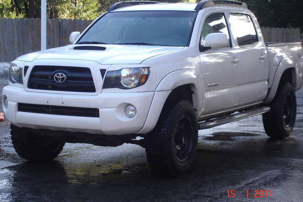

    2017 OR SB mgm fox 2.5 dsc front 2.o dsc rear , ome medium leafs ray10 brushed bronze on Nitto RG 285 70 17 Prinsu waterport bed divider pro grill yellow tint fogs Raptor lights Xtreme led 38"
    i voted 2.5 cause mine is set at 1.75 with 1.5 aal and regret the height !

    never mind ! here you go.[​IMG][/url][/IMG]

    Thx Thats what i figured and this is what I got
    Originally Posted by bocna
    never mind ! here you go.[/IMG]

    To me, 1.75 is barely noticeable. I thought my 265 70 17 bfg ko were going to clear without the removal of the mud flaps and trimming of the plastic.
