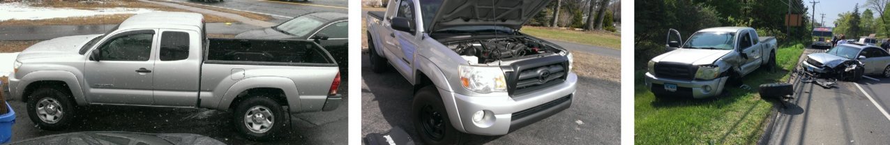

    Previous Tacos
    1. 2006 SR5 Supercharged 6MT
    2. 2018 Off Road 6MT
    • May 2018 - June 2021
    • 36 month/45,000 mile lease: 7 miles - 38k miles
    • No thread. No modifications. Short bed didn't work for me.

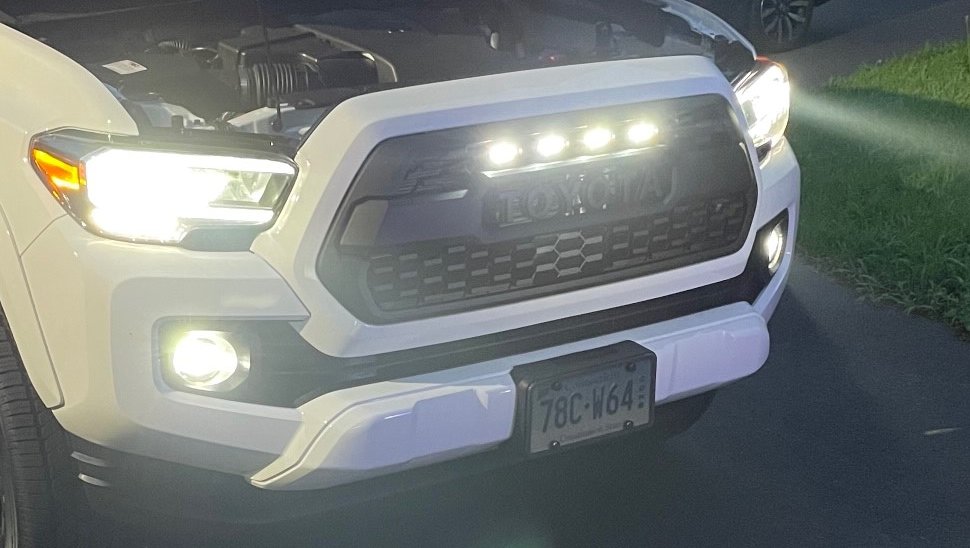

    3rd Gen Tacoma Grille Lights Add-a-Fuse Install
    The white raptor lights are brighter than I expected and match the factory LEDs. They are wired to the head lamp circuit. Other drivers don't seem to like them at night.
    NOTE: There's NO need to cut holes in the fuse panel to add a circuit. There's a door in the back corner with plenty of space, but be careful to not pinch wires when closing.

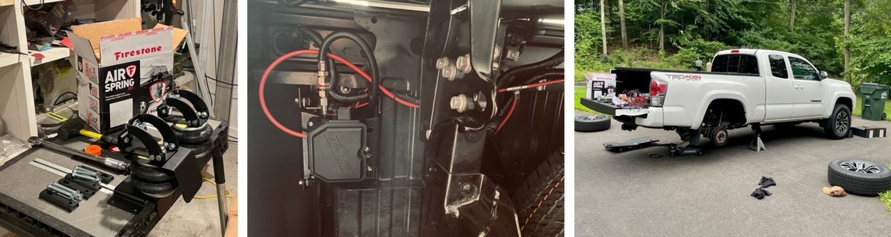

    Air Spring & Wireless Compressor Install - July 12 2021
    Works great for hauling wood and smaller motorized toys. The rear sits ~3/4" higher than factory at 10 psi. Fills to 100 psi in ~2.5 minutes
    The install took the better part of a weekend. A majority of the time was spent pulling wire and founding a place to mount the compressor. The frame is already jam packed with factory electronic and pneumatics. I ended up mounting the compressor to the carbon bed then grounding to the frame.
    I did not cut the factory rubber stops as the instructions call for. Removed them instead.

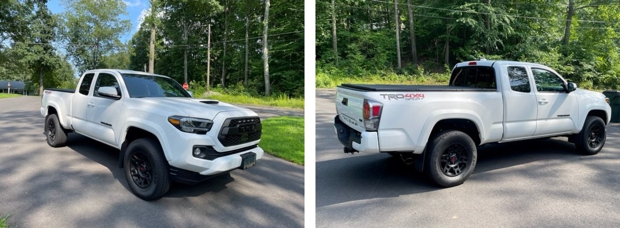

    Rim and TPS swap by Greentree Toyota service - July 16 2021 @ 700 miles
    17" TOYOTA TRD PRO WHEELS MATTE BLACK FOR 4RUNNER FJ CRUISER TACOMA OEM - TOYOTA (PTR20-35110-BK)
    These were a close 2nd: TOYOTA TRD 17" 6 SPOKE NEW STYLE FLAT BLACK WHEEL OEM PTR56-89210-F2 - TOYOTA (PTR56-89210-F2
    Long story short:
    I had the Greentree Toyota Service team unmount the factory Toyo A30 Open Country tires and TP sensors, then remount them on a set of brand new matte black 17”x7” TRD Pro 4Runner rims.
    I'm happy with the outcome but, what a PITA..
    I was quoted $199, but charged $285 in total. Can't complain because it took the service team 9hrs and $140 in parts to complete the job. We both learned stuff about the new trucks that day.
    Wheel swap fun facts:
    • The OEM 17” x 7.5” 4261104200 TRD Sport rim MSRP's for $530 plus $60 for the center cap.
    • 17” x 7” PTR20-35110-BK Pro 4Runner rim MSRP's for $235 center cap included.
    • I got a new set of PTR20-35110-BK shipped to the house for $770 from BAM wholesale.
    • The factory black valve stems on the new tire pressure sensors are not reusable like the old sliver stems.
    • New stems (~$80) and TPS recalibration ($125) are required to transfer to new rims.
    • Rim swap by Toyota service should cost 3 hrs labor; new valve stems; TPS calibration.
    • The 4260B-04040 sport center caps are extremely easy to damage/crack. Greentree had to replace one of mine.
    • Always inspect your wheels before and after a shop puts their hands on them.

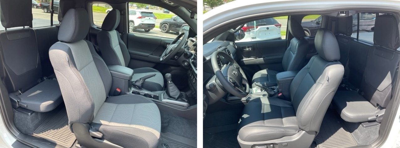

    Aftermarket leather installed by Greentree Toyota - July 24 2021
    Factory leather was not an option for the access cab. The cost for the front and rear seats was ~$1,300. I'm super happy with it.
    It was a 3 day process, but Greentree provided a loaner taco. Only down side was they had to put 90 miles on the truck.

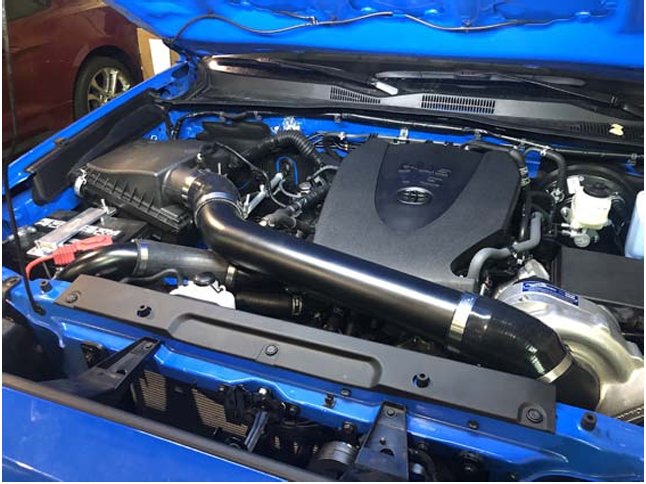

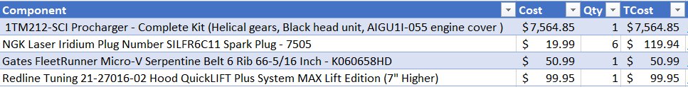

    Another 3 years flew by. My lease ends in June. The truck has ~33k miles.
    I'm ready to make it my own. Just ordered the 1TM212-SCI Procharger kit.
    I'll be taking my time and documenting the install here.
    My ABS module is on the passenger side. I'm keeping the factory airbox which leads to a few components being shuffled around the engine bay. 1TM212-SCI Install Manual.pdf
    The Magnuson PD kit is definitely prettier than the Procharger. I'll be trying to improve fit and finish where possible.

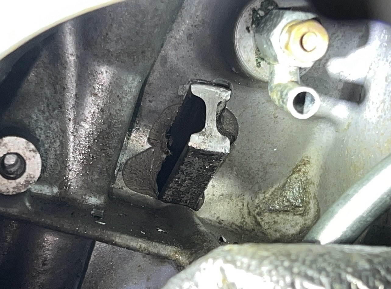

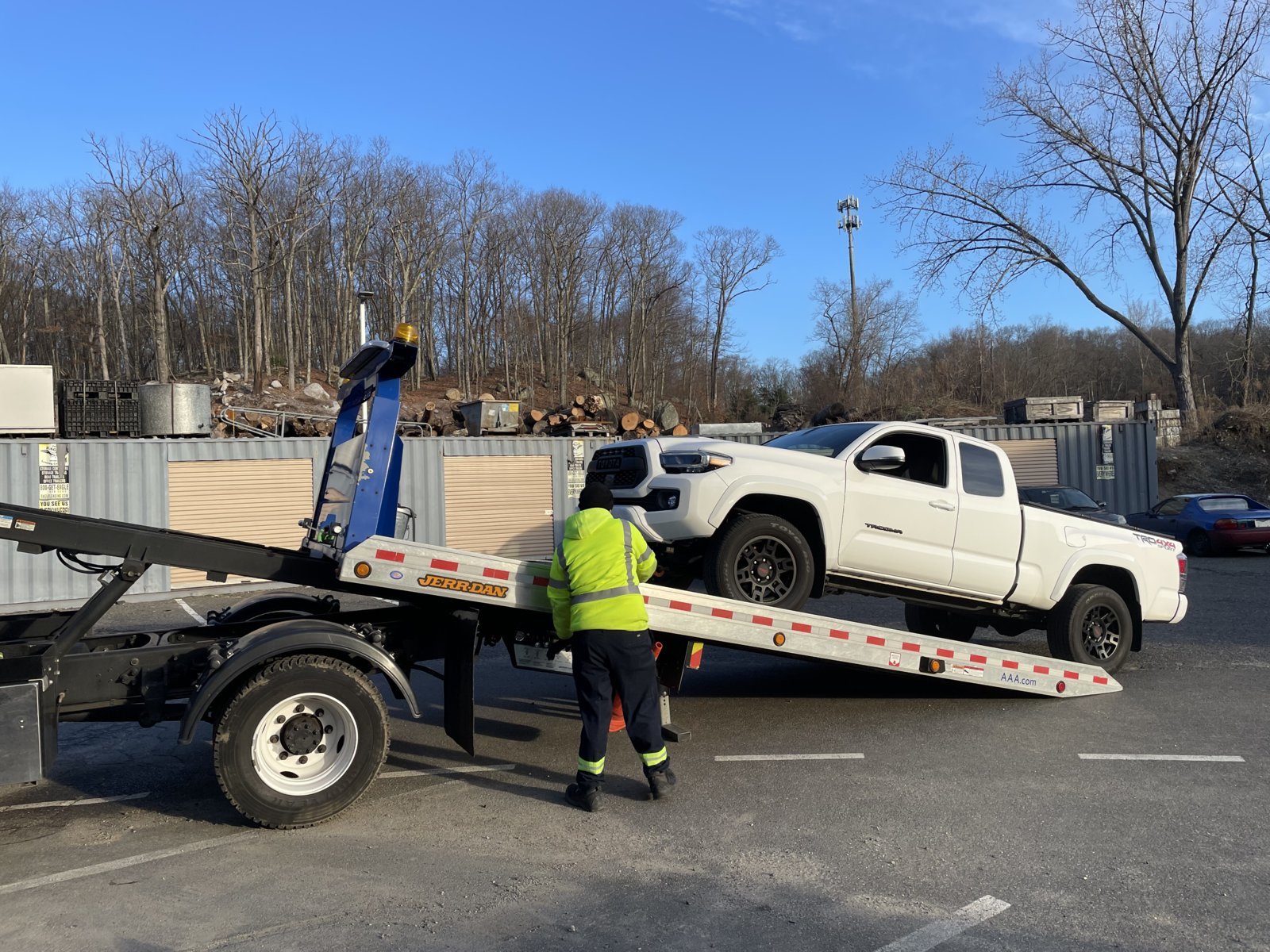

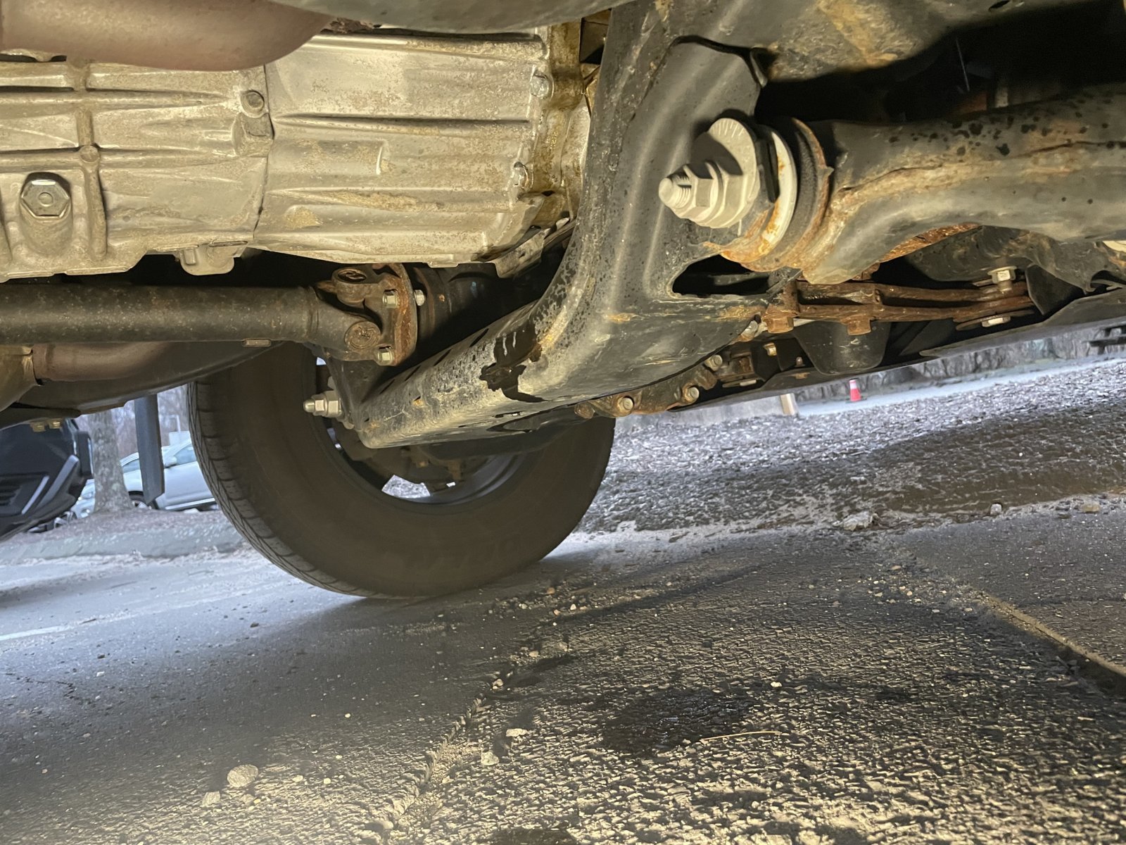

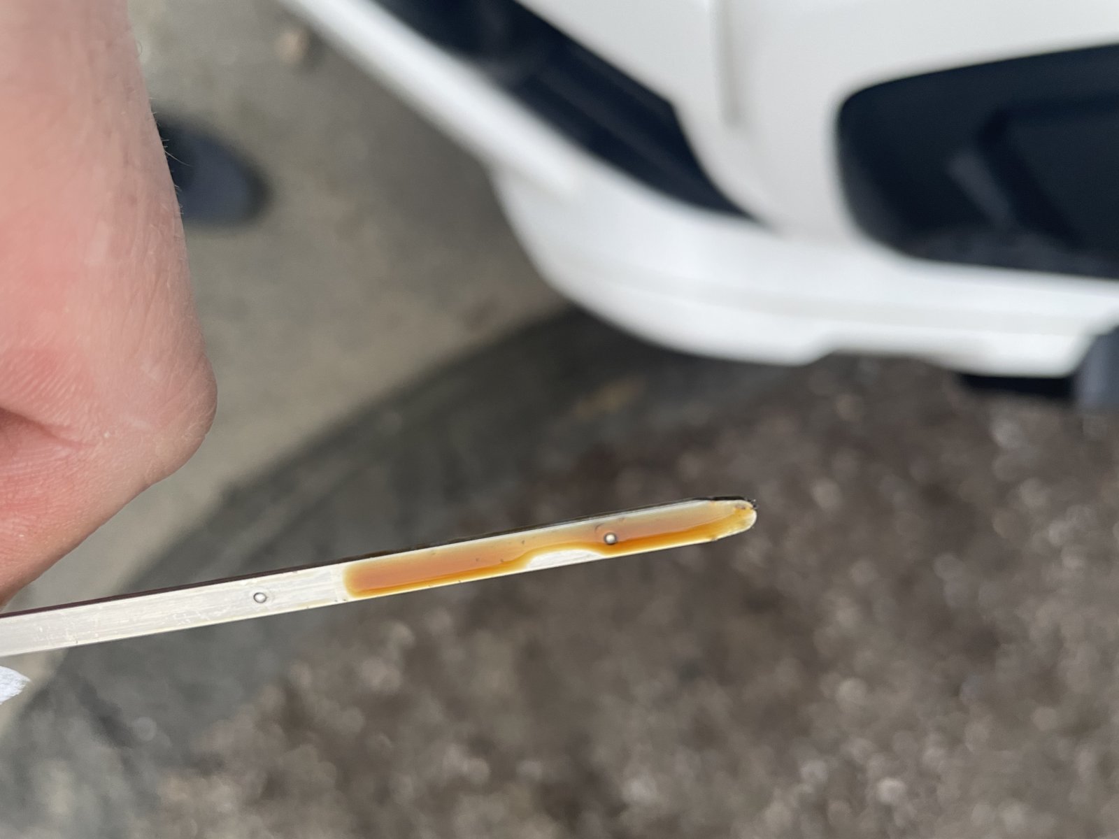

    Damn it.. the Procharger install is on hold.
    A connecting rod sheared and shot through the block as I was leaving work on the 22nd. My scanner found 3 crank position codes. Oil dipstick is littered with metal.

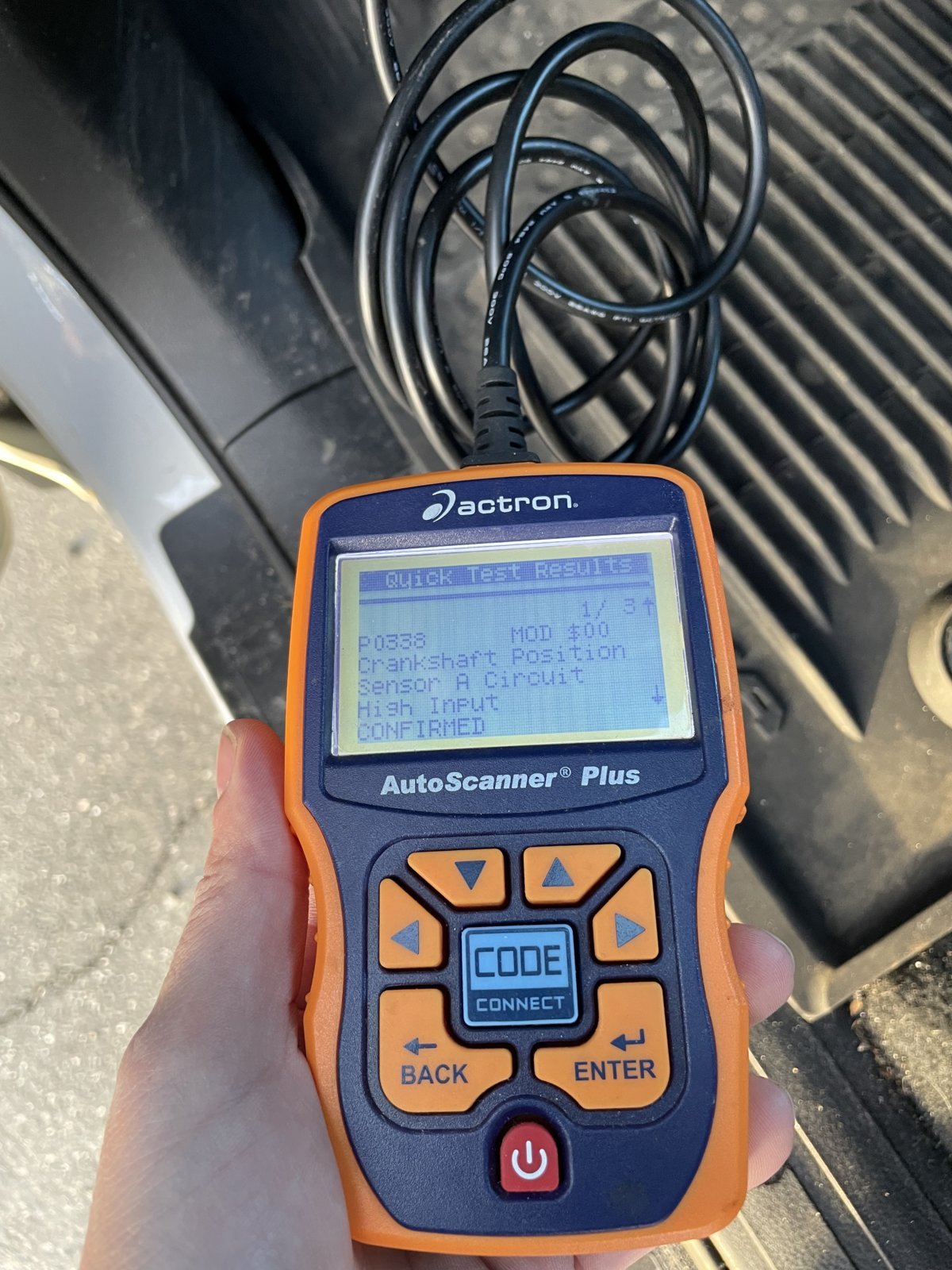

    The truck is still under lease. Greentree has performed all maintenance. They are assuring me it will be warrantied.
    Luckily, I was making a left out of the parking lot and traveling uphill. It broke shifting 1st to 2nd. I was able to get the truck turned around on it's own power, confirm that my clutch/trans were fine, and coast back into the work parking lot. It was pretty obvious once I popped the hood. It will still start and run which makes me think the root cause is within that cylinder.
    I left the truck at work for the weekend. Called Greentree on Saturday to schedule an appointment. AAA dropped off the wounded warrior and I at the dealer service center on Monday morning (25th). Greentree had me out of there in 30 minutes with a loaner corolla cross hybrid thing.

    Warranty approval was supposed to take 2-3 business days. I'm still not approved yet. Hopefully Tuesday.
    Later on the 25th, I received a pretty irritating call regarding my A/C drain extension hose: https://www.tacomaworld.com/threads/rust-on-frame-with-a-c-drain-mod-fix.444138/
    I'm paraphrasing:
    "We're documenting and taking pictures of the damage. Did you have work done to the A/C system?"
    Me: "Nope."
    "We found a rubber hose installed very close to the CPS. The CPS was found unplugged."
    Me: "The hose is a well-known fix to correct a factory flaw. What would happen if I tried to drive the truck with the CPS discounted?"
    "(Long pause)... The vehicle would not start. No stark or fuel delivery."
    Me: "I hope this won't be mentioned again. Thanks."
    I'm thinking they scanned for codes which would lead to checking the CPS. Whoever was taking pictures of the damage may have unplugged the sensor harness for clear view to the block from underneath.
