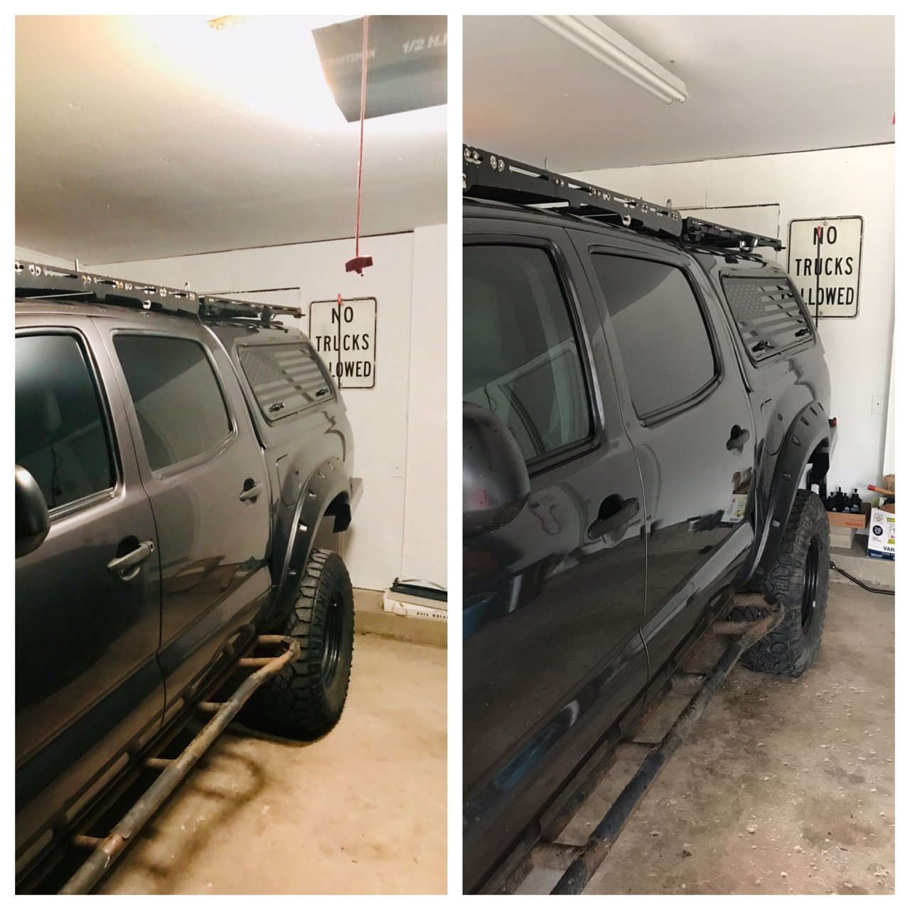

    I love shackle flips and if they’re dialed in correctly they are a beautiful thing but they have their limitations. It’s so cool to see products like Archive Hammer Hangers and BAMF HD hangers. The future is now and it is so good.

    FWIW @mventure._ has the archive shackle flip and his truck sits static and wheels just beautifully. It’s executed so well on his truck, seeing that in person is awesome.

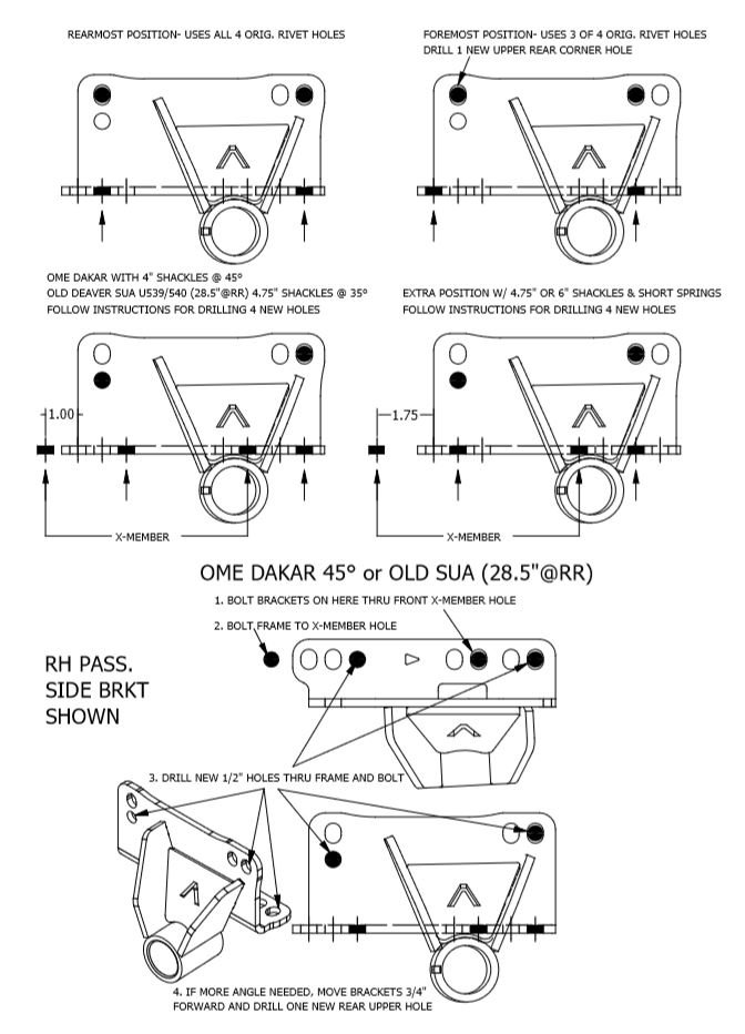

    There is one indisputable truth, the stock Tacoma hangers are trash, in every way.
    As the designer and builder of the Archive Shackle Flip and the Archive Hammer hangers, and experiencing both on my personal 2005 DCSB, I highly recommend the Hammer hangers over the shackle flip to most Tacoma owners. The Hh return a carlike ride improvement, and increase droop travel without hurting bump travel, and vastly increase durability.
    https://www.tacomaworld.com/threads/tacoma-hammer-hangers-soa-sua-archive-garage.519625/
    However, the Archive shackle flip is a pretty sweet combo with off the shelf Deaver Spring Under springs:
