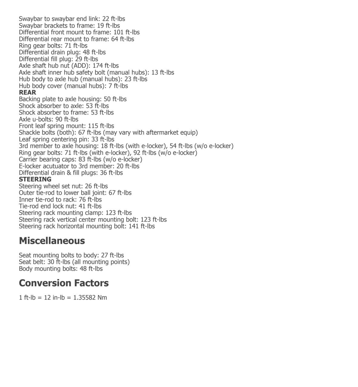

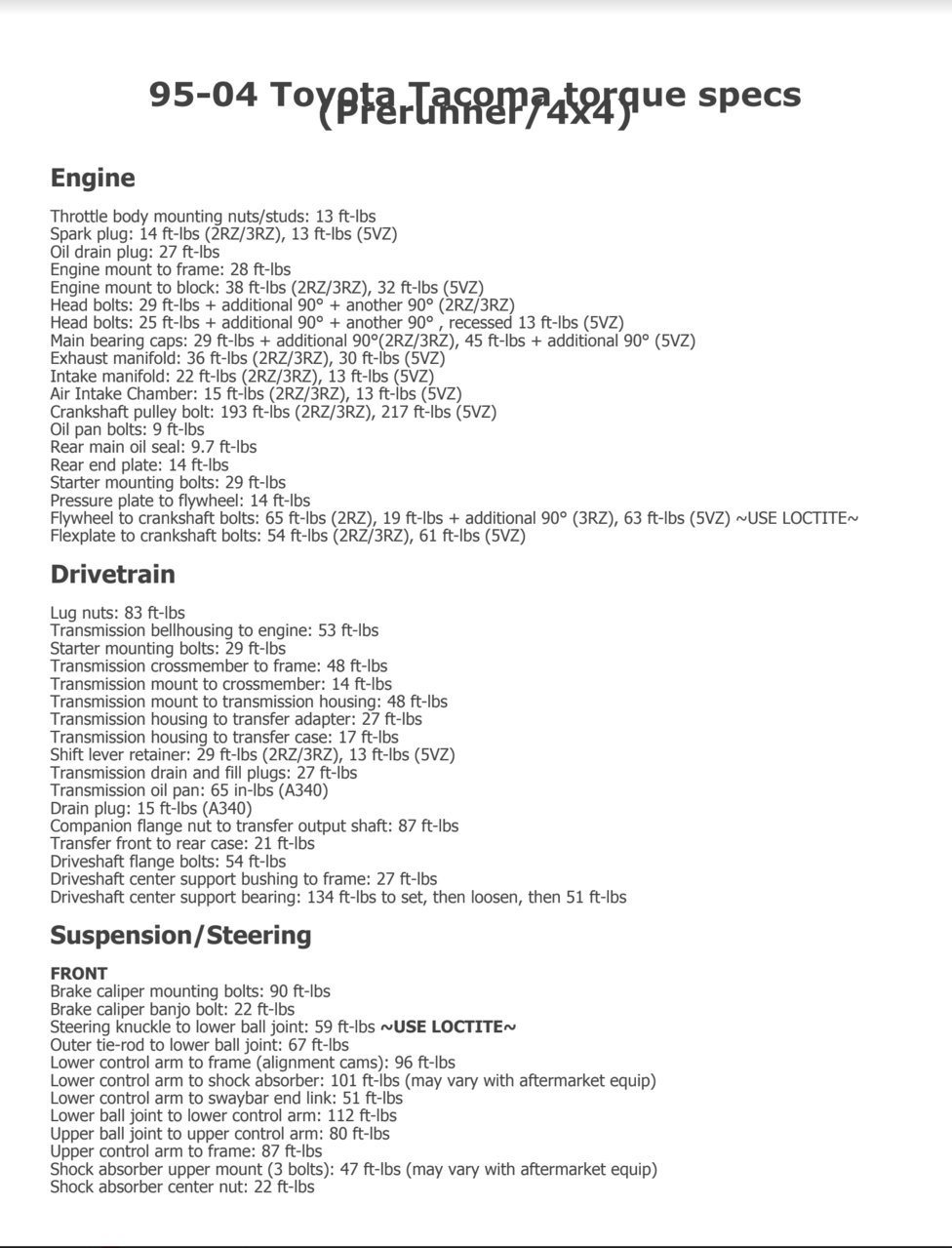

    Does anyone happen to have the torque spec on hand that the rear axle ubolts should be?

    73 I think

    For 1st gen Tacomas (1995 - 2004) it's 90 ft/lbs
    Here are some torque spec sheets for future reference

    Definitely torque correctly.
    I recently noticed on my driver side my 2 of the 4 nuts that hold the two U bolts where missing I had just drove from Tampa to Boston and back to Tampa and can’t believe my truck didn’t look like these guys photos.
    CHECK YOUR U BOLTS !
    https://www.tacomaworld.com/threads/the-torque-spec-guide.318116/
