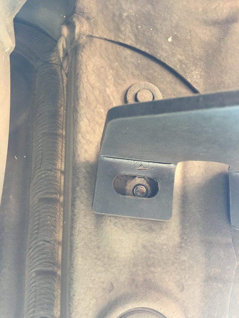

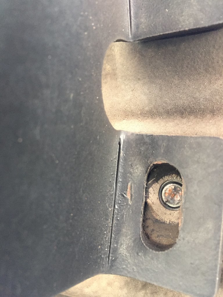

    Little late, here are a couple pics:

    Drill a small hole in the center of the bolt and get an extractor on that and pull it out.

    Hit it with some PB Blaster, let it sit for 20 minutes, then use a drill. Most of the time they will just back out while you are drilling, but those bolts are in a spot where they will probably get a bit corroded. If it doesn't back out, then get an extractor. Get a replacement bolt at your local auto parts store.

    When you are drilling, use a left-handed drill bit. If you are lucky the bit will grab the bolt and back it out.

    Acentone and transmission fluid 50/50 mix works good too

    The bolt should be soaked wit PB blaster. Then you need to center punch the bolt and then use the correct drill bit for the extractor. Easy job any hardware or partsman worth a damn can show you .

    Honestly, I'd run a self tapping screw next to it and call it good.

    Those bolts have Loctite on them from the factory. Be careful you don't break the extractor if you go that route. Sometimes, the heat of drilling the center of the bolt will help loosen the Loctite.
    I would drill out the center then soak it for about a week with some type of penetrating oil before I tried extracting it. Like BeeBop said, the ATF acetone mix works well.
