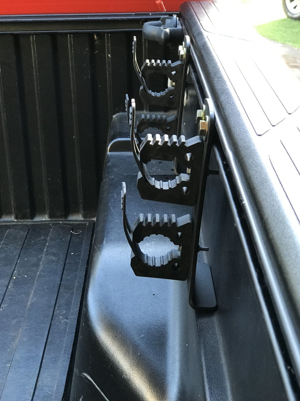

    Relentless Fabrication Quick Fist Mounts

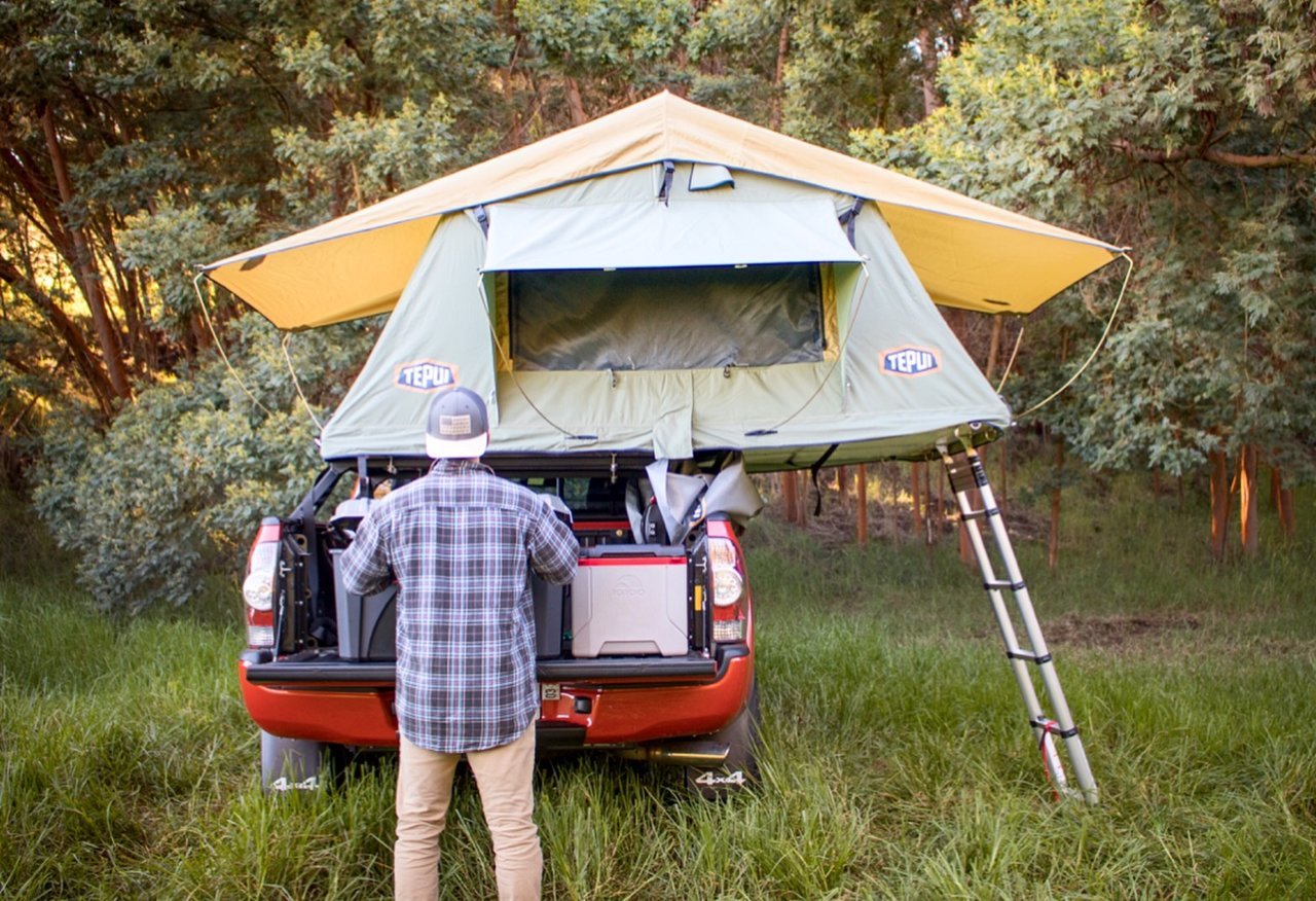

    Tepui Kukenam 3 Explorer Series

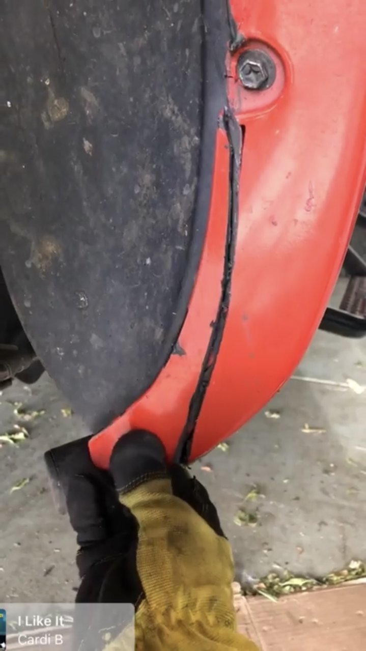

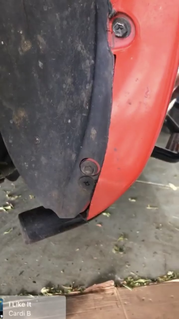

    Not sure why it’s not showing in my original post, but here’s the trimming I had to do because the rear tires were rubbing A84902CD-C09E-48AE-8047-1C61DFE535DB.jpg 1635145B-8F79-439B-95F1-C17F3C5BB054.jpg

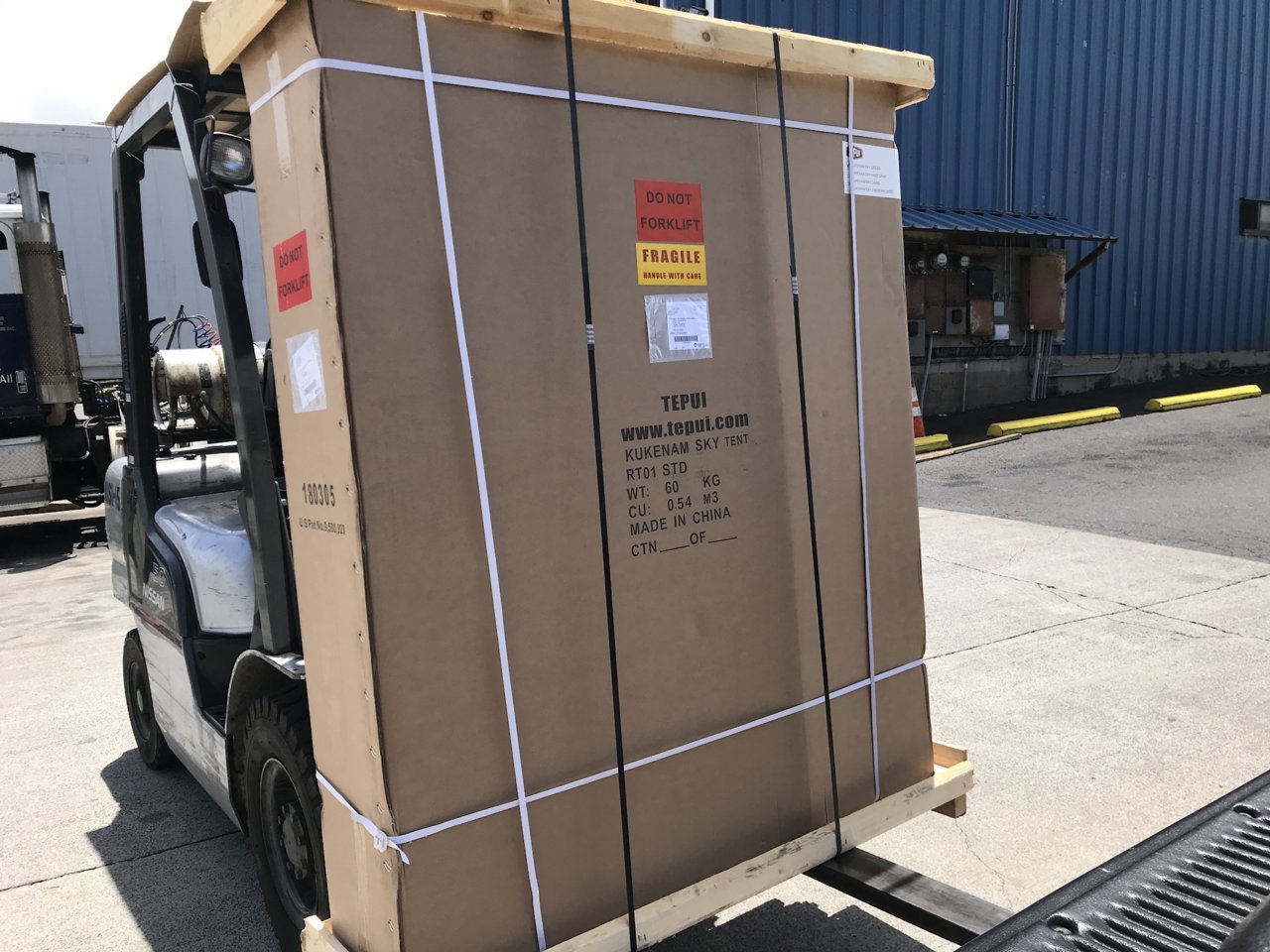

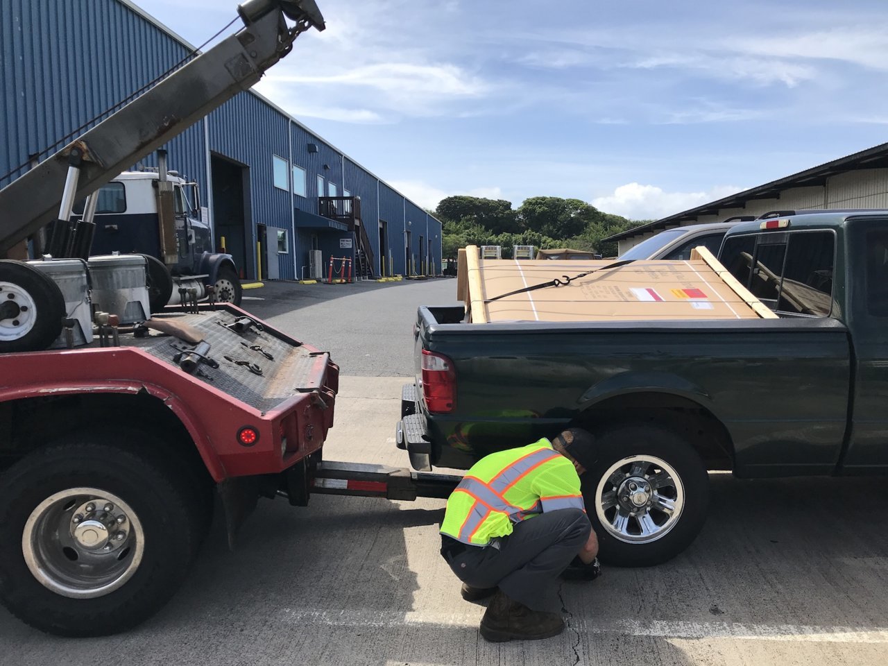

    Also, here’s the tow from when I picked up my Tepui...

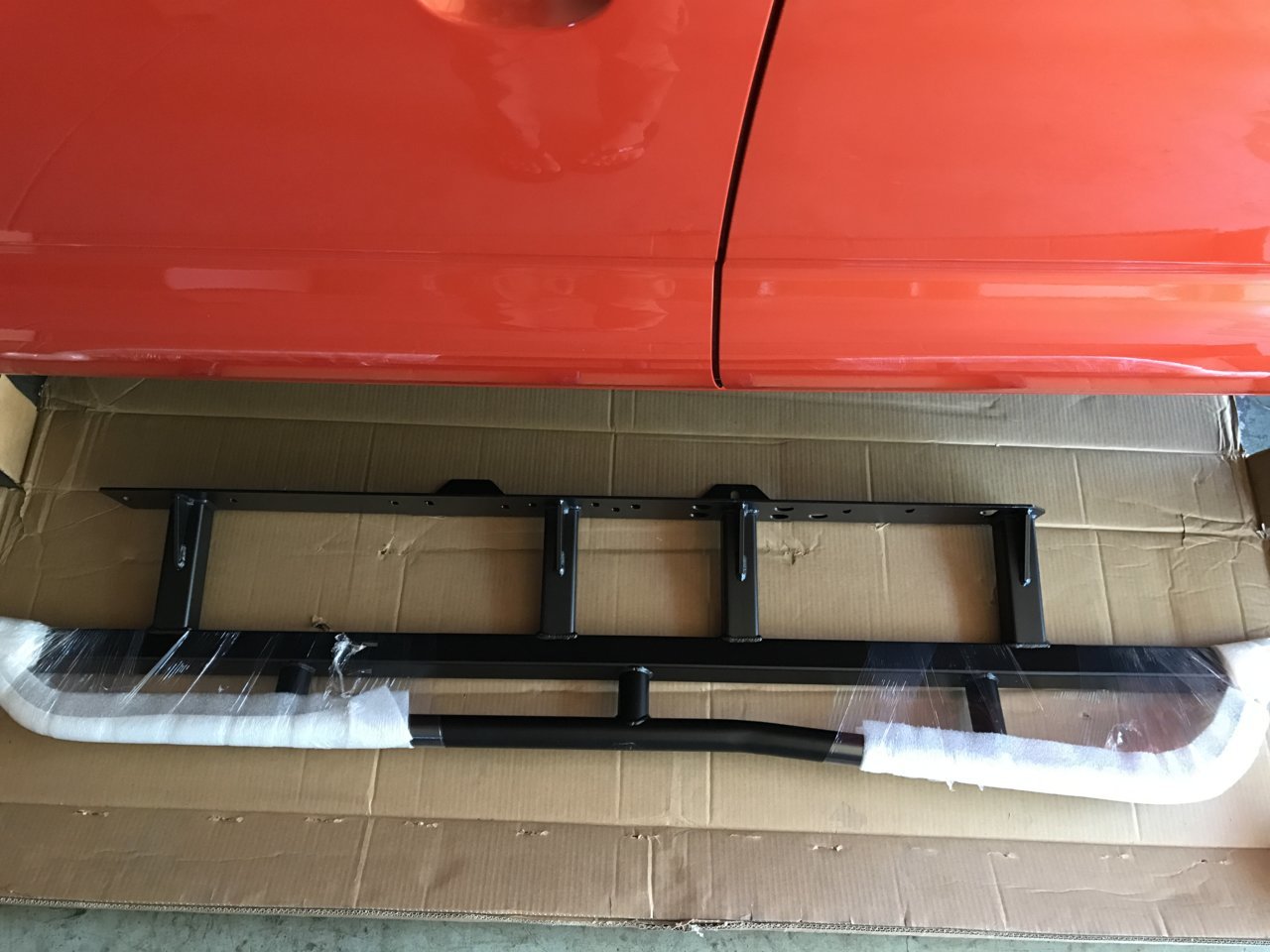

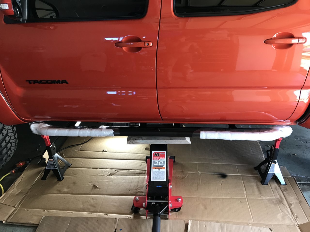

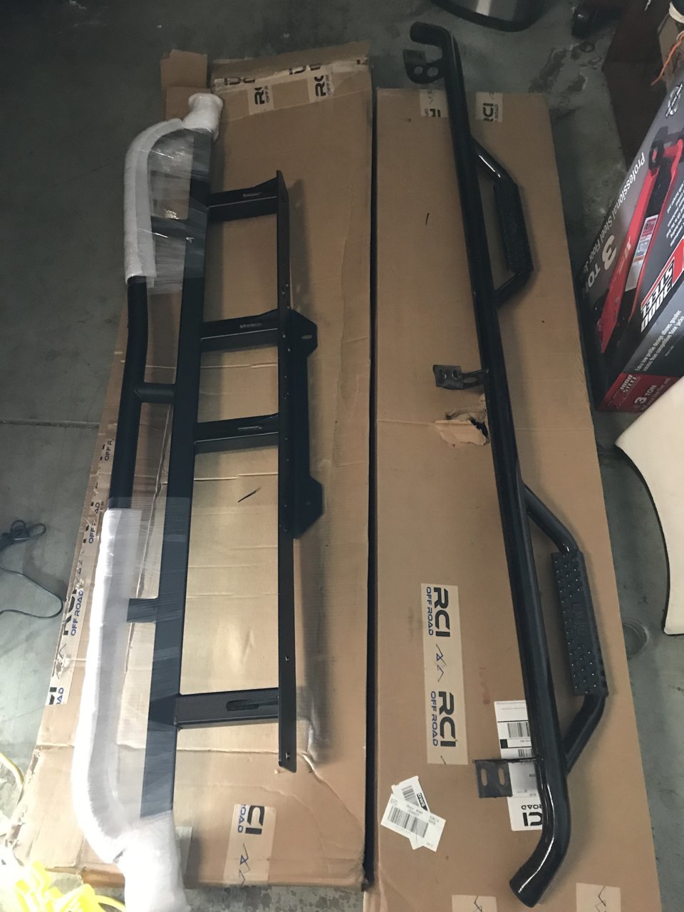

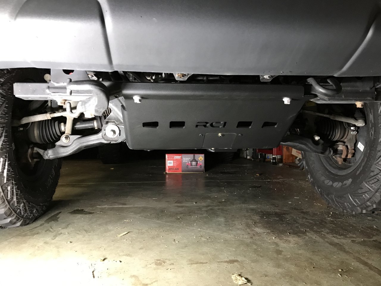

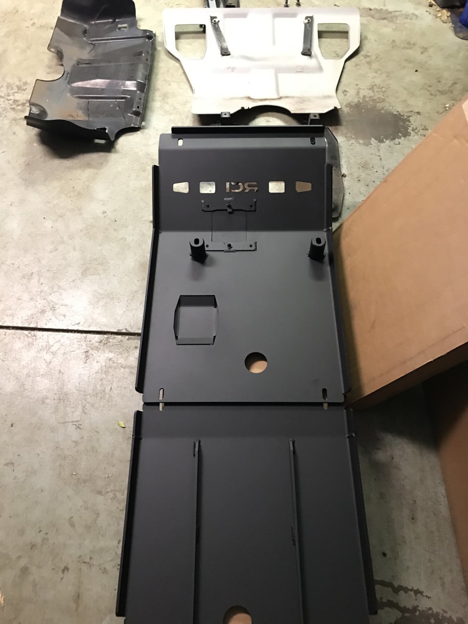

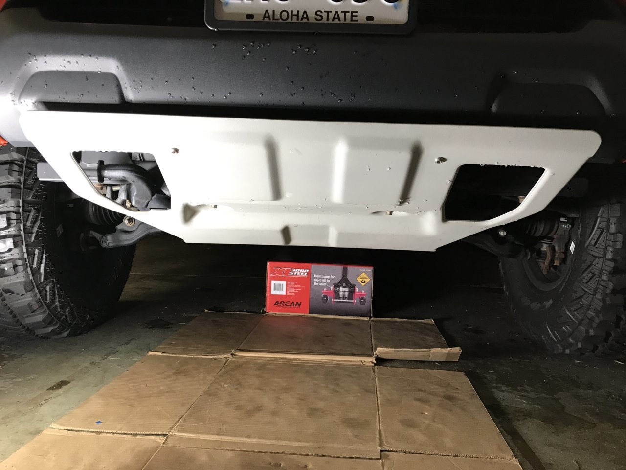

    FINALLY got some armor! Highly recommend RCI Metalworks- production time was quick, and shipping was fast as well. Got the IFS and Mid Skid on yesterday, going to install the sliders in the next few days.

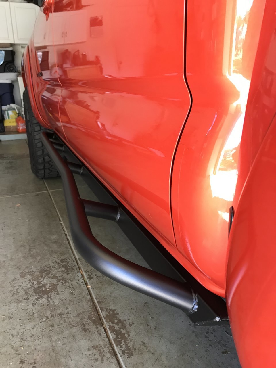

    Havent been on here in awhile... Was able to get the sliders from RCI offroad mounted! WAY beefier than the NERF steps I had F31BCB52-E54A-4E44-8821-707DE56D28F0.jpgB3DFD2E0-7CA1-4D46-AD82-FD15FDE36AEF.jpg812C98DC-AE24-494D-8035-642A8EEB0256.jpg12154FFE-8F9A-44E8-B5FA-6CD6EF596FBE.jpgF31BCB52-E54A-4E44-8821-707DE56D28F0.jpg B3DFD2E0-7CA1-4D46-AD82-FD15FDE36AEF.jpg 812C98DC-AE24-494D-8035-642A8EEB0256.jpg 12154FFE-8F9A-44E8-B5FA-6CD6EF596FBE.jpg

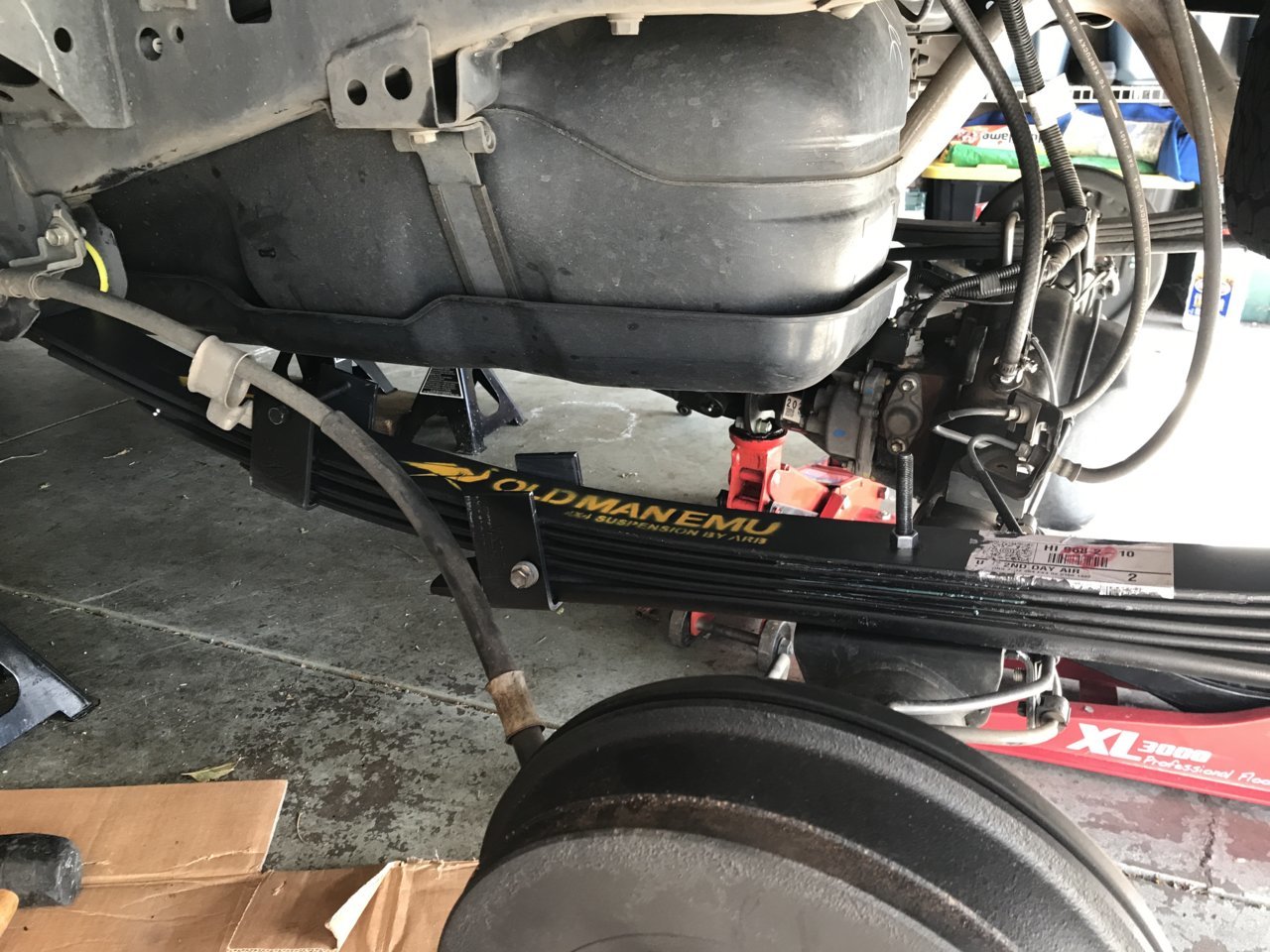

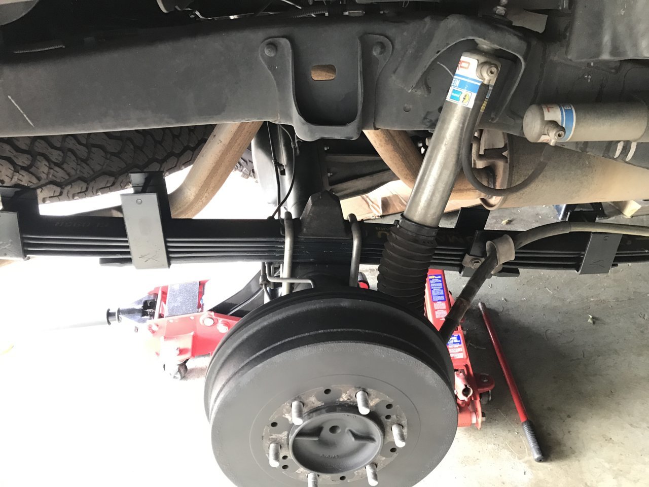

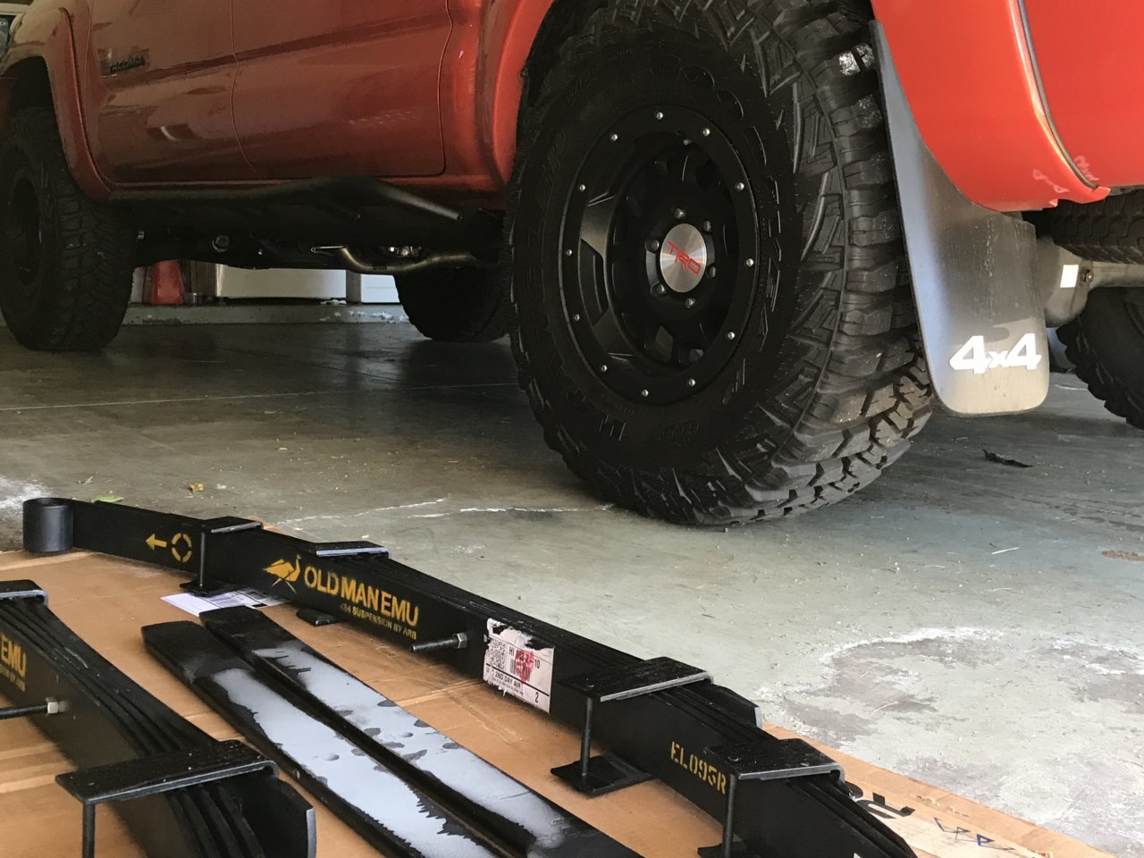

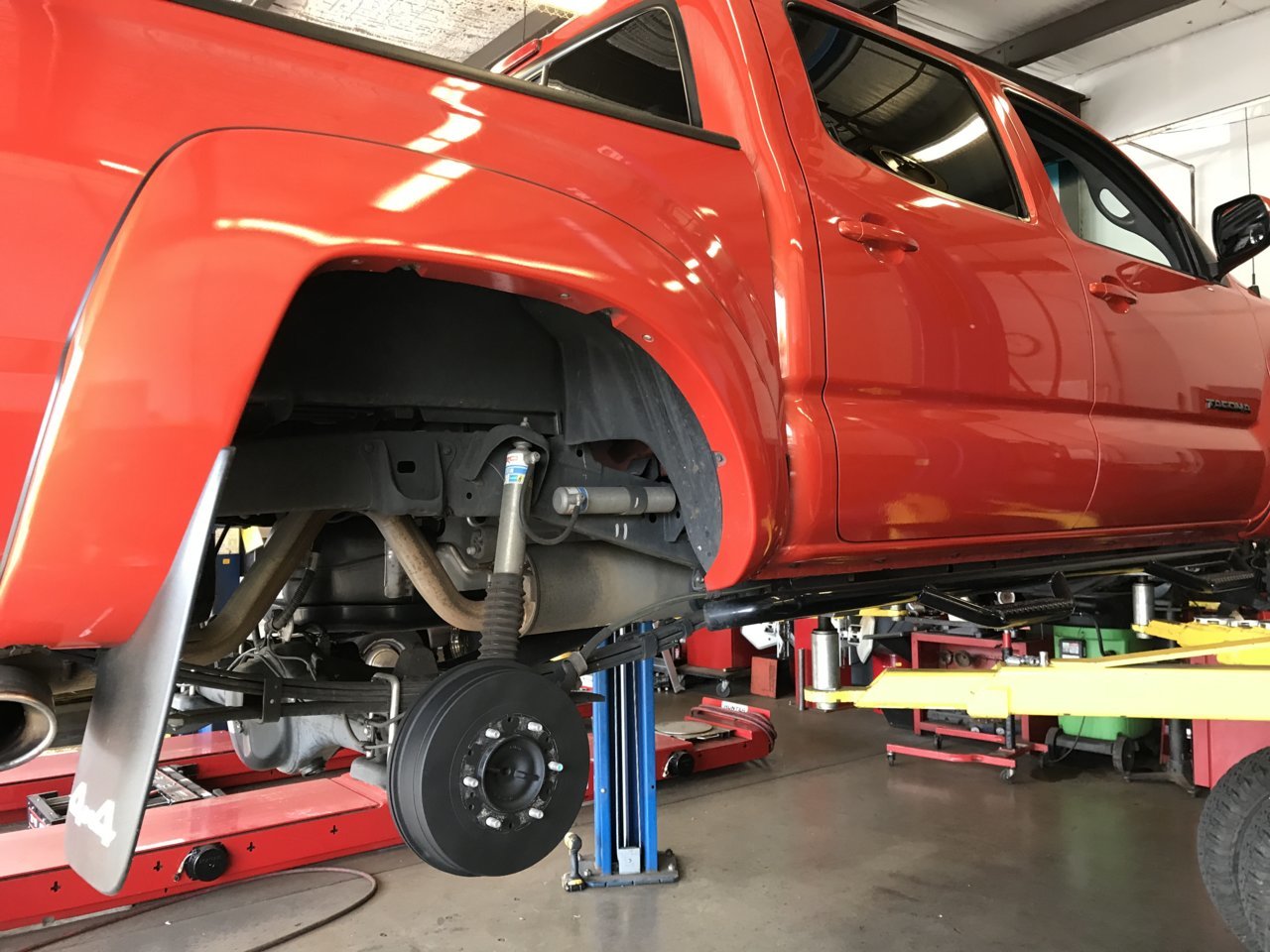

    I installed Dakar EL095R's because my TSB springs were sagging. I removed the top overload leaf expecting to gain 2" of lift (due to OME claiming 2.75" unloaded), but didn't gain anything- it's riding at stock height. I plan to put the top overload back in, which will hopefully give me an inch of total lift. Anyone else have Dakars that are "sagging"?

    Hey @TRDProBuddy. Aside from removing the mud flaps, I had to unscrew and push the front portion of the front fender liner forward and secured them with zip ties.
    Also for the front: I hammered the pinch weld flat and had to re-form the liner with a heat gun. I did NOT have to do a CMC because I'm using stock UCA's. As for spacing between the UCA and tires, I don't know the exact measurement, but there's no rubbing there at all.
    For the rear: I trimmed the fender, and the had to re-form the black fender liner with a heat gun.

    I was cruising this page and noticed you had Relentless fab quick fist mounts on the side bed rail. Seeing that your avatar is a diving one, you think those mounts could hold a speargun? I'm running Russel's KAP gun and I'm always looking for a better way to carry it. Just not sure if this thought I have would clear my Thule racks sticking down in my bed.
    SheepCatActual[OP] likes this.

    @Musubi3 Mahalos for checking my page out! Yeah, they could definitely handle a speargun; they’re strong enough. Good thing is that quick fists have an adjustable diameter, so you could use it to hold both wood and pipe spearguns. I’d make sure to use blue locktite, though, because the bolt that holds the rubber mount to the actual mount will want to loosen at times.
    I’m also unsure how they be able to mount on your rails if you have the Thule racks, maybe could mount the quickfists againt the cab portion of the bed?? Hope this helps!
