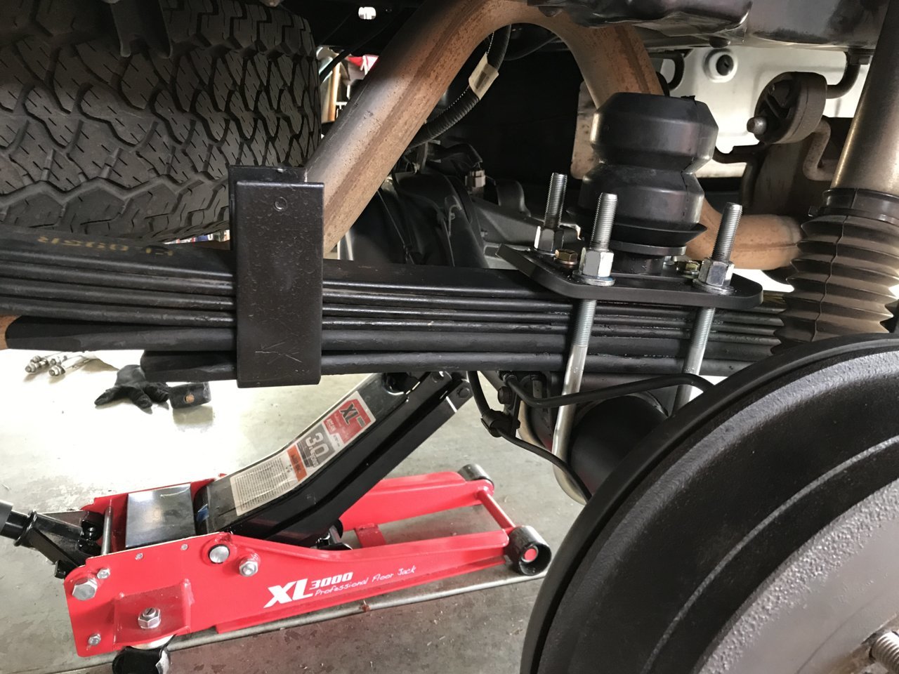

    IMG_4121.jpg Had to reinstall the top overload leaf for my DAKAR EL095R packs... I initially took it out to achieve 2" of lift to compensate for the sagging TSB packs, but gained only an inch. Once reinstalled, I gained 2" (hub to fender measurement is now 23.5"). Figured I might as well install a Timbren U-Bolt flip kit while I was at it!

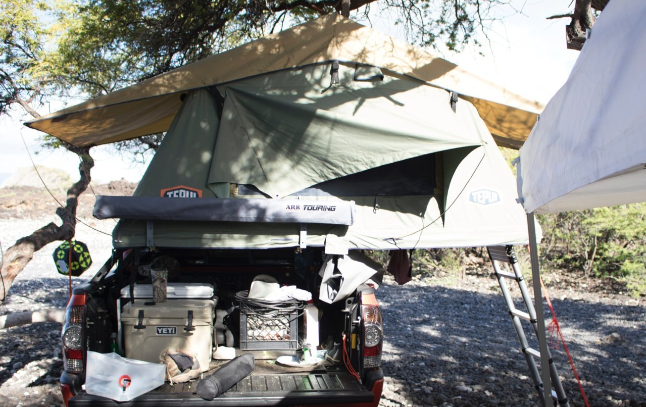

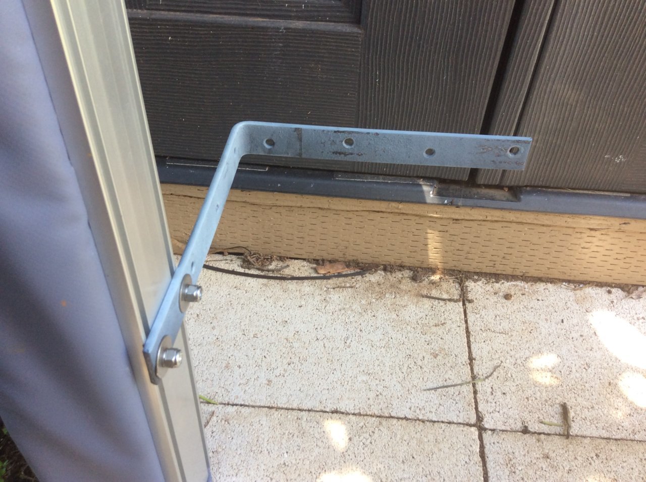

    Which awning do you have mounted, and how do you have it set up?
    SheepCatActual[OP] likes this.
  4. May 22, 2020 at 4:16 PM
    #24
    SheepCatActual
    SheepCatActual [OP] Well-Known Member
    Apr 30, 2018
    #252082
    64
    2015 INFERNO TRD PRO
    It’s the ARB 1250 (4ft) awning. I have it mounted on L brackets from Home Depot. They go flush to the bottom of my Tepui tracks, and I used RTT specific hardware to mount them to the tracks (they slip right into the tracks) for a flush install. E4D00E94-8954-4BD1-B219-C32832C2B95A.jpg3948EA44-B9B7-4407-893E-F064A152D4B8.jpg
