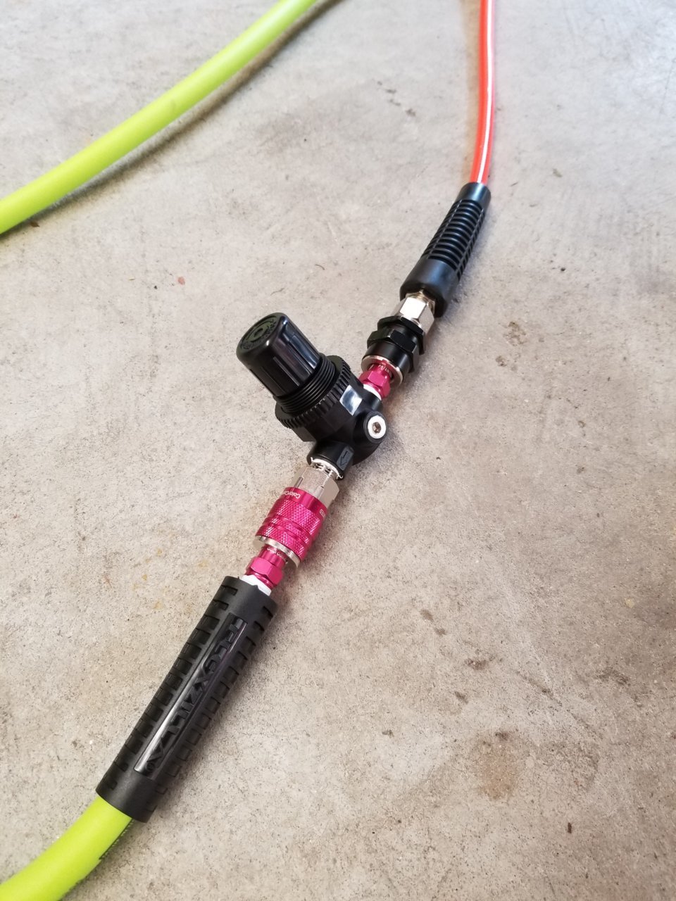

    I added a $12 regulator into my setup. It came with a gauge but I didn't attach it and plugged the gauge port. Just set the regulator so you can walk away and when the tires hit the desired pressure everything shuts off. Then just plug in your gauge and fine tune if you want. This way you don't have to hold the air gun or watch the pressure while airing up.
    https://www.amazon.com/dp/B08B8384JZ/ref=cm_sw_r_cp_apa_i_unrAFbG15BGTZ

    This is next level laziness. I’m gonna have to do this lol
