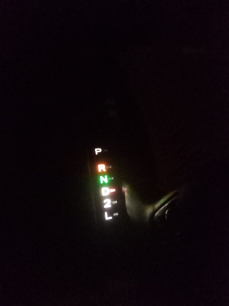

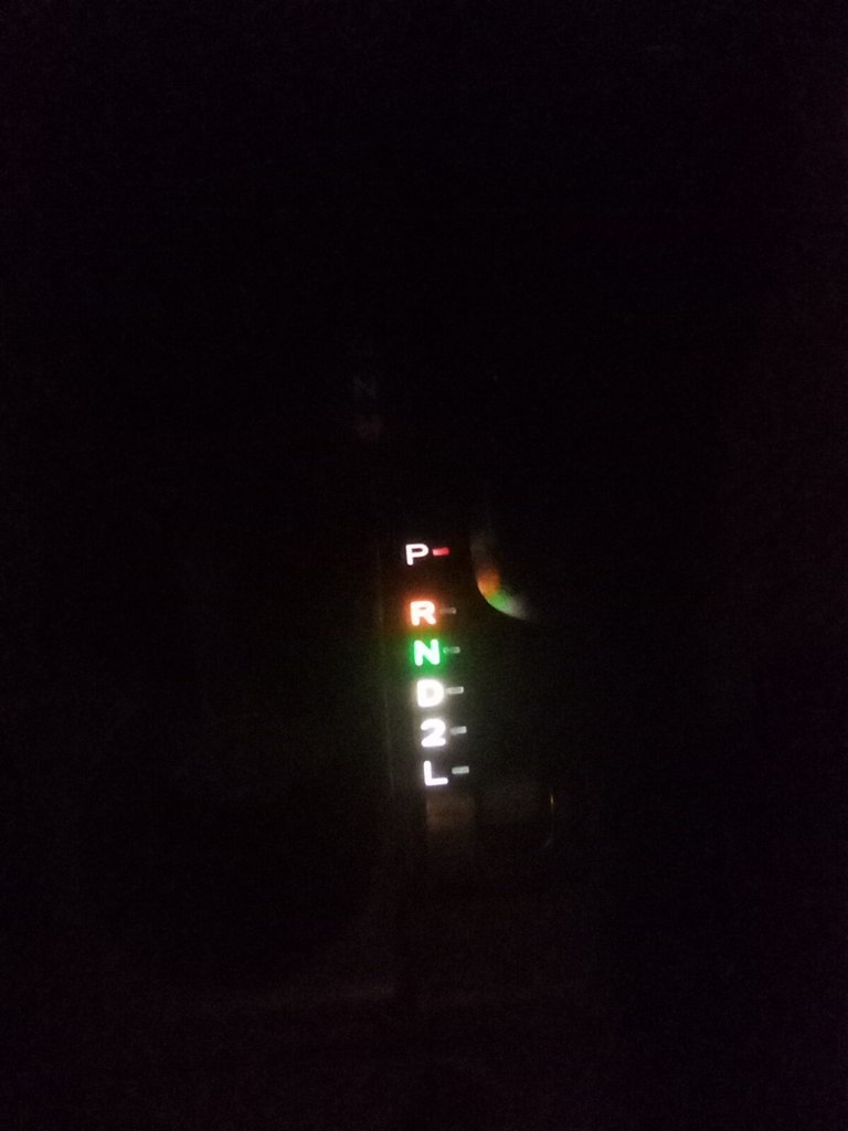

    FYI, this is how the LED bulb lights up the gear selections:
    If only I could find an LED dome light bulb that would work...
