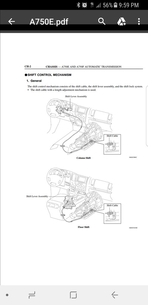

    Some
    I'm not sure if it's possible to remove just the shaft but you can replace the while part pretty easily. Maybe from a junk yard or ebay.Screenshot_20170821-215939.jpg
