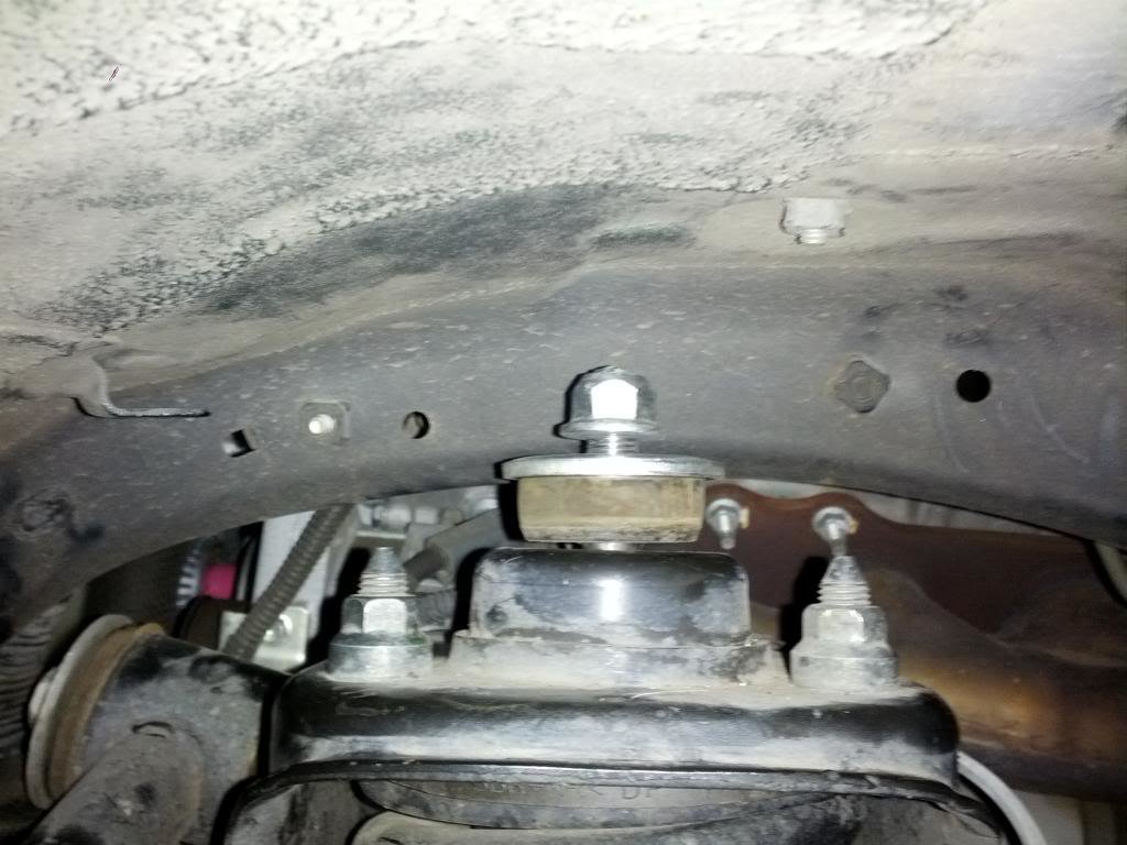

    I thought it would better to post in this then start up another, but what would one do with a 5100 and no hex bolt spot up top with the bolt maxed out and spinning. Pic included to limit confusion. Tried channel locks around the boot and around a rubber grip but no luck.
