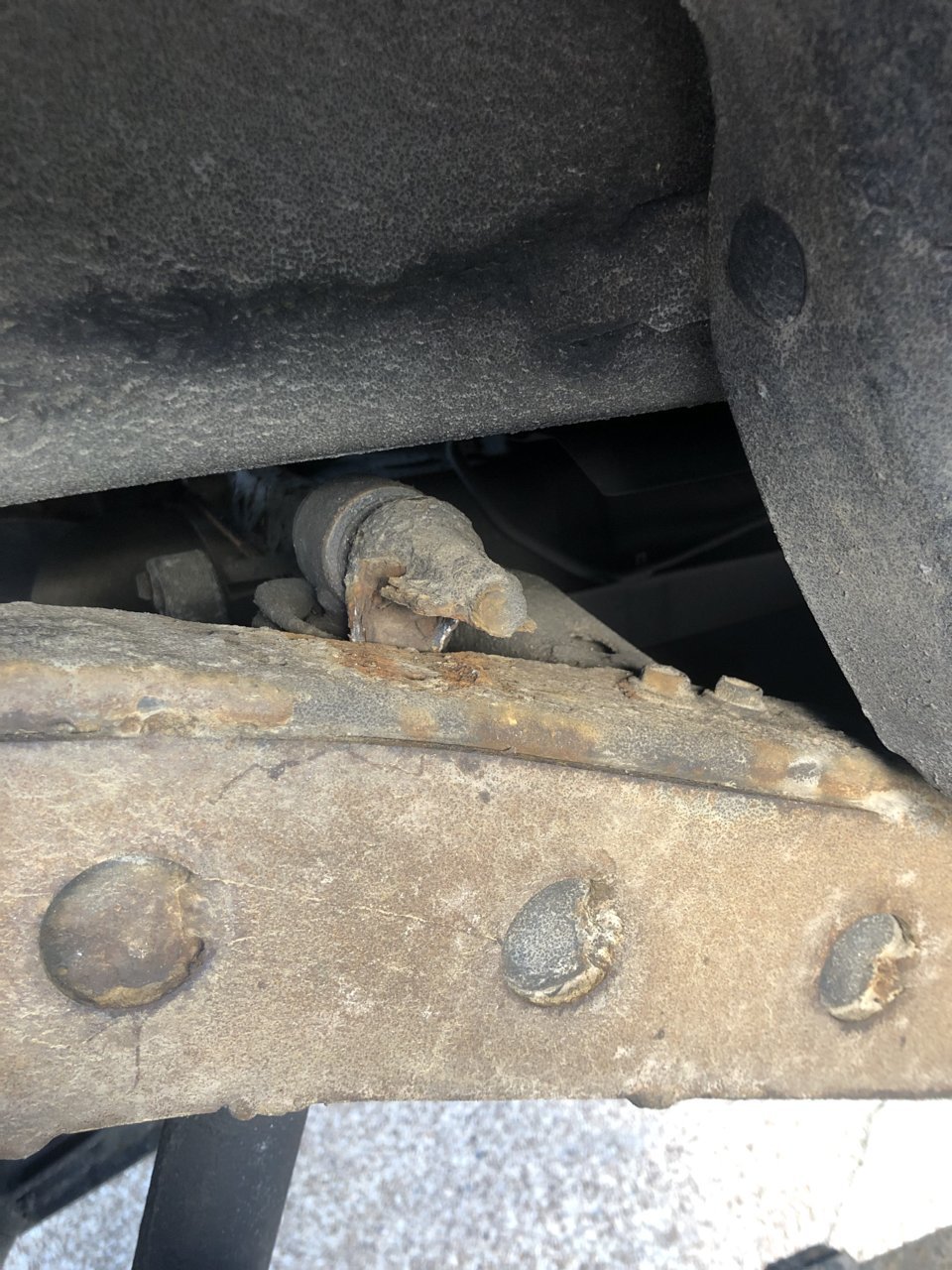

    Hi all,
    I discovered a very unpleasant surprise yesterday while driving my truck around. I heard a rattling sound coming from the rear of the truck and though it might be my U-bolts coming loose again. Well I immediately noticed my shock on the rear passenger side broken off and sticking above the frame. I got underneath and took some photos. It looks like the mount rusted through and the weld on top couldn’t hold anymore so it broke off. Some background on my truck: it’s a 2001 xtra cab TRD V6 with ~226k miles. I should also note that on either side of the frame in the rear are plates welded to the frame, kind of like those safety caps.
    I guess I’m here looking for some advice on what to do. I’m calling my mechanic tomorrow morning to have him take a look at it. She runs great and I know she’s got more life left, but I also know I have to be realistic. I don’t know how much I could get for the truck at this point and I can’t afford another vehicle right now. I also have to drive 100 miles a day to get to and from work. Has anyone had a similar experience and have some advice?
    Thanks.

    Replace the frame. That one looks shot

    Unfortunately 2001 is not covered anymore. Plus I don't think they cover modified frames.

    Fix what needs fixed!
    Get or make a new shock mount
    To bad I am on the other side of the State
    Most mechanics will run screaming and hide under the bed .
    Even getting a frame for free the cost of shipping most likely unless you have family and friends running the Southwest USA to bring it home for beer

    I’d swap a frame under it.. or rebuild the current frame

    Well your frame is clearly shot. That big plate is what's kept it going & if you can't afford a new truck, that plate will be your stop gap. A clever welder will be able to patch your shock back on. But it will be temporary, just buying you some time to save up. Some good options linked by earlier posters. Also, if you could find a crashed truck w/ good frame you could use your truck to fix the other - might be cheapest route long term. Good Luck.

    Provided of course there is something left to weld the shock mount to ;) .

    Thanks for all of the responses guys, I appreciate it. I knew it was as bad as it looked but I didn’t want to admit it. We’ll see what my mechanic says tomorrow but if I can’t get the frame repaired by a welder then selling it is probably my only option. I can’t afford to buy and have a new frame installed unfortunately :( I just don’t have the time or resources/money. I’ve got some thinking to do.

    Update:
    My mechanic recommended a local shop to take a look at my truck and they were able to repair it! The mechanic said i “would have to do something pretty heroic” to break it again. I’m very happy and looking forward to many more miles in my truck. And to top it off, I went to fill up afterwards and the pump shut off at exactly $34.00. My lucky day!
