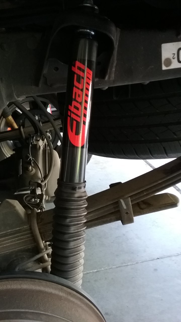

    40,279
    USA
    Very smooth. Much better than the OE Bilsteins ever were. These are the Pro Truck OE replacements....not the Pro Truck Sport for lifted rigs.
