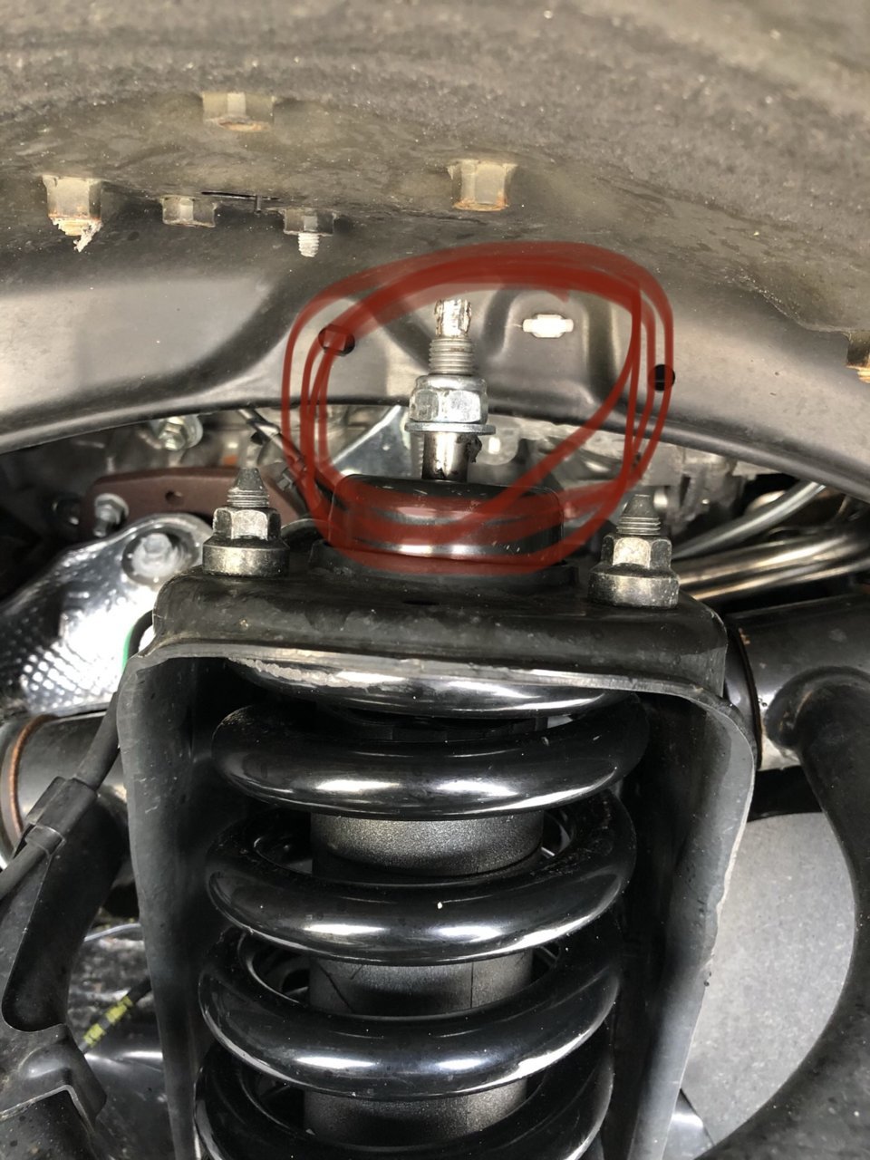

    I recently got an EMU lift installed. Issue is after lift was installed I hear a clunk when I hit bumps on passenger side.
    I noticed that on the passenger side shock there is piece that seems to be missing up top. now Excuse my lack of experience and knowledge. Can someone tell me if this part missing is a bushing or mount. Or if this is even the cause of this “clunk” before I go back to the shop and complain.

    Yes, you're missing a bushing and the washer. Head back to the installer immediately. That is a HUGE oversight.

    That would be it. Hopefully it’s not bent now

    It will a bitch to get that nut off now. I'm sure all of the forces applied to it has seized it to the threads

    Thank You, hopefully it’s not, I’ve only had it for 3 days on pavement, heading over to the shop this second.

    I'd highly recommend a replacement of that coilover... Or a damn good EXTENDED warranty. It's hard to know what kind of damage may have occurred.

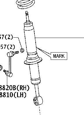

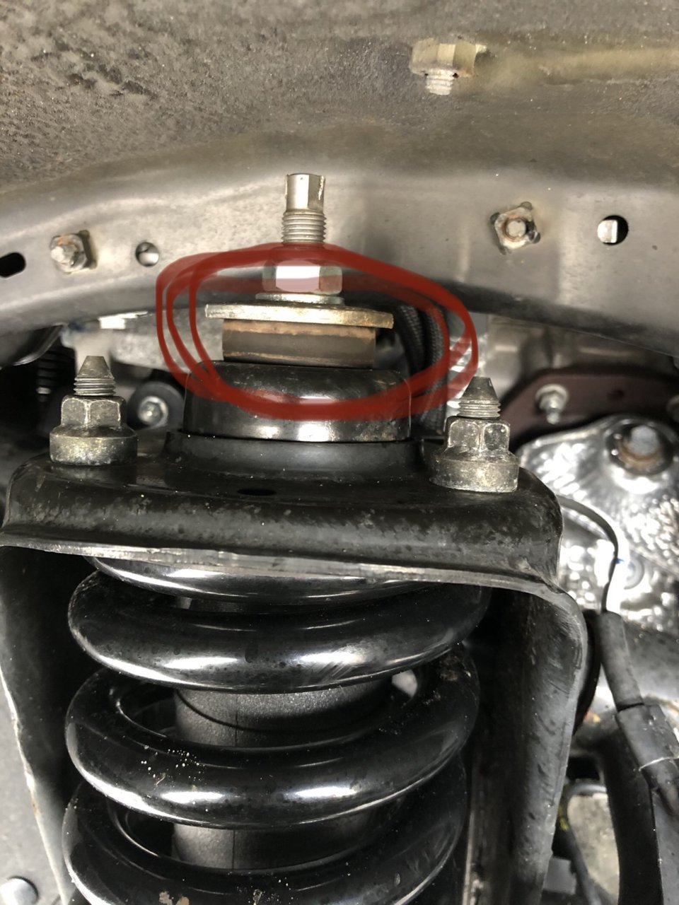

    Looks like there's a bit of rubber chunks still left on the shock shaft. My bet is they completely forgot to put on the metal washers and the first bump you hit destroyed and launched the rubber bushing. Here's a photo from a Toyota parts website, part orientations are the same. You'll need the metal washers and the rubber bushing. You have only driven it for a few days so the top hat SHOULD be fine but at this point I would definitely tell them you want to inspect the top hat when they remove it. If the hole is no longer round and is oblong I would have them replace it on their dime. Like @Bertw192 said, you might even want to push for them to replace the coilover as a whole on their dime. Or a written promise that they will replace it if it fails in a short period of time.
    Red = metal washers
    blue = rubber bushing
    JaCado, jmneill, shakerhood and 2 others like this.

    Welp, that's the end of that thread. That's the most comprehensive answer that OP is going to get. Now time to let this thread devolve into the typical 3rd gen madness.
    Let me start... Why is the shock yelling at Mark? Did he do the install?
