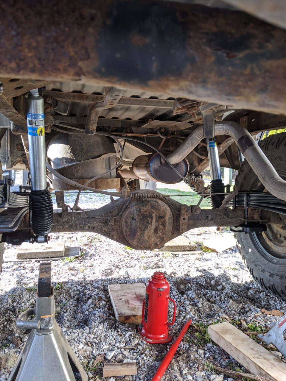

    Here's the rear of my truck with extended bump stops and a 2" lift.
