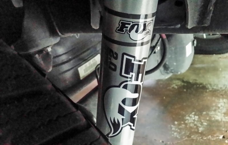

    18" tires and rims, 2.75" Procomp lift, Fox shocks in rear.
    OK, I'm reporting back on the rear Fox shocks install. One word -- WOW!!! Feels like a totally different truck. I'm gliding over speed bumps like a ballerina.
