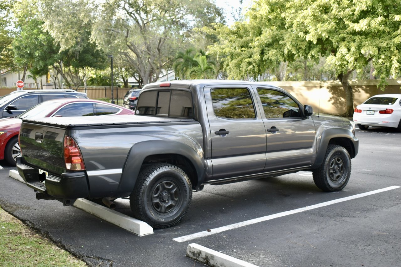

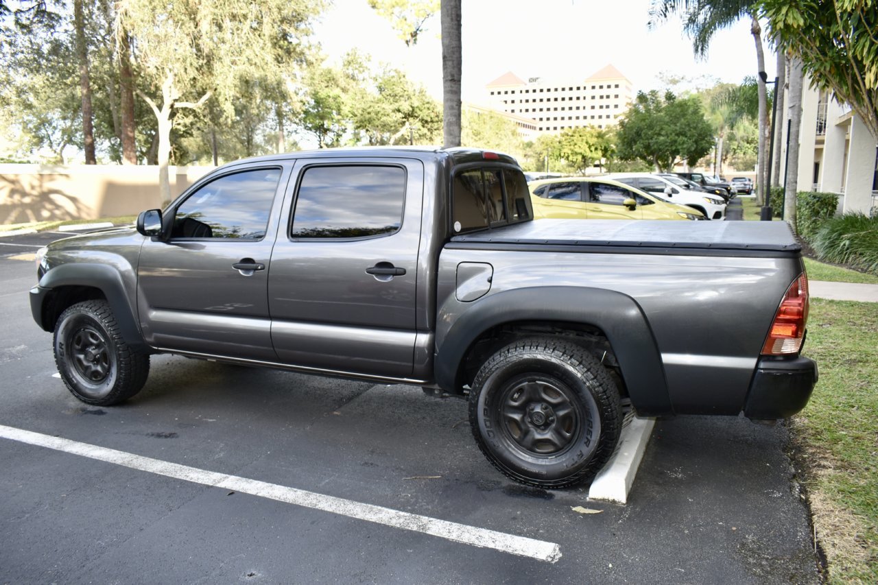

  12. May 25, 2022 at 10:48 AM
    #52
    econdor031
    econdor031 Member
    Apr 23, 2014
    #128306
    19
    Eric
    Miami, FL
    2014 2.7L Double Cab 165k miles
