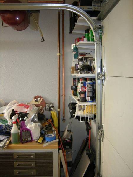

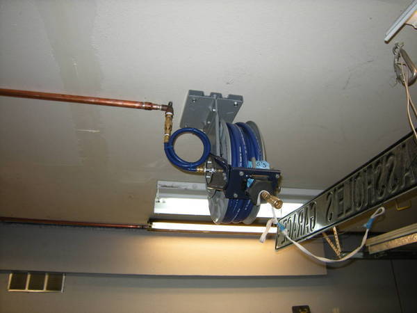

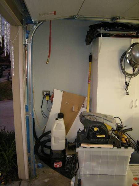

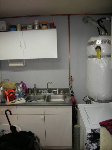

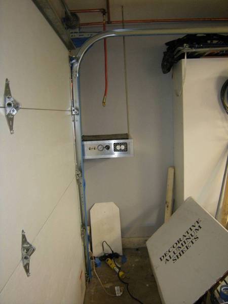

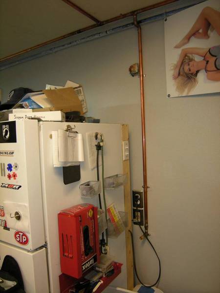

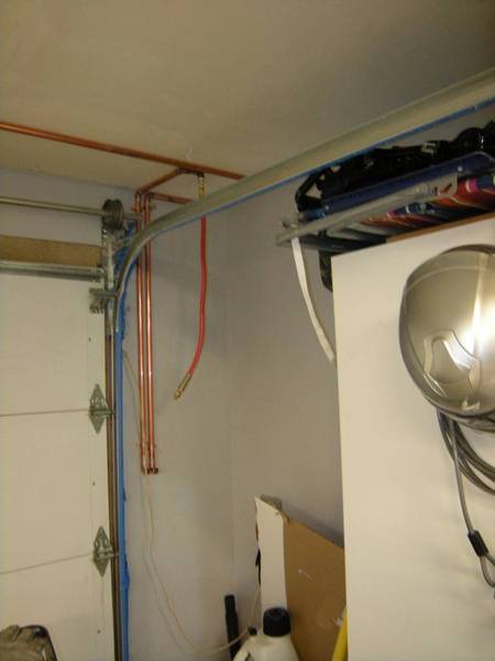

    Here are a few shots of what I have done & am working on in the garage & a shot of the Wifes car which is going to be another build & of course had to squeeze in a couple of pics of my Baby's. Pretty much adding air lines around the gaage for the compressor. 3/4" copper around the perimeter of the ceiling with drops here at there. Shortly I'll be hanging steel peg board & a surface mount drop ceiling to conceal the copper pipe.
    The Wife got me this sign
    Had to hang a air reel
    Drop next to the spray booth
    Drop next to the work bench (It's a mess right now.
    Air drop next to sink that I also installed in the garage
    Air supply from where the compressor will be. It's going to be up on a shelf
    I have to know what day it is when I'm in the garage
    Spray booth next to the beer fridge
    Another shot of the corner where the compressor will be
    Have to have nice things in the garage to look at
    Haha, The Wife's XB which is going to be another build of mine.
    My Baby's. 05 Yamaha FJR1300 in front of the Tacoma
    Another shot of the truck & FJR

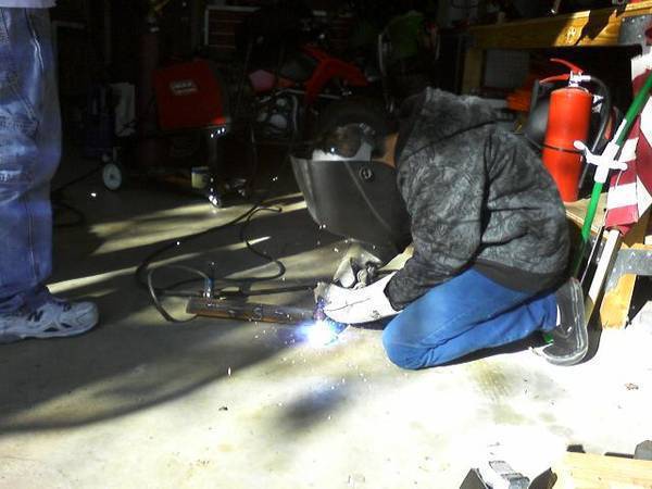

    Proud moment. 12 year old son learning how to weld last weekend

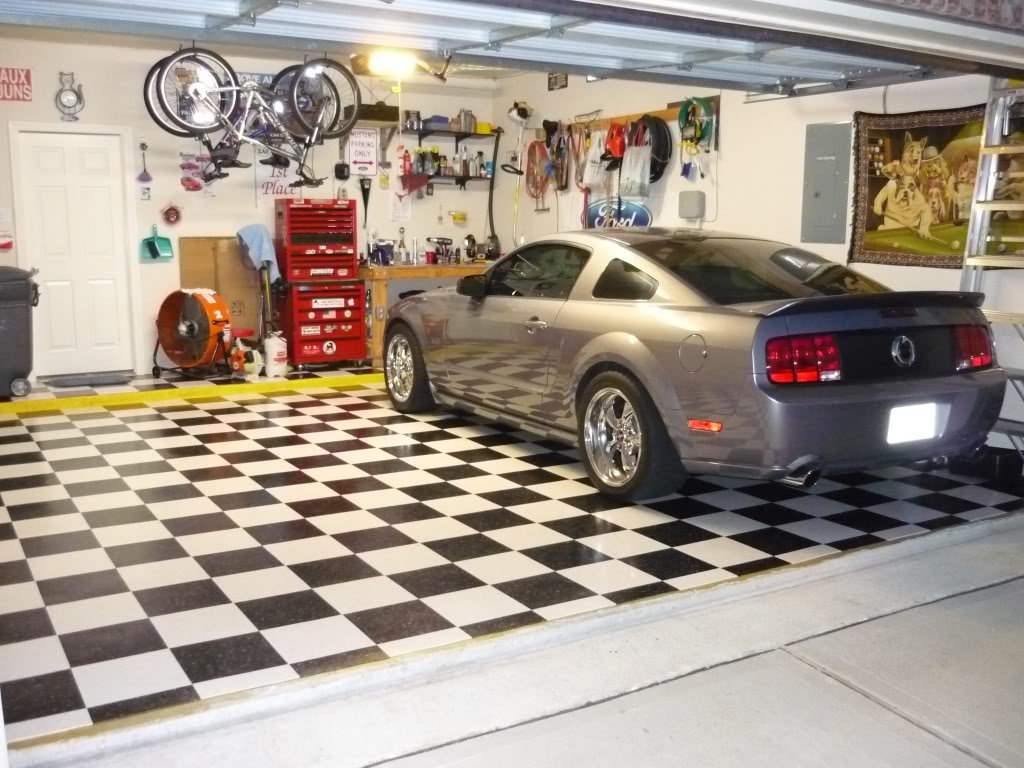

    Here is my garage at my previous house. I will be doing the flooring and some 'mods' to my new garage in the next few weeks so I'll try to snap some pics of the progress.
    Cool thread!

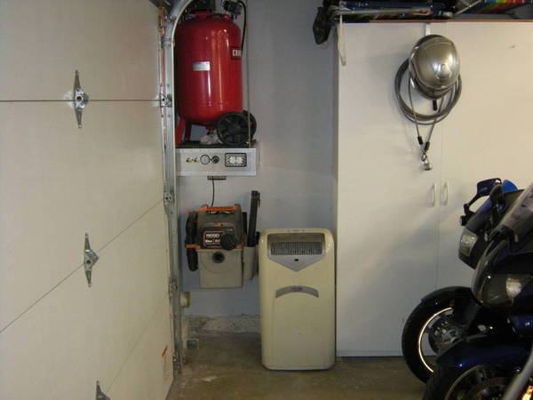

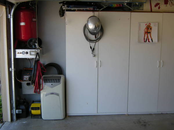

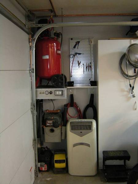

    Sneak peak of the compressor shelf I built for the corner of the garage. Need to do a couple things to it then put the compressor up on it.
  8. Dec 27, 2011 at 8:38 AM
    Steve J
    Steve J [OP] Steve J
    Sep 28, 2011
    #64261
    516
    Steve
    Canyon Country Ca
    12 Access Cab 4x2
    Avid front light bar, Avid bolt on sliders, Avid rear bumper protector, T-Rex grill & bumper insert. Still lots to do though.

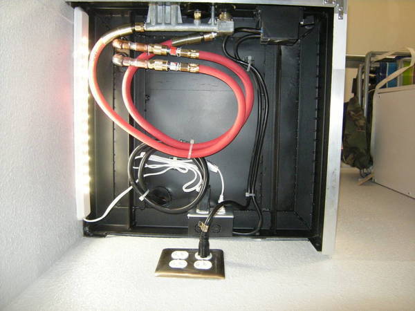

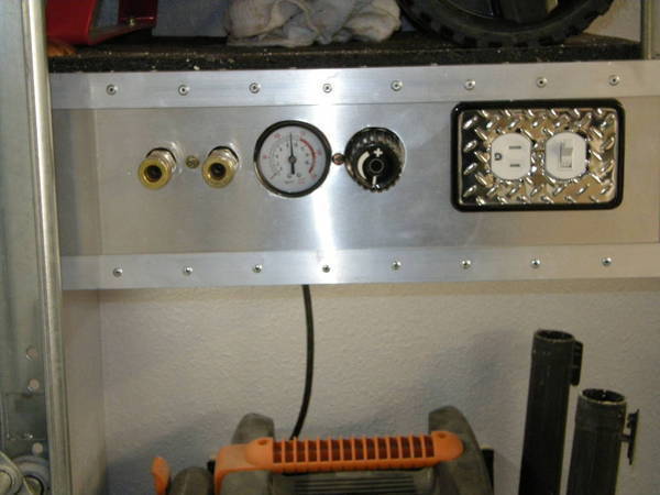

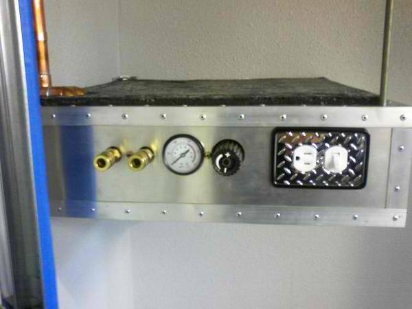

    Up date of Garage/Shop Build Compressor shelf
    Before
    Progress
    Organizing
    Done
    Close up of controls
    Under side LED lights that are on when the compressor is & a look at the wiring & hose layout.[​IMG]

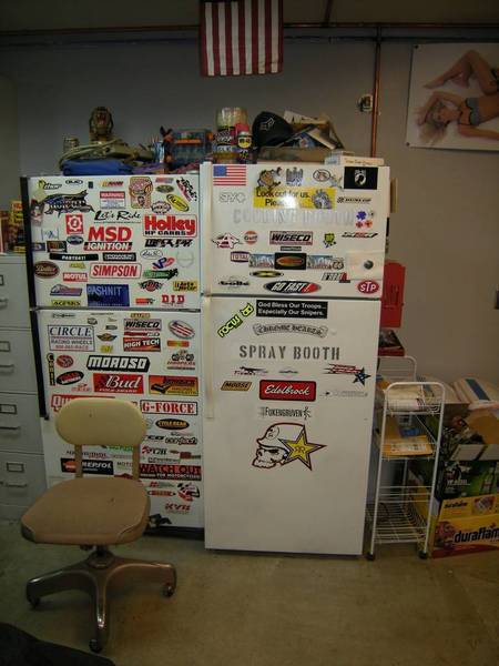

    I already have a power reel on the ceiling. It's yellow & black. I dropped in all sorts of outlets a while back & have one behind next to the spraybooth/fridge. I converted an old (FREE) fridge to a spray booth. I gutted the motor & everything else & put some filtered exhaust fans in the back & some hanging rods inside. The freezer freezer portion is a cooling booth that I cut in a filtered intake & exhaust fan for cooling the parts. BTW, it's for small parts that I powder coat. That was one of the main reasons for the air compressor lines with a drop right next to the spray booth.
  10. Dec 27, 2011 at 9:03 AM
    Steve J
    Sep 28, 2011
    #64261
    516
    Steve
    Canyon Country Ca
    12 Access Cab 4x2
    I left the plastic walls & back with the insulation. The doors I reskined with aluminum inside but left the insulation. The shelves were getting in the way.

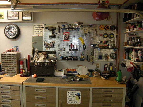

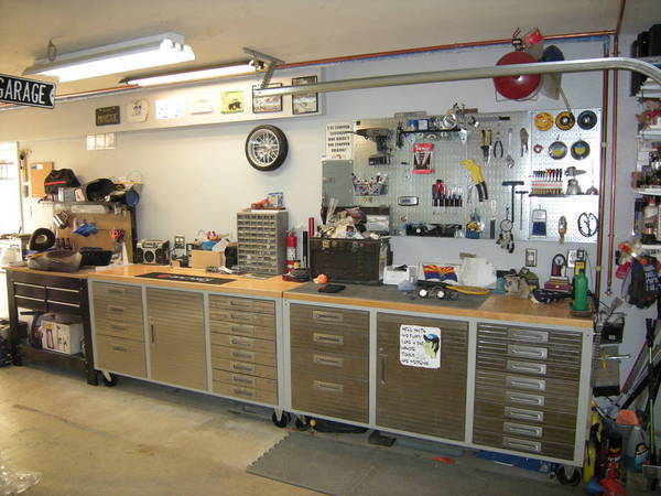

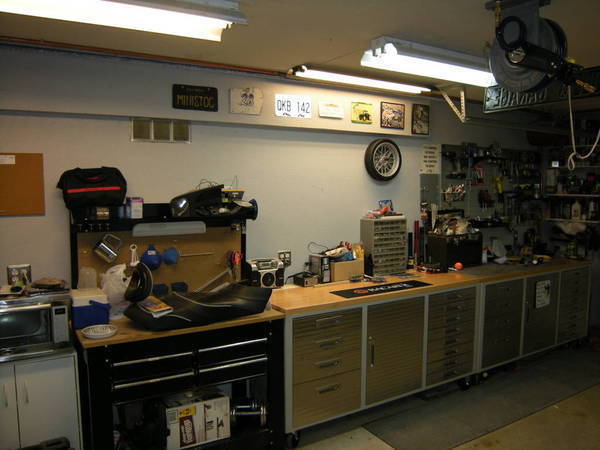

    So, I have been putting some more $ in to the garage & a lot of time. It's coming along. I still have more organizing to do. It's still a work in progress though.
    Steel peg board & a shelf next to the compressor
    Just picked up a 2nd work bench to match the other one & got some steel peg board above the 1st one.
    Shot of the steel peg board
    From the other end of the garage
    Still have the ceiling & the floor to do, but it's all coming together. Once I finish the garage I can really concentrate on putting some $ in to the truck.
