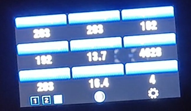

    No issues with vibrations. But you are comparing apples to oranges. A steel Tom Woods vs a custom made, all thick walled 4" aluminum. I have 4.56 gears, so once I hit about 85-90 it shifts down to 5th gear. at about 100 it drops down to 4th and gear and the RPMs start to get up there.

    Yeah.
    You shouldn't be driving a 6" lifted truck at 100mph and need to get a new phone. :D

    Driveshaft speed is always a constant multiple of wheel speed. It doesn't change with transmission gearing or rpms.
    Steel Tom Woods driveshaft is also thick walled. However, yours being larger diameter probably helps.
