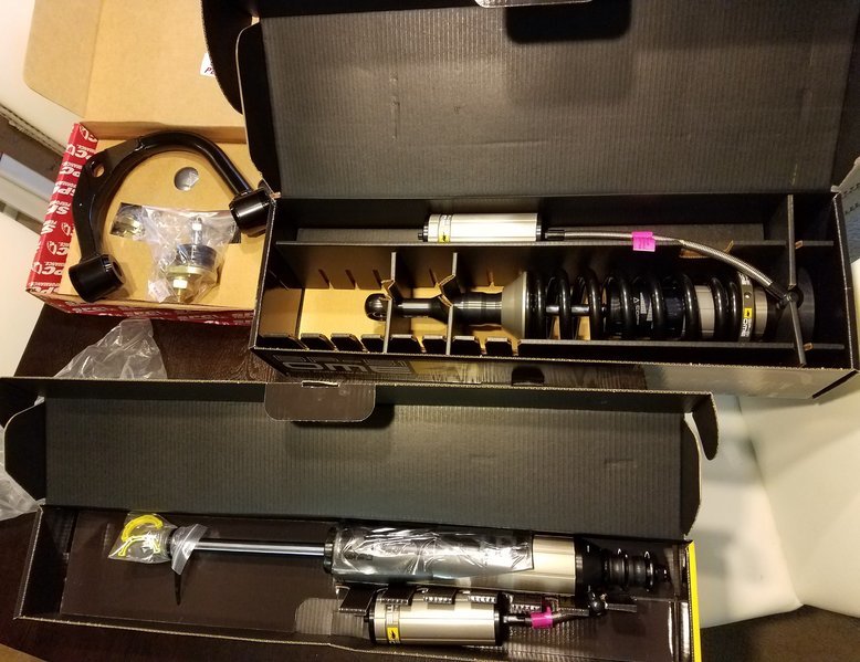

    Lift just came in, I am going to try mouse007's trick with the dealer if the vibes show up. Thanks for the tip!
    TAC1 and mouse007 like this.

    @spilser WOW...!!! Nice set up, the BP-51's are amazing. I have a few buddy's running them, I'm sure you'll be very pleased.
