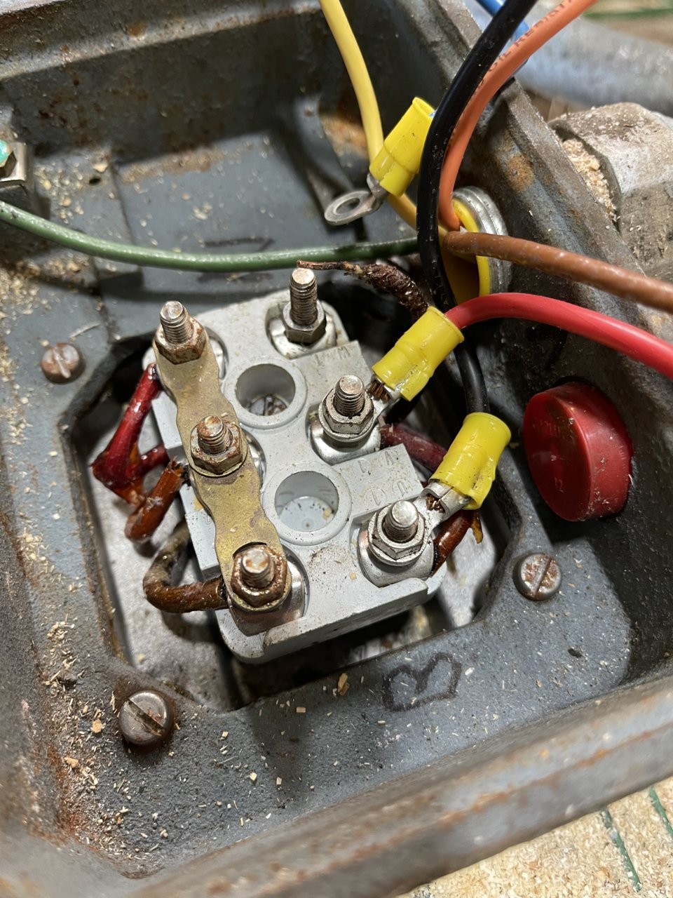

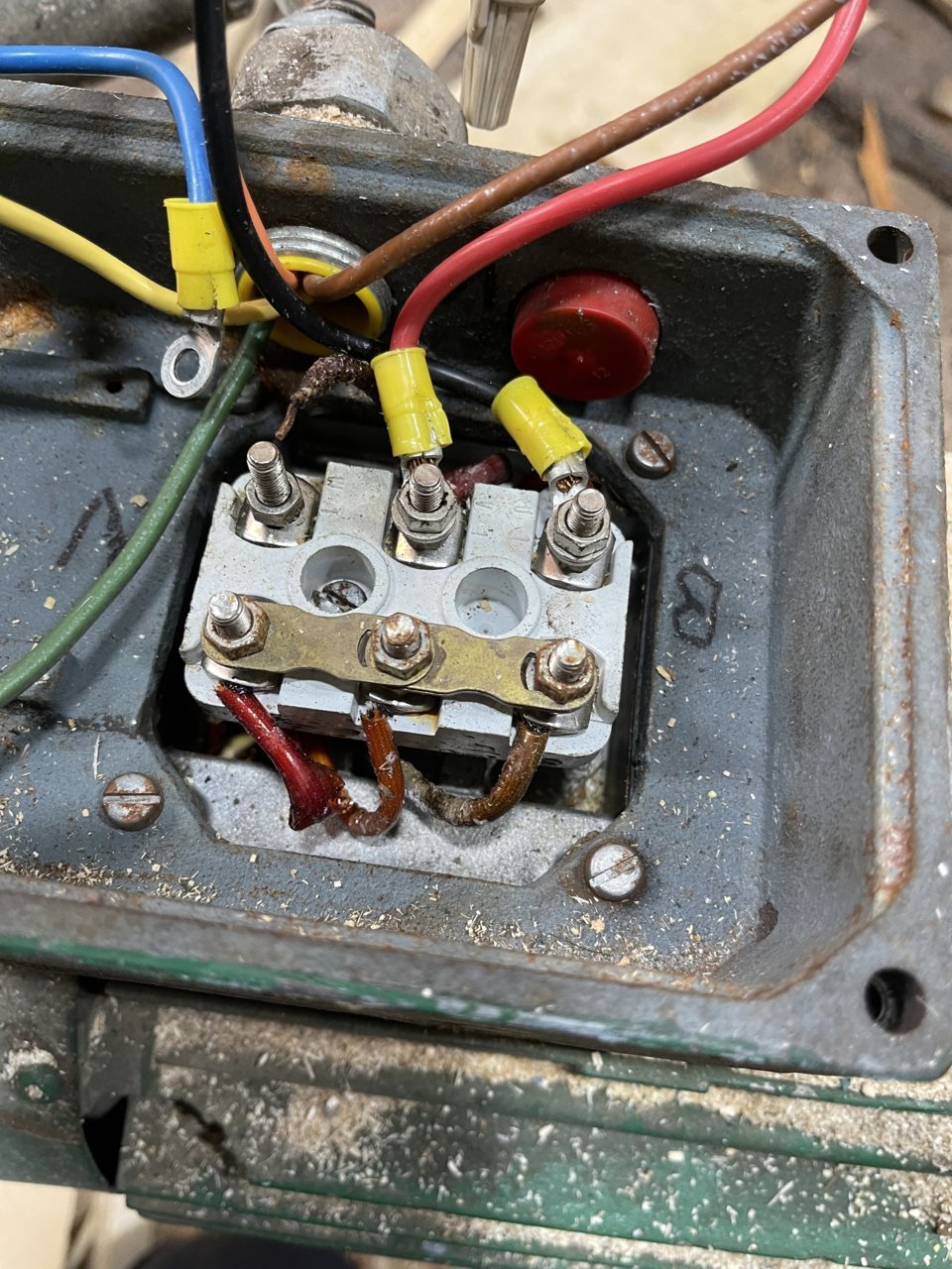

    Got called out to one of our deck drives to troubleshoot a constant fault. Pulled the peckerhead cover off and found the wire on the left loose and wobbly. This motor is probably 15-20 years old at least, and the leads are starting to look a bit crispy. EAEC602D-FF6D-4724-B381-47937569738D.jpg22000E1D-8F03-411C-8CC4-1199D066CCBB.jpg

    Why is the tie bar on the other side connecting all 3 wires together?
    I'm no electrician.

    3 phase convertible voltage motor. Operates on 230 or 460 volts.

    Wired for "low" voltage. We always use the 4-7, 5-8, 6-9 configuration where I work.
