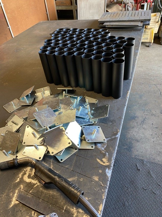

    going to be fun!
    Taliban mortar tubes?

    2-stroke or 4-stroke motors? :laughing:

    damn auto correct mortar tubes
