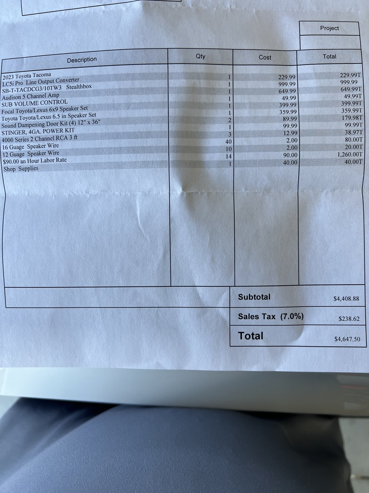

    This was my quote from the shop

    There is soooo much to audio and everyone's ears are different. But to me, based on the equipment listed that system is not worth anywhere near $4600. It will be an upgrade, but not a 4 stacks upgrade.
    I'm a little over $5000 into mine with Focal Flax components, JL VXi amp, JL Stealthbox, a Pioneer WC6600NEX (w/ wireless AA), and a fully deadened cabin with Second Skin deadening & thermal insulation. Factoring in labor though, that price isn't terrible as I spent a good 50+ hours over 3 weeks redoing my system (which at their rate comes out to $4500 in labor itself). That included building an amp rack, running all new wiring from KnuKonceptz and hiding everything and keeping all factory panels. Visually, nothing really looks modified either which is my style. I have a serious problem with spending money on labor for something I can do better myself though.
    I love Focal, but not necessarily those quoted Focals as they're moreso designed to be pnp with a factory setup. You can amp them but the clarity just isn't there compared to their higher end offerings. IMO, if you're amping it would sound much better if you swapped those speakers with Kappas, and it would be a little less than you're paying now. I really just don't like paying for labor, and if you're already considering doing it yourself, just do it yourself.
    The Focal DFS you linked are really good (I had them in my tC) but you'd be happier getting the Slate Fiber's and make sure you match the rear speaker product line to the front to keep the tones all the same. Some don't like having rear speakers at all in this truck, but I always love quality rear fill with separate tweeters. Due to the design of this truck and the rear speaker locations though, expect to run the rears much higher than the fonts to keep the sound levels balanced.

    As for the quote they gave you, it's actually not unreasonable. $90/hr for labor is pretty good if they do good work. Not a huge markup on the product either. Still too rich for my blood, considering the work isn't super hard if you have a garage and can spare the truck being taken apart for the weekend.

    I'm automatically suspicious of any 'professional' who uses the word dampening

    curious hill to die on critiquing a job position that generally doesn't require any college, doesn't pay more than $15-25/hr typically, usually lacks benefits packages, and has extremely lax certification standards( i once asked my local shops about MECA certification, and they all laughed).
    while not correct, substituting 'damping' for 'dampening' entered common language around the 90's at the latest, so is very well accepted as a colloquial term.
    alternately, i've known 'professionals' in other tightly regulated industries that require near-decades of training, college classes, as well as annual certifications, making more in minutes than i do in a year, and speak far worse. one opened email communications with 'bro', when discussing renovations on his 3rd private vacation property.

    Yeah dampening, damping, deadening, panel covering, it’s all interchangeable.
    Butt connectors, barrel connectors, butt splices, all the same thing.
