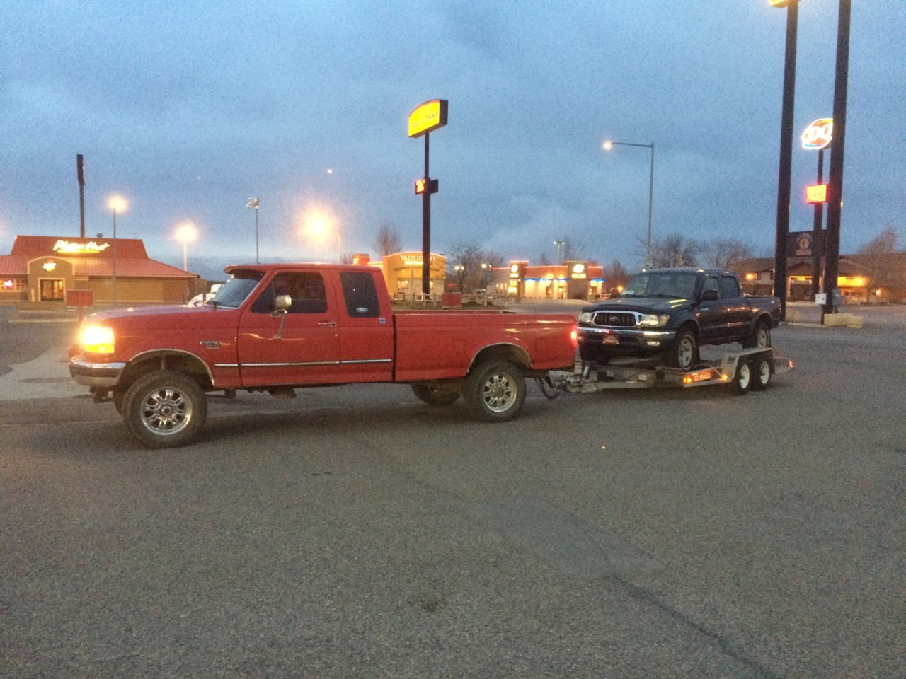

    If buying new, the only two I'd consider are the Ford and Chevy, the emissions equipment on the new 2013+ Cummins are very problematic of the three trucks and it negates all the mileage benefits that used to come with the inline six diesel. If buying old any pre-2007 Cummins or a 1994-2001 7.3 Powerstroke would be my choice. The problem with the 2002-2003 7.3 is the piston rods were made with softer, powdered metal instead of forged steel, making them a weak point if you decide to add HP, but are not a concern if you leave it stock. I have a 1997 7.3 and have nothing but good to say about it's reliability and that retro OBS look is a nice touch. It's a bit rough around the edges and rides like an old hay wagon, but runs like a champ! I'd also only consider a manual transmission on the older Ford and Dodge's as the autos of those eras were very lacking in durability as they were originally from gas engine applications and couldn't handle the torque of a diesel very well, especially if abused and towed with often.

    Actually used it to bring the 04 home after I bought it!
