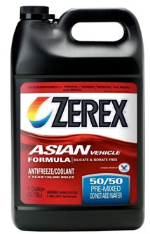

    I've used the Zerex Asian Formula in my '03 Tacoma 3.4. I purchased from Napa.

    that's what I used on my flush and fill. after 25k miles it still looks the same nice and pink. No issue whats so ever.
