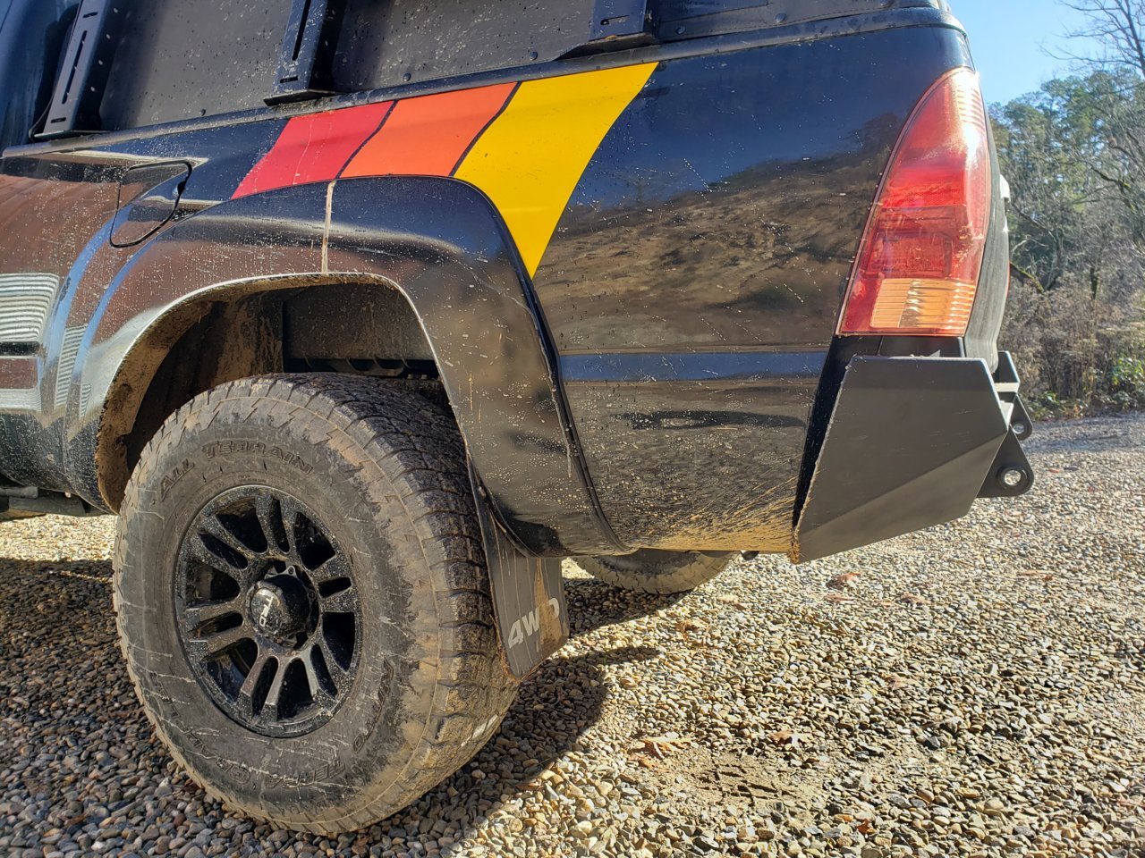

    Don't remember exactly how much I trimmed off the factory flaps-it was a lot- but I am 1/2 below the center of the wheel, front and rear (2 1/2 inch lift front 3" rear on 255/85 r 16). Lots more rocks hitting below the doors and you can see from this image how the mud sprays up. Easy mod and very glad I did it.

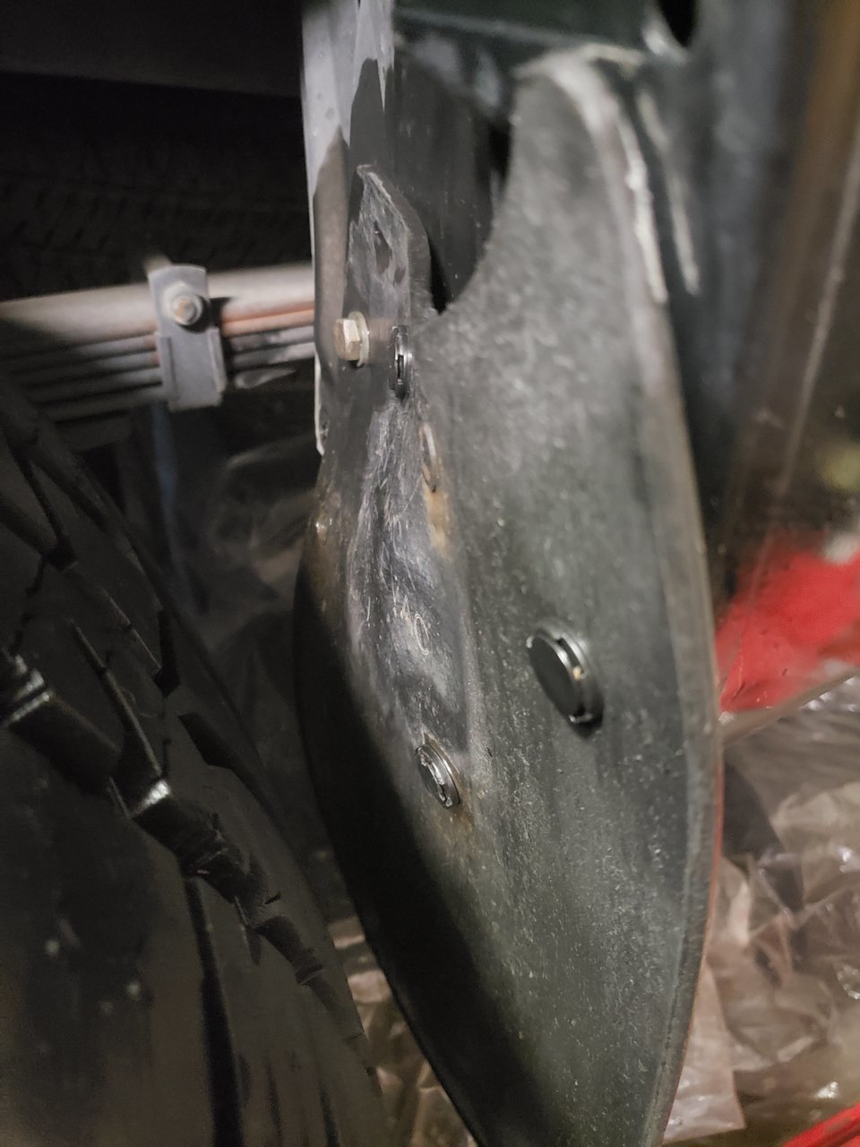

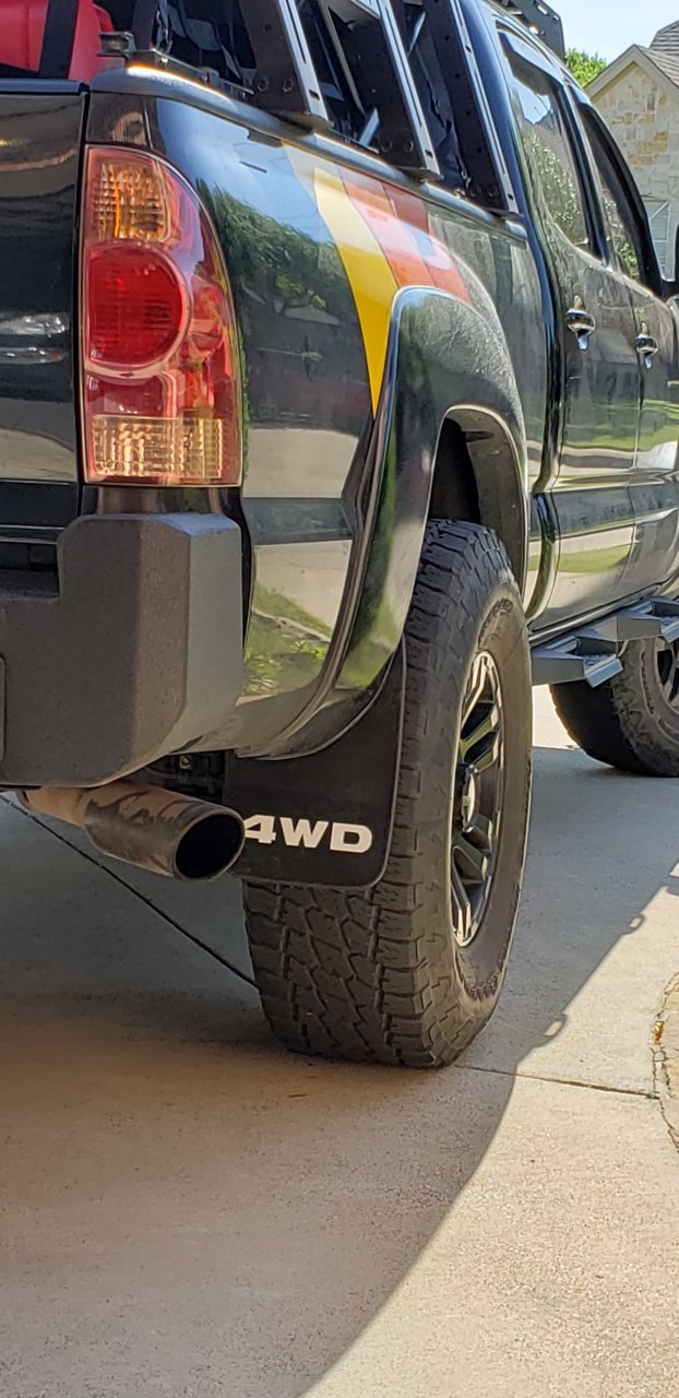

    A few holes lined up with the fender, I drilled some extras on the flaps. One bolt on the inner hole since the 1st gen flaps are not shaped like our 2nd gens so a connector wouldn't hold it securely enough. I really like them since they are flexible and much shorter versus the 2nd gen flaps. Got them on TW from a 1st gen member.
