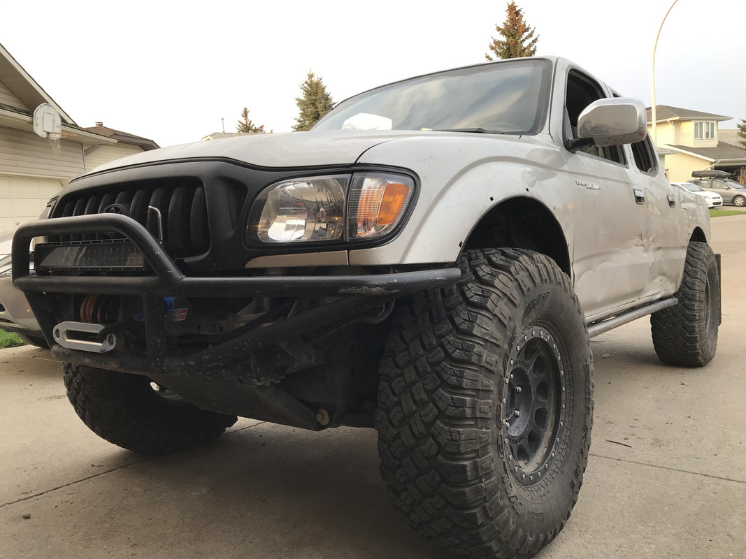

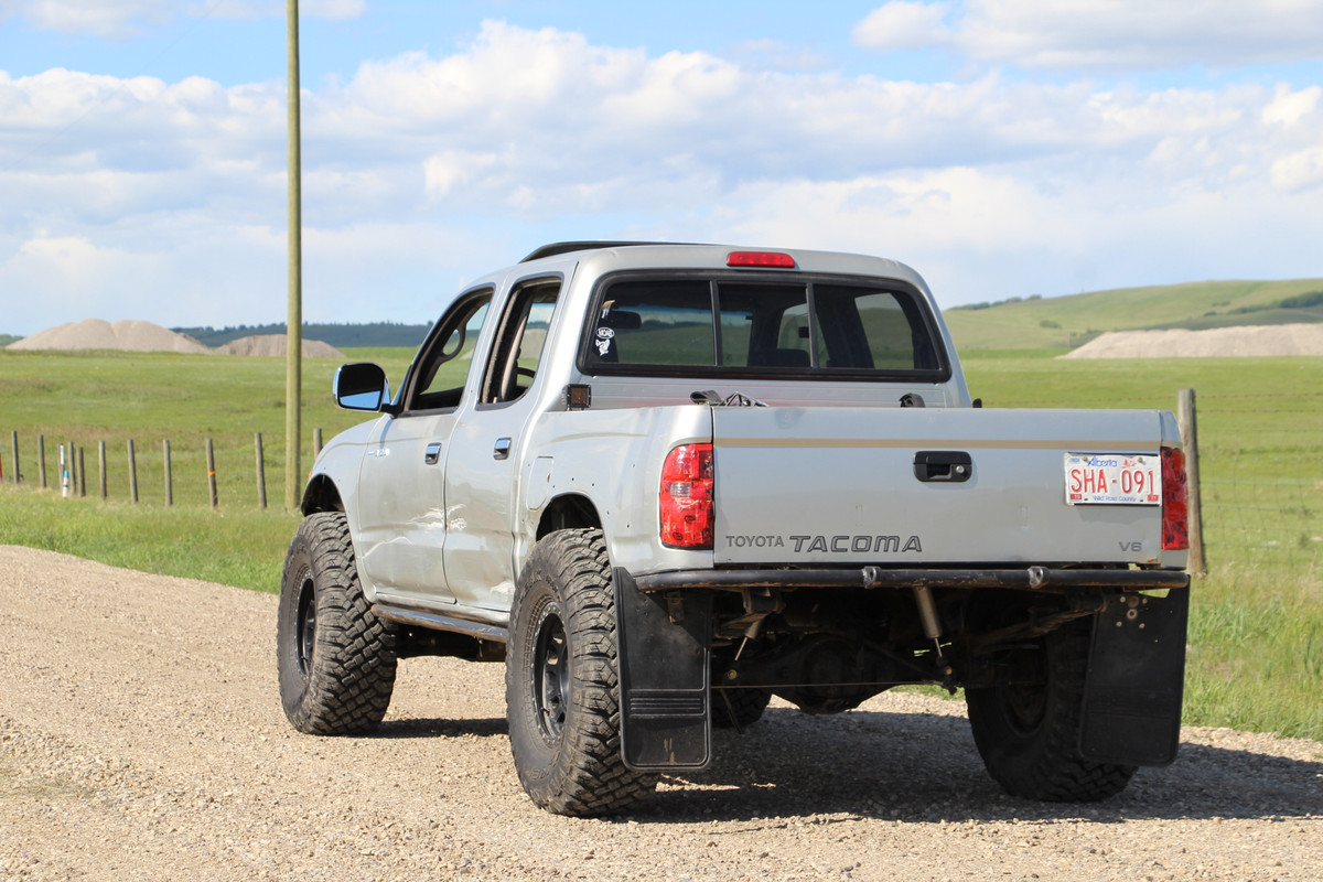

    I did no lift 35s
    my boy tanner in the red access cab did the same
    cruiserguy and Fernando[QUOTED] like this.

    there may be others, but I had 35s no lift
    to be fair I did have bulletin 5100 front shocks set to the 3rd notch to compensate for the bumper and winch.
    An3, cruiserguy and Das it mang like this.

    how did you mount those ditch lights on your truck bed?

    Yeah, you can tell you're still pretty close to stock height tho. Your LCAs are still pretty flat.
    You have a build thread? Me likey.
