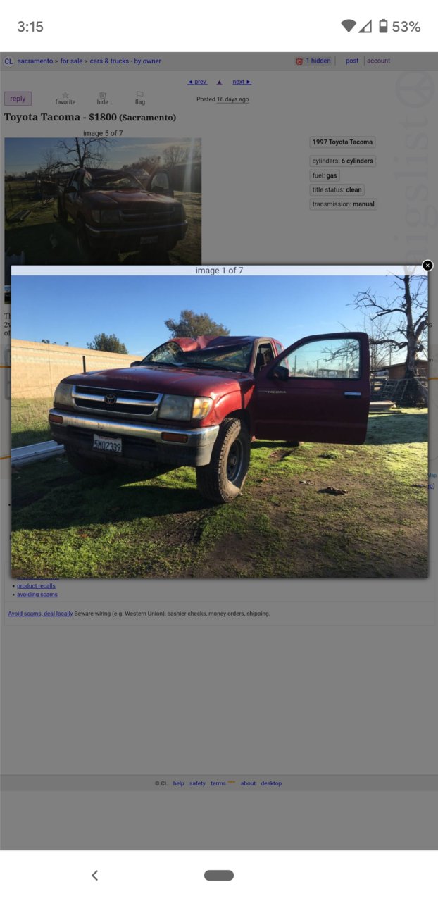

    So I found this 5 lug V6 manuel trans. With cab damage. If I get it for less than $1,000 is it worth the time swapping the cab? I already have another 97 cab. I think it would make a fun fast little street truck.

    is the damage just on the top?

    Yes, other then some fender dents. I'll swap on some 4x4 fenders any way make it look like a s-runner

    It's hard to tell from the pic, but can you just cut the top off the cab where the cowl and A-pillars meet, and then swap the top from the other truck? Are the A-pillars bent down below the belt line, preventing door alignment if you only do the top?
    Either way you end up with one cab that is scrap.

    Not sure how far down the damage is. But I think I'd just cut the old cab off. I know my spare cab is in great shape. Mite as well just go with what I know is good. The only thing I think I need to buy is a new front window.

    Since you are looking for opinons here - here's mine. If the frame is not rusted out, it would probably be fine going down the road with a new cab. My truck had a similar looking accident. Black ice...... Cab was crushed. No body shop would fix it... Found a used cab, put it on and it has been great. Goes down the road just fine ..... Check the frame with diagonal measurements to check for damage.
