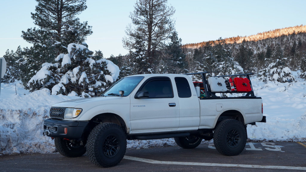

  16. Feb 16, 2025 at 1:13 PM
    #16
    Javi's Taco
    Javi's Taco [OP] Active Member
    Dec 6, 2024
    #461871
    34
    DSC09136.jpgHere she is.
    Exterior and interior, she's great.
    Flawless frame, no rust.
    Almost everything has been replaced.
    OME suspension with Icon Delta Joints.
    Even the transmission was replaced 20K miles ago with a 60K used transmission at a Toyota dealership.
    I have two newer cars so I don't mind investing money into this truck, it's been quite a hobby.
    I've done everything so far and this job would be the first thing that I outsource.
    But don't get me wrong, if it's truly not needed, who wouldn't want to save 3K. But if it prevents issues in the future, I don't mind spending it.
    I'm only trying to learn from all of you and decide on whether it's necessary or not.
    BabyBilly likes this.
