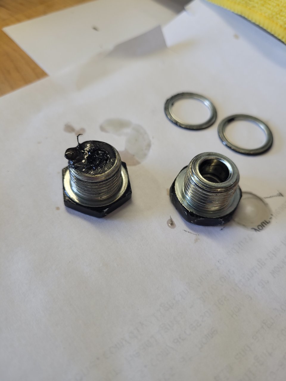

    I just changed my Front and Rear diff oil at 15K miles which I believe is severe duty and replaced it with the Valvoline 75W-90 Full Synthetic Gear Oil in the squeeze packs.
    After seeing a few folks struggle with removing the plugs in the front diff after they had been there awhile, I wanted to minimize the chance of stuck plugs. Mine broke free without issue... I had sprayed over them with RP-342 Cosmoline when the truck was new to seal of gaps and joints to prevent corrosion in the threads.
    I found some metal debris on the rear diff that looked like more like machining shavings that were not flushed out of the casting when manufactured more so than a wear issue.
    The front diff had a small amount of ferritic sludge which could be minor break-in wear or less than clean castings when assembled.
    I deal with dirty castings on a daily basis in a manufacturing environment, so the appearance of the shavings and sludge was not surprising. It can be quite difficult to completely flush castings and make the machined surfaces "clean".
    I've done some light off-roading, fishing holes, primitive camping and deep snow with the need for the rear locker a couple of times. Nothing severe and the 30k schedule would probably be more sufficient.

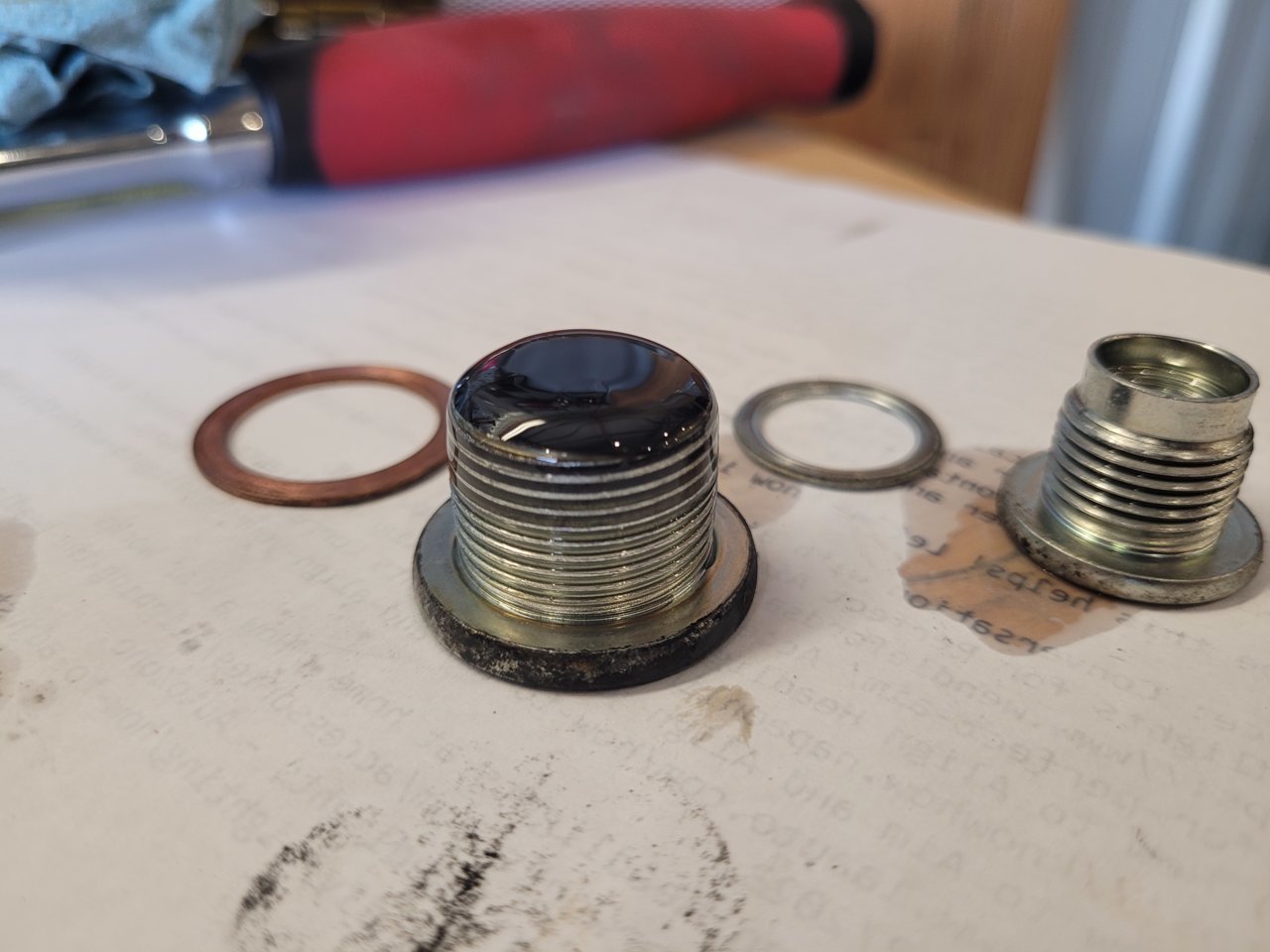

    I do it every 3-4 oil changes or 18-24 months, I don't drive the truck enough to go by mileage on anything but I do have big tires, stock gears, and a lead foot. Been running Redline full synthetic 75W-85 and there's definitely gunk on the plug, which may be completely normal for all I know - but no blatant shavings or bits of concern that I can see. After reading ECGS feedback (someone posted it here, link on their website) I just swapped over to Lucas 85W-140 dino (half the price, allegedly better protection). No difference in "feel" compared to Redline and I never had a whine so I can't speak to that. I have a sample of the used Redline to send for analysis. I'll take a sample of the Lucas when it comes time and compare the two results.
    Redline 75W-85 after 18 months:
    At the end of the day, if you're actually taking the time to refresh your diff fluid, even on the "regular duty" schedule, you're probably doing more than the average bear, so high five.

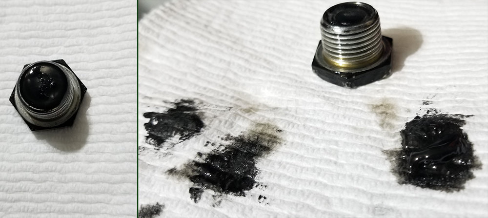

    Some Serious Tires
    FWIW I did my diffs at 18k miles. Rear looked like new and front looked disgusting black color with tiny metal speckles.
    Used redline fluid.
