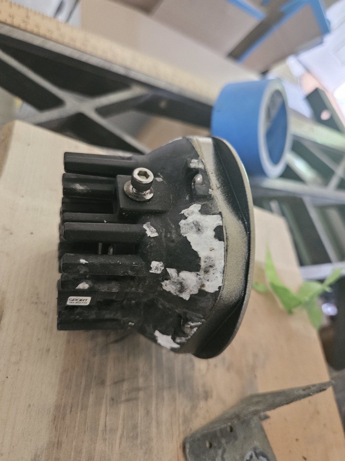

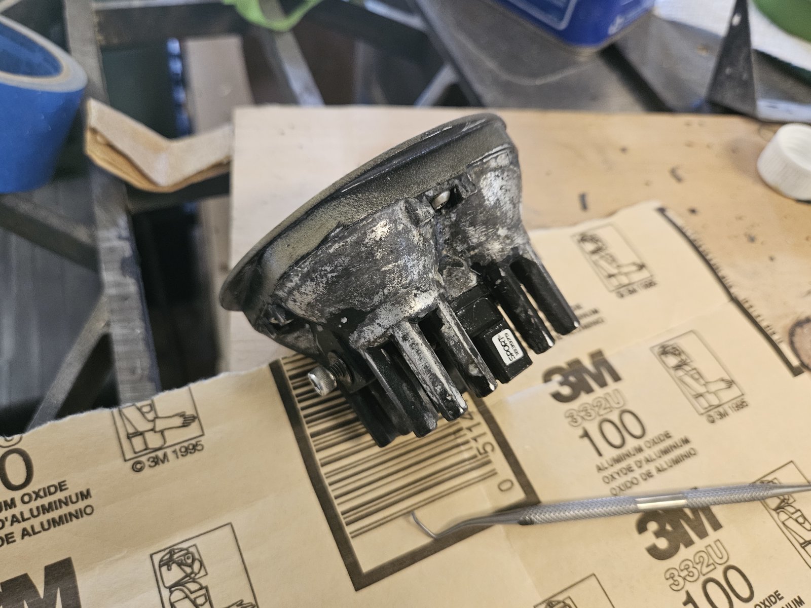

    A picture is worth a thousand words, so I'm gonna throw these up. I pulled the masking tape this morning off the bodies and chunks of powder came with. After some time with sandpaper, a dental scraper, and a wire brush, you can see exactly what I'm talking about with powder failure.
    This isn't to say DD's powder sucks, it's to point out that they continue to do the important part - make good light- even after years in an environment that literally eats aluminum. These got cleaned, degreased, and a couple coats of rattlecan after verifying that the gold on the bezels was cured enough to stand green tape.

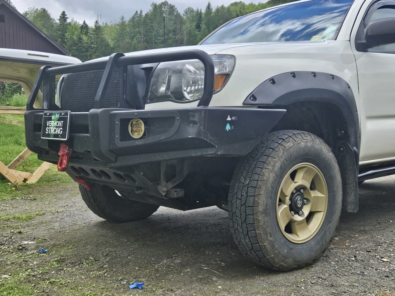

    Strapped in and good to go. Same hammered gold as my summer wheels.
