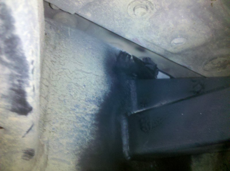

    Heres a closeup of my Stubbs SKO-HD's just after they were welded on. Hope it helps...

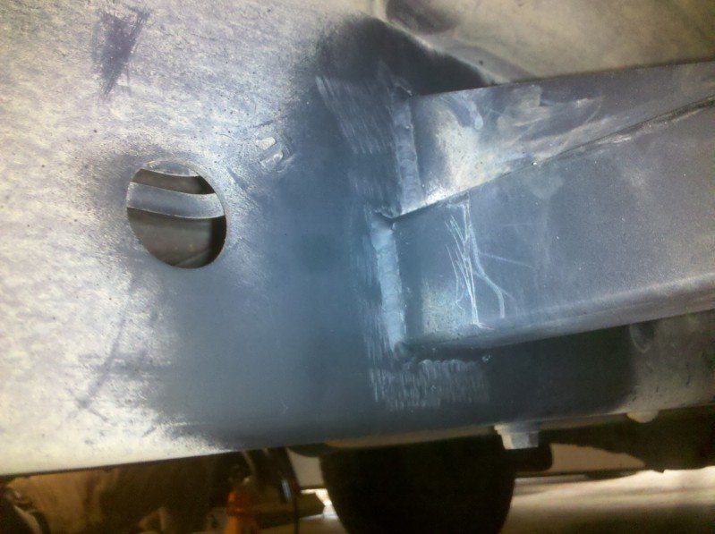

    Glad you asked for this...looks like i need to put a little fresh paint in one small little spot...

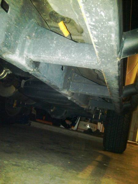

    Here's another...I know what I'm doing next weekend...

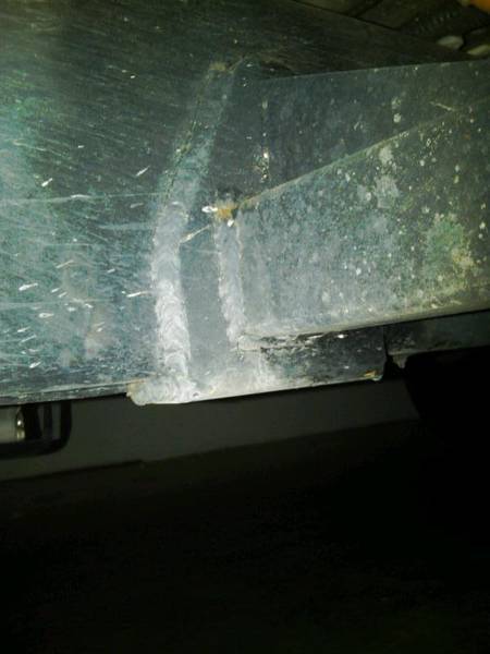

    FWIW, these were welded on by the same guy who welded 'em together, and I wouldn't have it any other way.

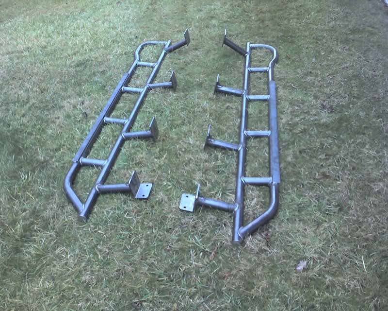

    I decided to cut my square plates to add some angles/strength (as opposed to mounting with a diamond orientation). To allow ample clearance for the pinch weld, you can see how close the leg needs to be to the edge of the plate.
    Also measured and marked the sliders and prepped them for paint.
