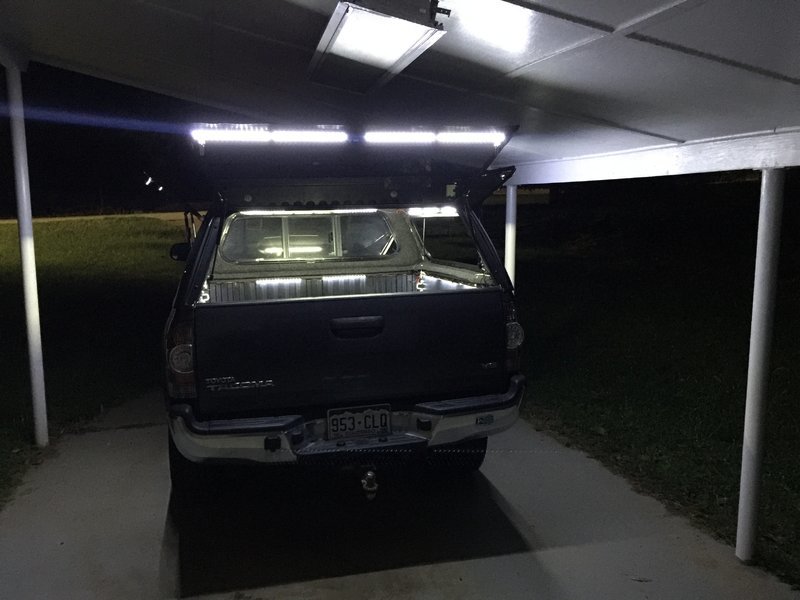

    I will order some of those lights! they are bright

    Keep in mind, I did use 26 of them.

    Yes I saw on your post from show me your shell thread that you use 26 and it draws small amount of amps :thumbsup:

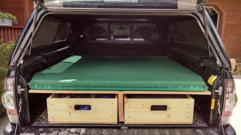

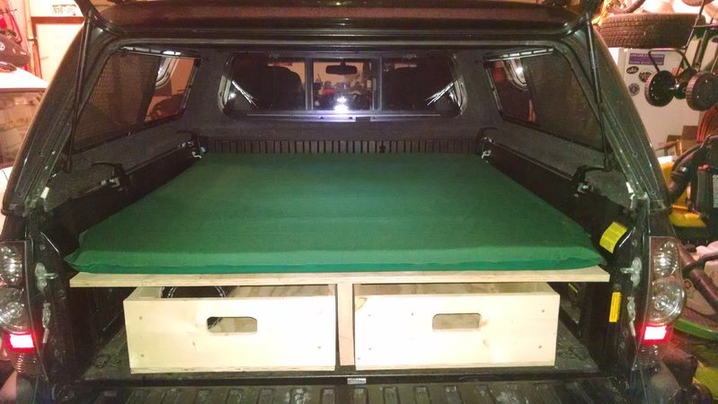

    I wanted a camper that was ready to go whenever needed. I built this last winter, and couldn't be happier!
    My Tacoma is a 2013 TRD Sport 4x4, with a 5' bed and an A.R.E. topper.
    I used one 5' 2x10 as a standing brace for the bed with two 2x8 as the cross braces for the bed. I countersunk the 2x8's into the standing 2x10. The sleeping platform and the bottoms of the drawers are grade A, 3/4" plywood to prevent slivers and water damage. The sides of the drawers are pine. There are no rollers under the drawers, they move fine without them. I had the sleeping pad custom made by a company called, solacejh.com. The sleeping pad is 3 inches of foam, and inflatable.. Super comfortable! The pad is covered in PVC and is highly damage and water proof. I installed 2 LED battery powered lights to the front and back, and screwed them into the metal frame of the windowsills. I put in cafe curtain rods on all windows except the tailgate. I attached these directly to the existing screws on the windows of the topper. Black valence curtains worked great, and a few Velcro bands can tie them back while driving.

    That's sweet! Great job!

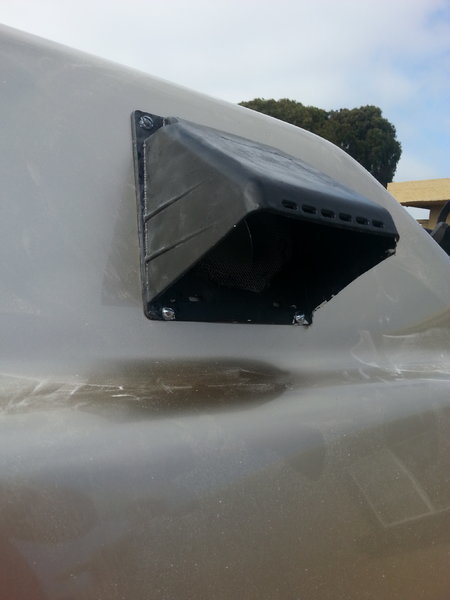

    Pvc platform with a twin mattress on top, 24 inch led strip, and dryer vent/fan combo

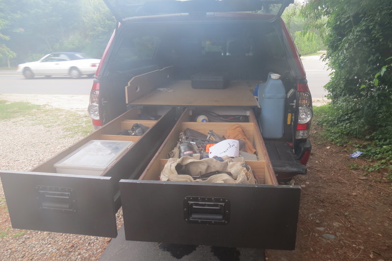

    Enough stuff to go camping for three days without seeing another person.

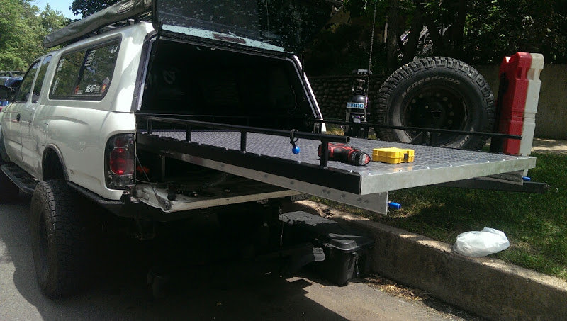

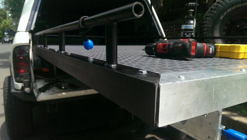

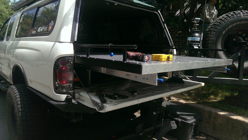

    OOOHH how did you make the giant slide out drawer? I've been looking for something cool other than bearings and square metal tube
