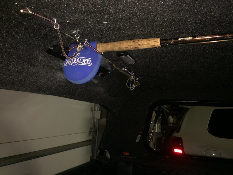

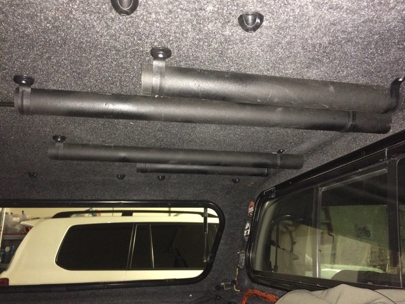

    Yes. I carry my fly rods in them. I can reel my fly to the top guide, break the rod in half, secure the tip to the butt with a neoprene reel cover and then insert into the PVC tube and hang the reel end in a bungee set up that you can't see at the rear. I put my 8' or less rods in the long tubes and my 9 & 10' nymphing rods in the short tubes. That's probably not very clear - I can take a better pic if you'd like to duplicate it. I've wheeled all over the San Juans with rods in there and have had zero issues.

    I'll take some pics this eve. I have the reinforced roof and used U shaped pipe clamps with some short self tapping screws. I painted the PVC and hardware with rustoleum truck bed coating prior to install.
    Edit: I have the carpet liner in my shell and also ran some Velcro on top of the tubes.

    Here's some pics.IMG_3649.jpg IMG_3648.jpg IMG_3647.jpg IMG_3650.jpg I shimmed the back end of the tubes down with washers to compensate for the curvature of the roof. The reel end is two eye bolts with a small bungee cord crimped to one and ran through the eye of the other. I put the captive side around the back end of the reel and stretch the other end around the front and hook it such that the bungee goes completely around the foot of the reel.

    No. They are 1/4 or 3/8" screws that don't penetrate the exterior of the shell. I have the reinforced roof. I doubt you could do that otherwise.
