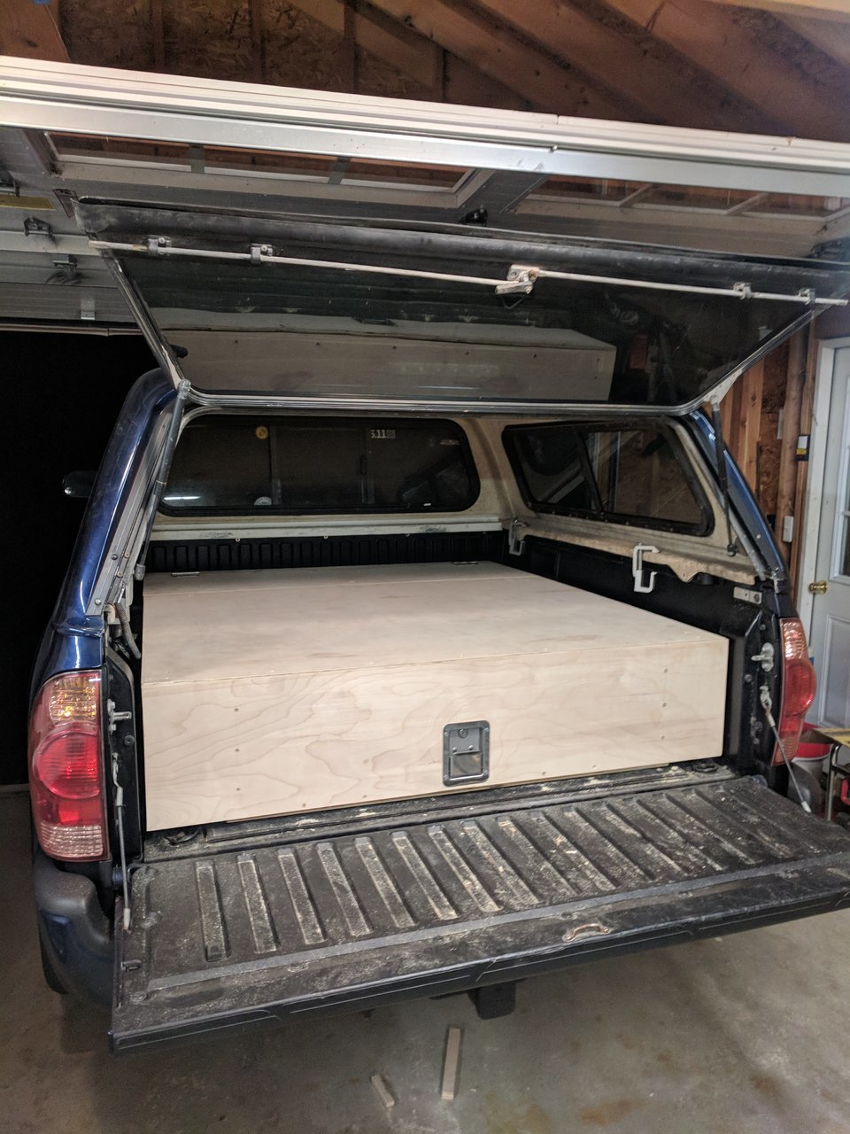

    Nothing Fancy, Just some protection for the fridge from my dogs. The fridge now slides out on a home-made unit. I need a re-design.

    How do you have the plywood secured to the bed?

    It is cut fit pretty precisely, and 3/4 ply strips prevent it from sliding in any direction. With the tailgate closed it doesn't budge, and it's heavy enough alone to hold the weight of a packed fridge when fully extended on the slide. (That was just dumb luck, I didn't want to drill holes in the bed).

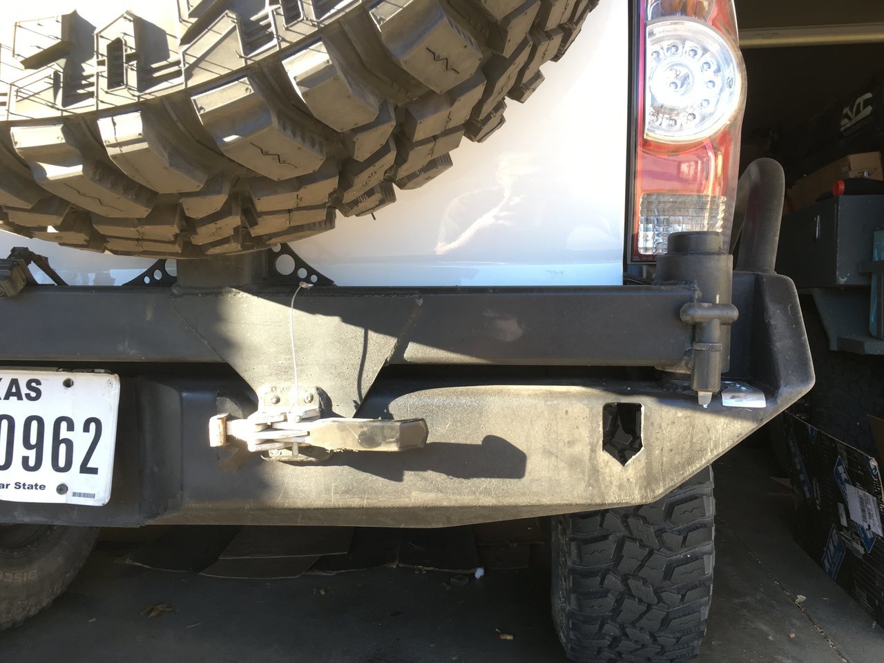

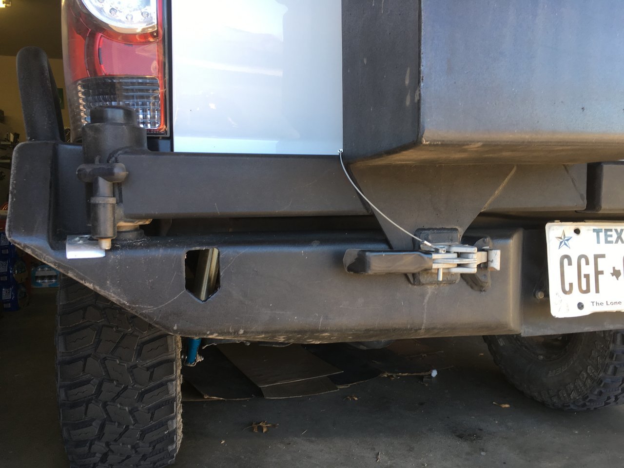

    @PHTaco, very nice setup.
    I am currently building dual swingouts for my bumper, and will be similar to yours. Would you mind posting a close-up picture of one of the latches, where the swingout locks to the bumper. I have an idea as to what I am going to do, and yours looks very similar.

    Here you go. If I was starting over, I would orient the latches vertically with the handle pointing up for clearance reasons. I scraped part of one of the handle covers off last time I was in Moab. A harder hit could have rendered my swingout un-latchable.

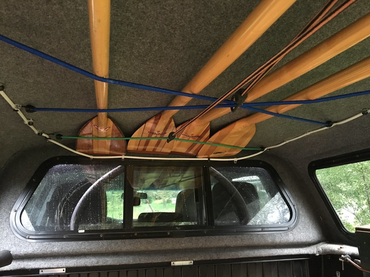

    I go through various organizational methods from a shelf at bed rail height in the front to full platform above the wheel wells. The problem is that it seems like it all has to come out so often for firewood/mulch/stone/lumber hauling, etc. And skiing, hiking, biking setups all seem to be a little different. Great ideas on here, thanks everyone. It's great to see what folks have done. This is just simple bungees off my led mounts to keep delicate paddles out of sliding gear danger.IMG_0747.jpgIMG_0746.jpg
